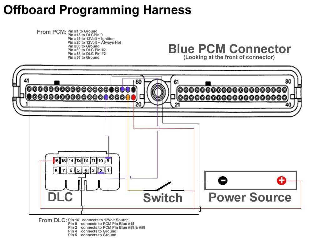

Old May 25, 2025 | 09:31 PM
Originally Posted by Henderson21
Do you mind me asking which Pins you used to do the power up test?
So I built a PCM bench harness for flashing PCMs. I just followed this information and it works perfectly.
Old May 25, 2025 | 10:15 PM
Henderson21's Avatar
Joined: Jun 2013
Posts: 84
From: Ontario Canada
This would have been handy in the other thread I had asking about PCM bench testing. Lol.
I did a follow up post explaining this diagram.
It's the same as the LS1 PCM harness.
That being said, if your interested in bench testing gauge clusters. Check out the pin out above your post in this thread.
