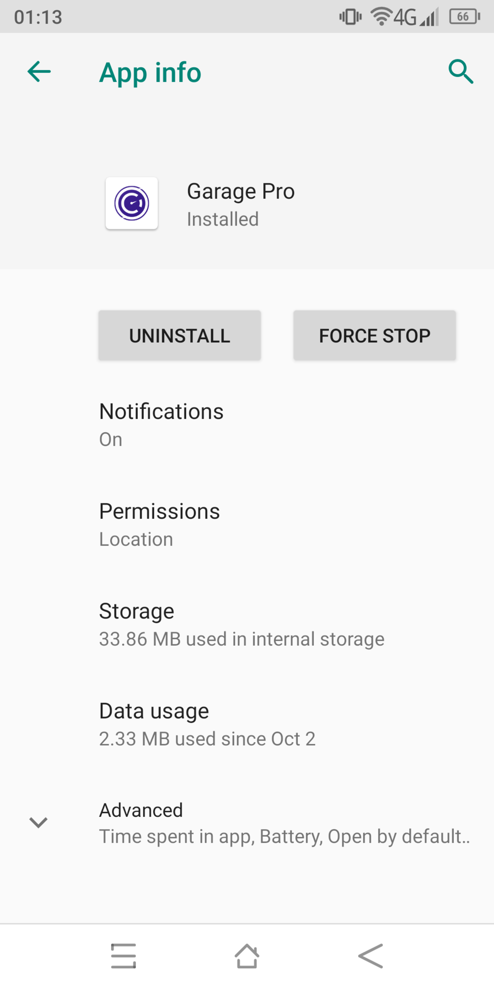

Just tried this app thats free and actually will read the abs codes on my 6th gen montes, wont clear them without buying it. Just saved me alot of time.

I have torque pro too but it wont read ABS
