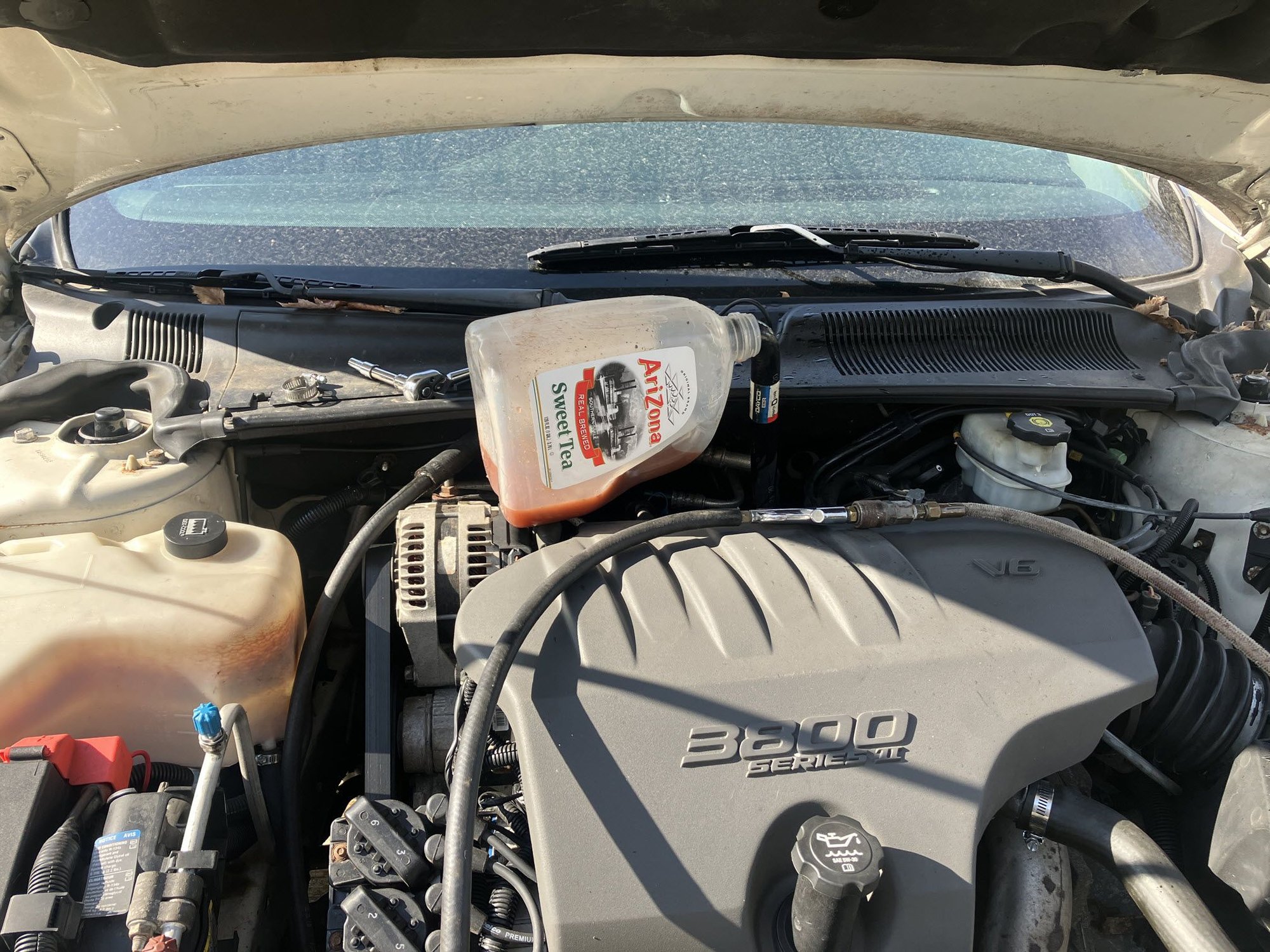

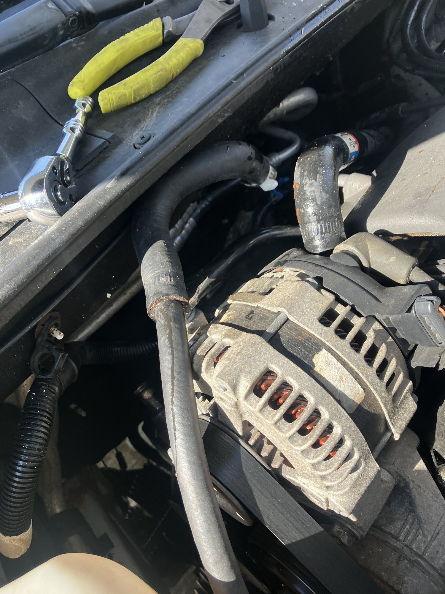

SO, not Monte related, but 3800 related. My mom's 2005 LeSabre had NO HEAT. Earlier this year I replaced the heater hoses and radiator hoses (all original). I did not know until recently it had no heat. When I learned of this, I found one hose would be hot and the other not hot at all! Seemed pretty clear this is a clogged heater core. I suspect the old hoses were coming apart on the inside and building up crud in the veins of the core.

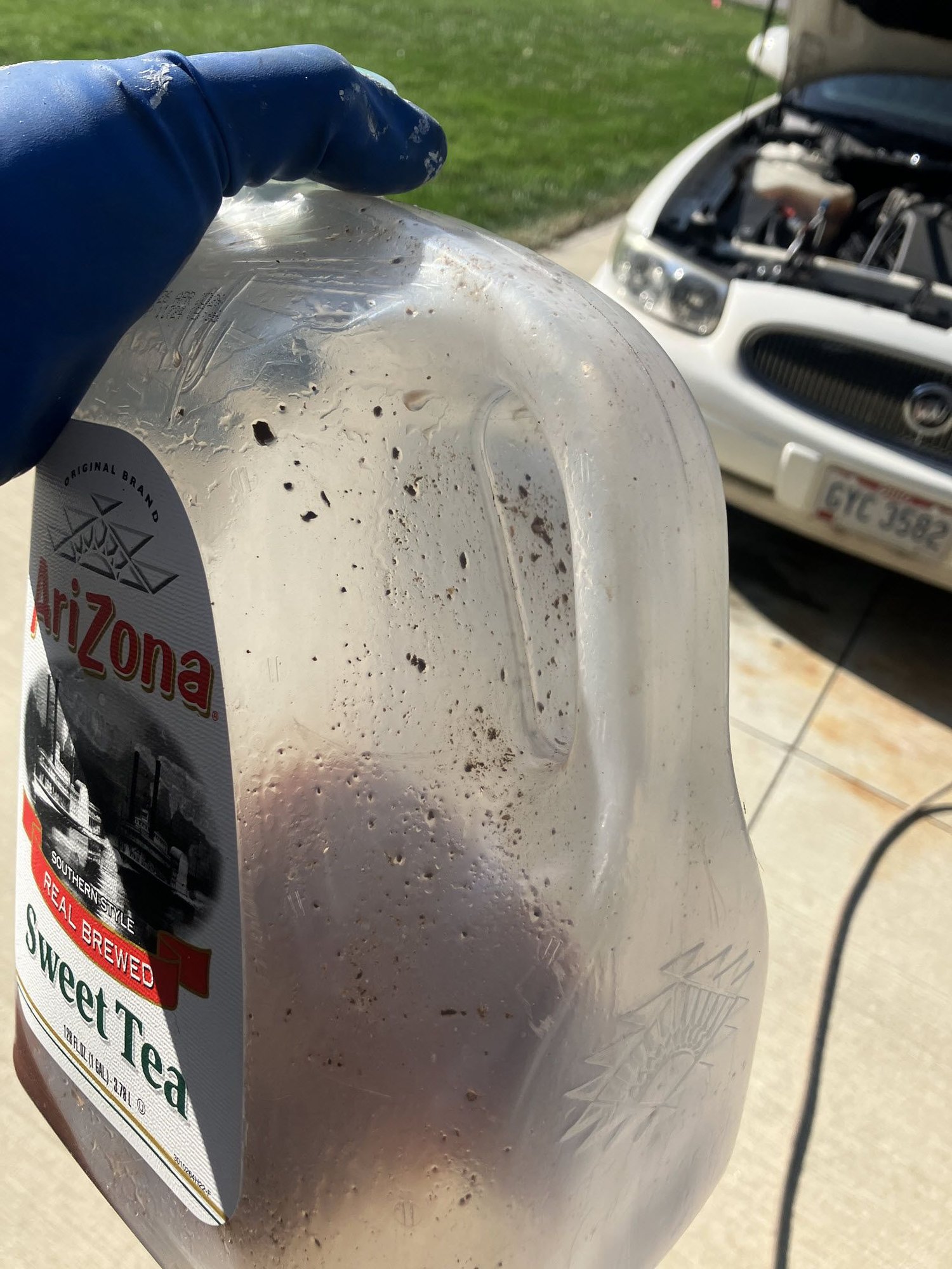

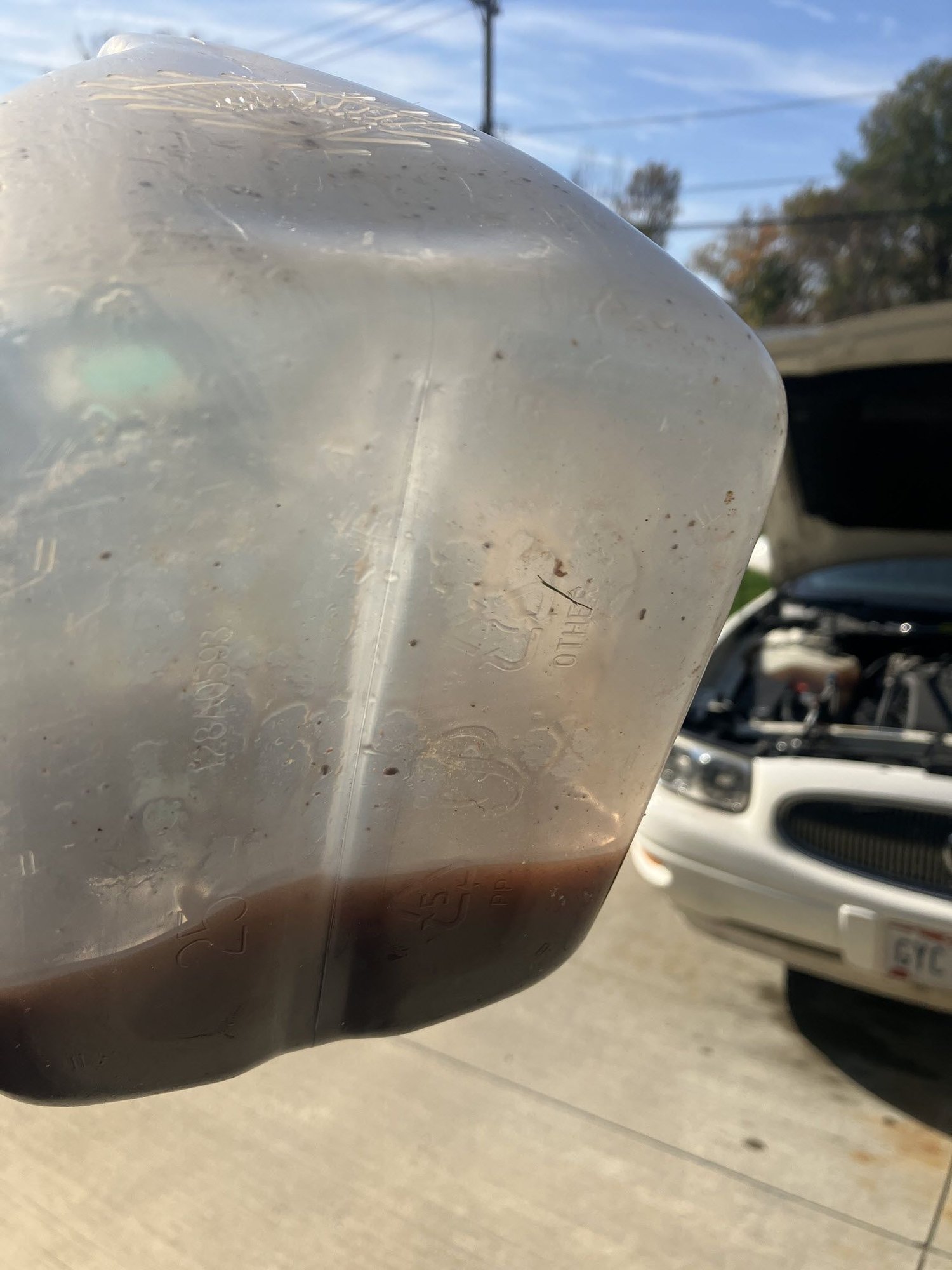

I tried something and it seems to have worked. I pulled the heater hoses off. The bigger of the two (which was the one that got hot), put the end into an empty bottle to catch stuff. The other one, I wanted to send compressed air into (water was my second choice). I did not have a way to go straight into the hose with the air nozzles I have so it would build pressure. I took a spare hose, sleeved it inside the heater hose. First time I sent air in, it blew my sleeve out. So, next step, I reconnected, held the connection and sent air in. It blew a bunch of junk out! It pushed the coolant out and black flakes. Now no issues moving air. Put the hoses back on, topped the coolant and heat works PERFECTLY.
