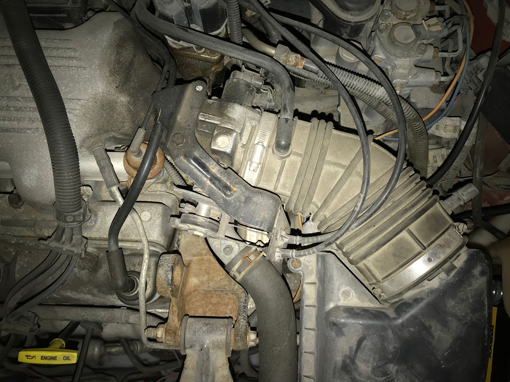

So, in the process of diagnosing the miss my engine has, I am replacing the map sensor, tps sensor, iac valve, egr valve, and was gonna replace the maf sensor, but I see no maf sensor. I know the motor was a replacement a couple years ago. Was there a few years in the mid-90’s where there was no maf sensor? I cannot find the plug if there is supposed to be one, but I am replacing the factory air box with a CAI here soon. Just curious if what I am seeing is correct or not. Thanks in advance.

Old Jan 7, 2018 | 06:47 PM
95TankMonte's Avatar
Joined: Jan 2018
Posts: 10
From: Berne, Indiana
Old Jan 7, 2018 | 06:58 PM
That engine does not use a MAF. I believe part of the reason is it is prior to ODB-II. That same 3100 in the 95 Monte was used on the 94/95 Grand Am, no MAF. The sensor in the air intake tube is a temp sensor.

Here is what I can tell ya. My motor was replaced a couple years ago. Not sure what vehicle the donor motor was out of. I even went on autozone website and it lists a maf sensor for the Monte. I am wondering if I have a 94 or slightly older motor in it.
Old Jan 7, 2018 | 08:58 PM
user 35764368's Avatar
Joined: Apr 2016
Posts: 205
it must use speed density system
