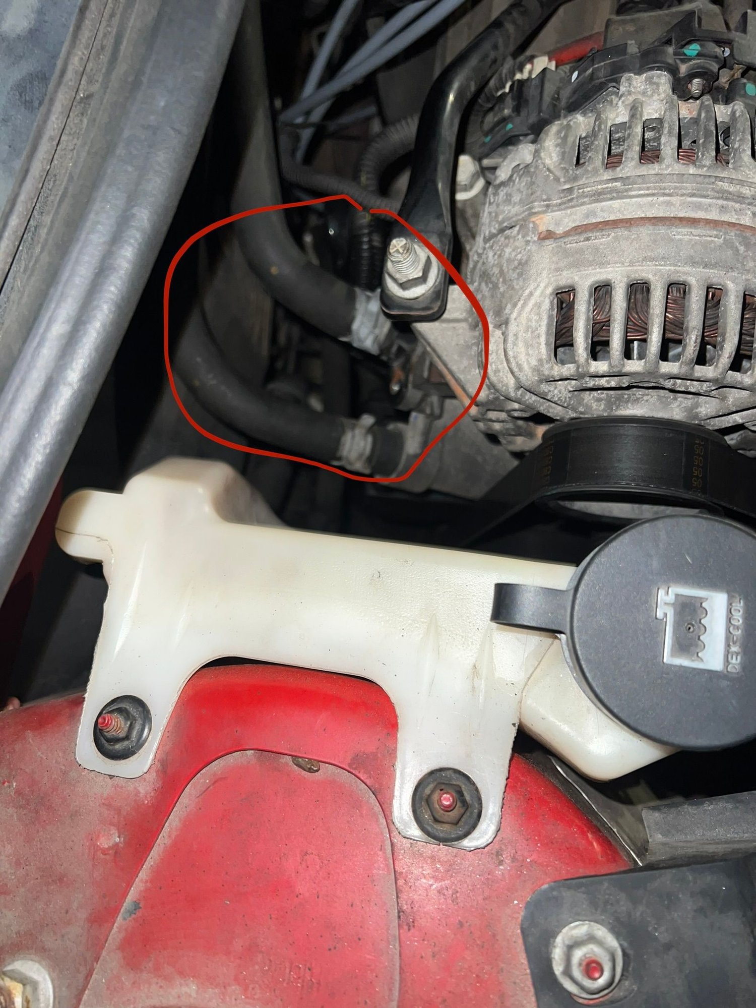

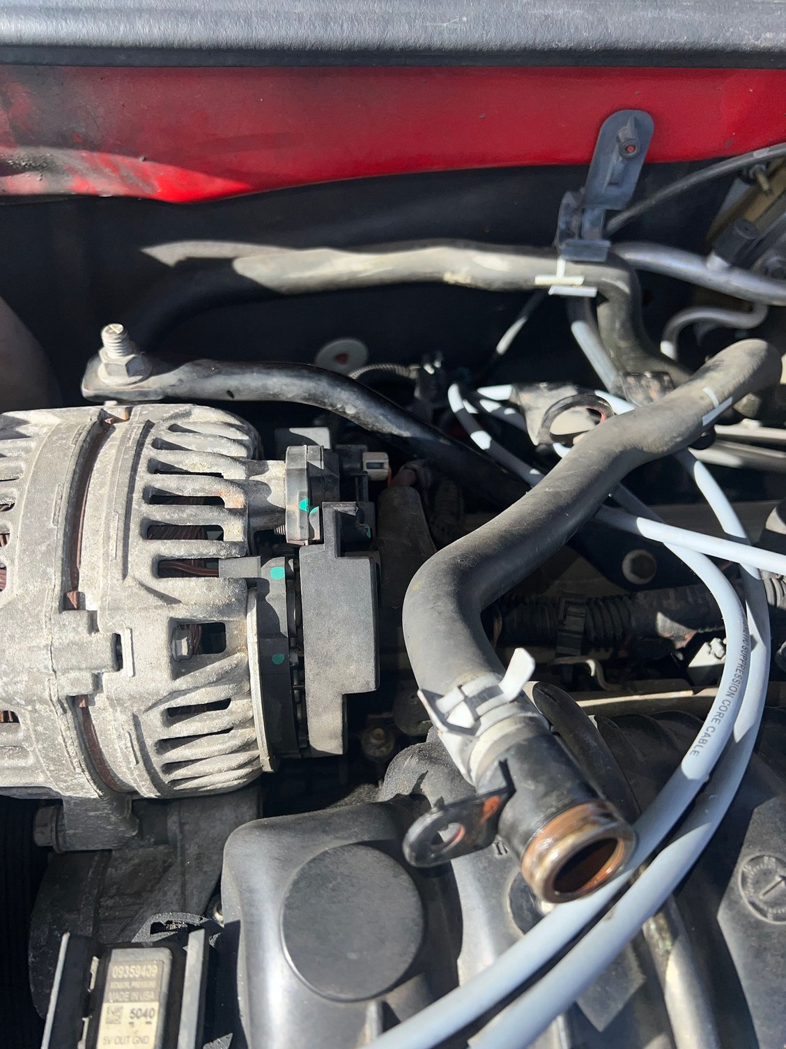

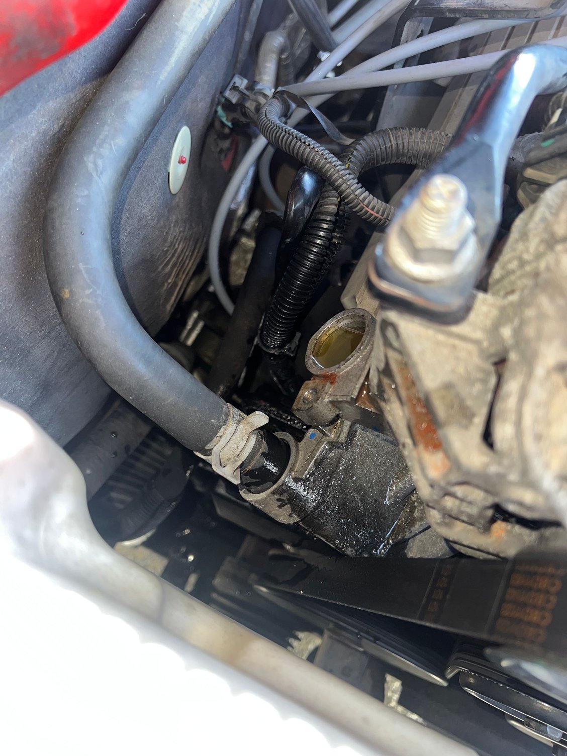

Hi everybody,
Sorry if this is a dumb question I’m very inexperienced with auto repair.
Had to unplug this hose when I replaced my spark plugs due to a misfire. Plugged it back in and bolt snapped. Had to run the engine with friend holding hose in to make sure I cleared the misfire and some fluid leaked out.
Pretty sure it’s a heater hose but when I look the part up it doesn’t look similar. Fluid is yellow and I’m assuming antifreeze? When I fix it I should only need to refill the antifreeze correct?
Sorry again for the dumb question

Posts: 4,160
Yea its the hoses for the heater core. Youll need to make sure theres not air in the system after you refill it. If its only the bolt that snapped, take the pieces to the hardware store and they can match it up for a few dollars.
