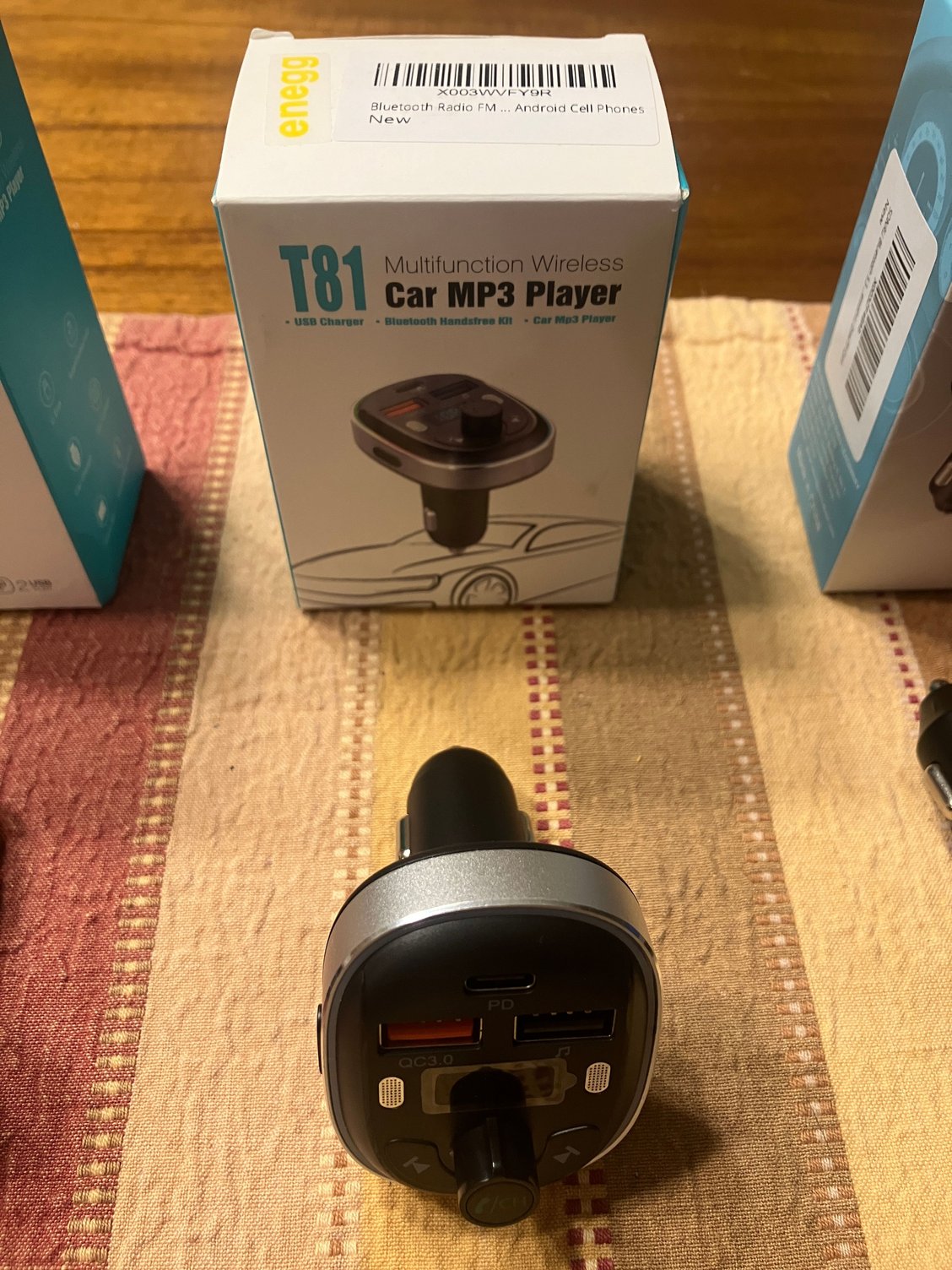

I sorta blame @ChibiBlackSheep for introducing me to a VERY old version of this idea. Basically, the ability to pair your phone to a device that plugs into your car's cigarette lighter/power port, it will then transmit on FM to your radio (for audio streaming and hands free calling). This is handy for people who don't want to upgrade their car radio (such as, I want to keep the appearance of a factory radio). Another friend was recently talking about these and I decided to hop on Amazon and pick up 4 different ones to sample! This is NOT a fully comprehensive review. I am just reviewing some items of interest (and in some cases an item does not pass a priority check and I did not spend more time on it).
No idea of the brand names attached to these, but I am looking at from left to right T25, T81, Sonru BC80 and the T85M. All units are under $20. You cannot upgrade the car stereo for $20.

T81 - My second dual mic test device. My test caller reported that it had much better sound quality from the previous two! No echoing of his words and I did not sound as distant. This was a success. I wanted to try all units that supported music on MicroSD, the T81 claimed on the Amazon page to have this feature but it did not per the package and the the device lacks the slot for it. I admit, I have not tested music on USB yet (not sure if I will or not). Easy to set up and easy navigation buttons. It has a couple LED light mods that are really lack luster (basically a multi-color display or non lights). Audio from my phone sounded good. No power button or power off function, must unplug.

So far, I am a bit torn between the T81 and T25 units. I think the biggest issue is the T81 lacks SD Card support and the T25 lacks the option to turn off the LEDs. I want to do a little more quality testing (such as validate that the audio play back is true stereo, something like Bohemian Rhapsody is good to help prove that). And just get a little more time with the two units.
