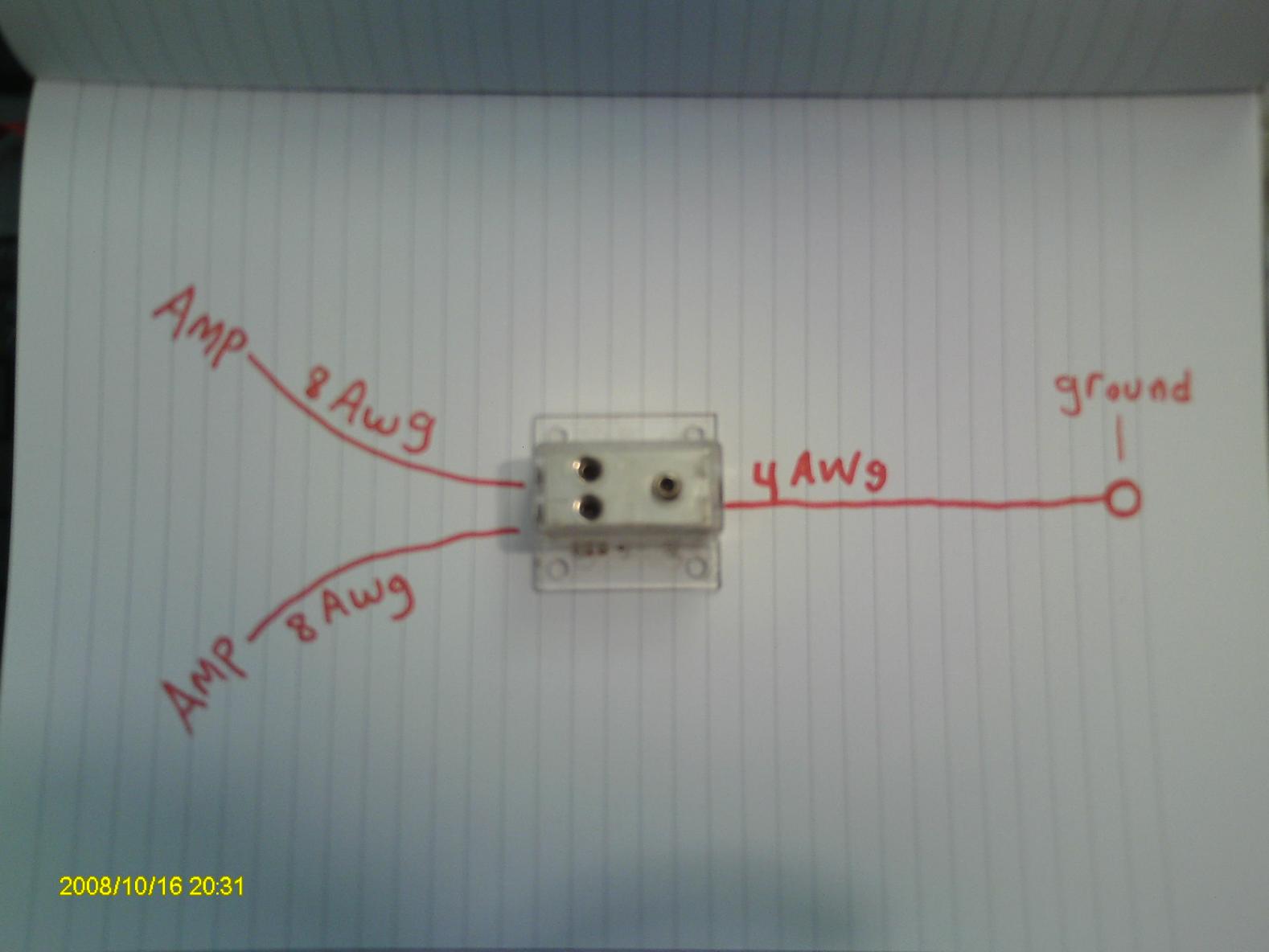

You say you need to run seperate grounds from each amp. Would'nt this setup also work? It is what I have always used when wiring two amps. I may be absolutly wrong about this, but I think this is a good idea.
Attachment 2867
not sure what the picture is, but you should have 1 ground from each amp, but they can come to a single wire into the chassis, but that single wire will have to be bigger than each ground wire from the amp (not in length but in gauge)
Attachment 2867
ok i see it now, yeah thatd work find because the inlets are smaller than the outlet, i didnt realize how big of a mess my amps are...im embarrassed now lol but you get the picture kind of

What do you mean you dont know what the pic is? Did it not show up or do you not understand?? Its a drawing (kinda) of the setup I have always used. It is a 4 gauge wire going to a splitter box then two eight gauge wires going to the amps (one 8 gauge for each amp.
