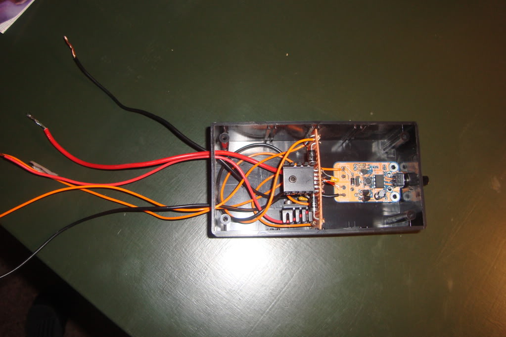

Update:
I got my parts to finish the blinker circuit. I also added some heat sinks on the voltage regulators. Here it is before I sealed the box back up.
I wired the boxes up in the car and it works great Two bottom strips for running lights, and the upper section for brake/blinker. Pics and a video of them working soon
