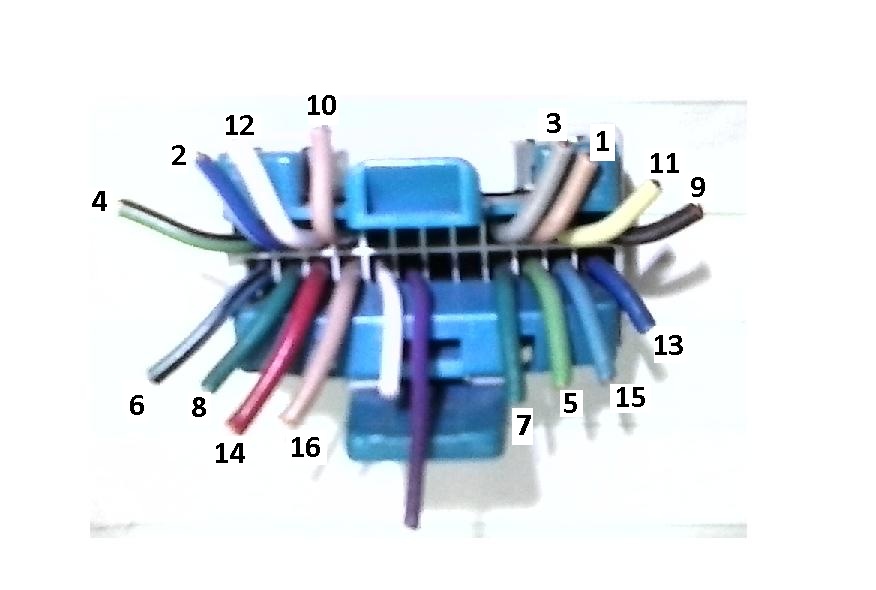

That's exactly what I was thinking about doing. Thank You for the reinforcement of that idea. I know they make relocation kits but that seems a waste of money so I'm using some extra CAT-5 cable I used to wire my home. I have an old stand alone speaker that was used for a monitor that I can stick under the driver side dash. I suppose I can tap off the RAP relay output leg for that function and just run separate leads for everything else directly from the fuse block like an old school install. I hate it has to be so complicated but I just do not want to lose my ON star and alter the original functions.
I did however (after an exhaustive search) find the CORRECT jumper sequence to bypass the factory amp. Just connect 1 to 2, 3 to 4, 5 to 6, etc. It works perfectly with all the correct speaker phasing and locations. I really hope this helps someone in the future. Google search freaking sucks now. It is NOT what it used to be.
