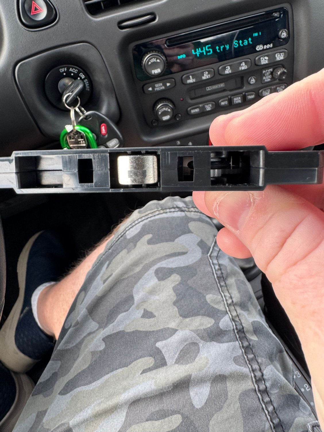

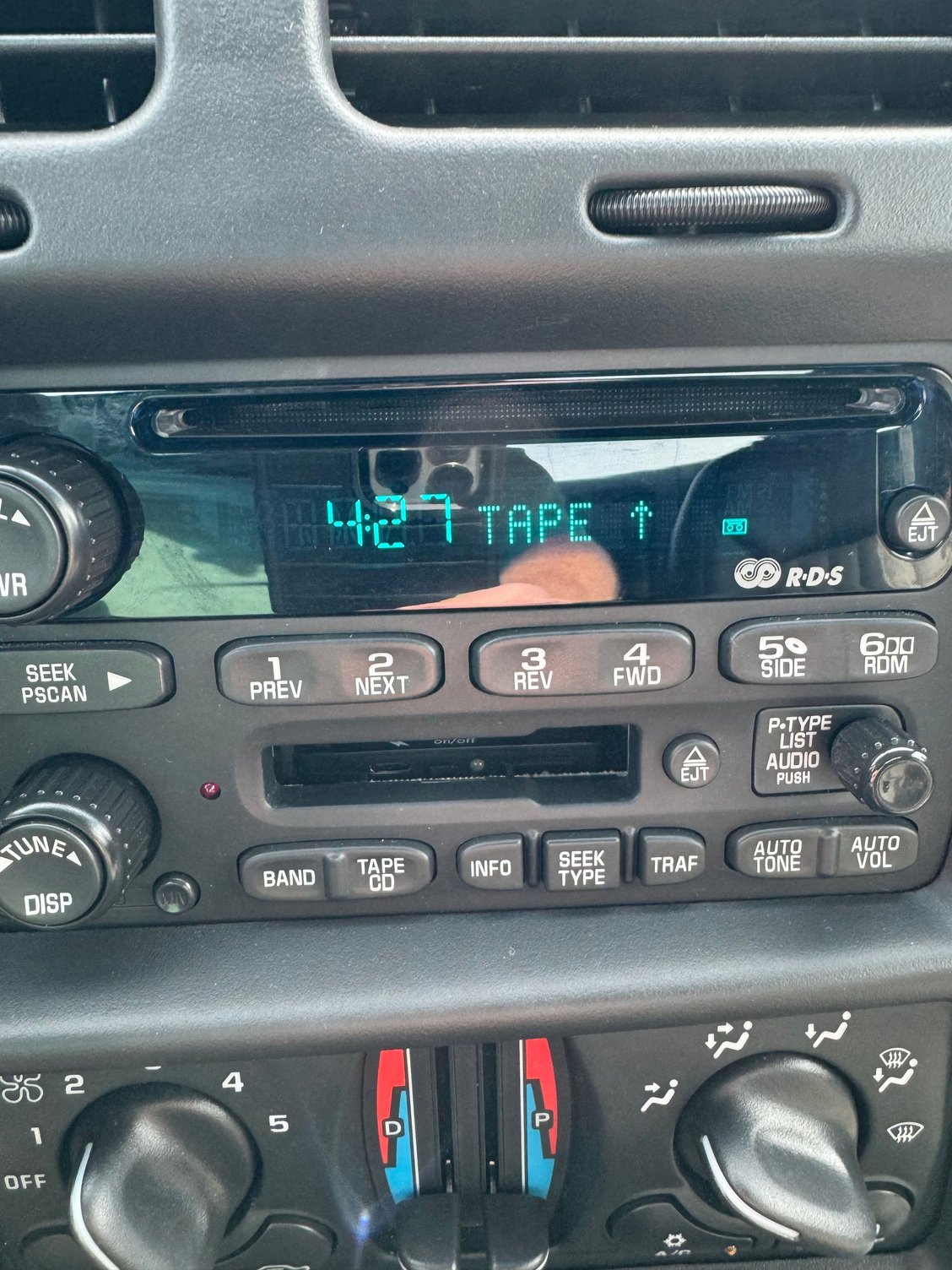

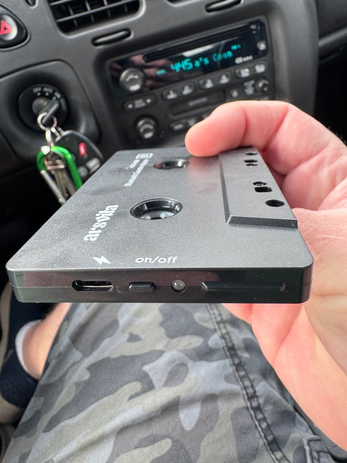

Since my radio has a tape deck and CD I bought this cassette adapter from amazon for $20 and it's bluetooth. It actually sounds great and no humming and I can stream my XMRadio from my phone app. I should have got the one with the microphone so I could make a phone call thru the radio speakers.

I have experimented with the cigarette light adapters that broadcast to FM. Most have great sound (just have to verify it is real stereo). Some of the ones had bad phone quality in the car. But almost all if not all had bad quality for the person on the other end of the call. So I limit these to just audio (not hands free calling).
