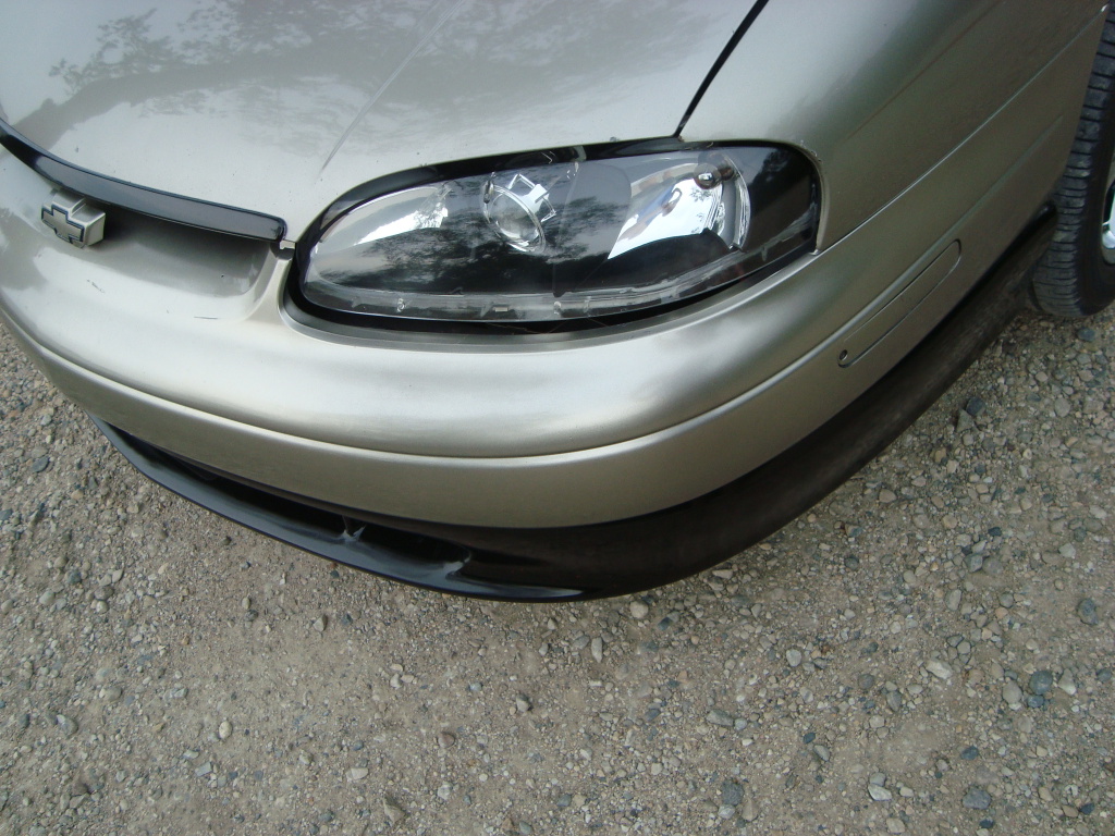

I'm pretty sure putting a projector behind a frosted lens defeats the purpose of both the projector and the frosted lens.
If you want to do a retrofit, get a set of clear housings that are made for this car. They make a great base for the morimoto minis

looks great Justin. Ive searched the web and found the clear headlights lens for the car. Just didn't want to spend any $ since I have these brand new (frosted or whatever headlights) also further checking on the clear lens ive seen quite a few retros and most all of them do not fit the entire space for the headlight, kind of don't want that look.
