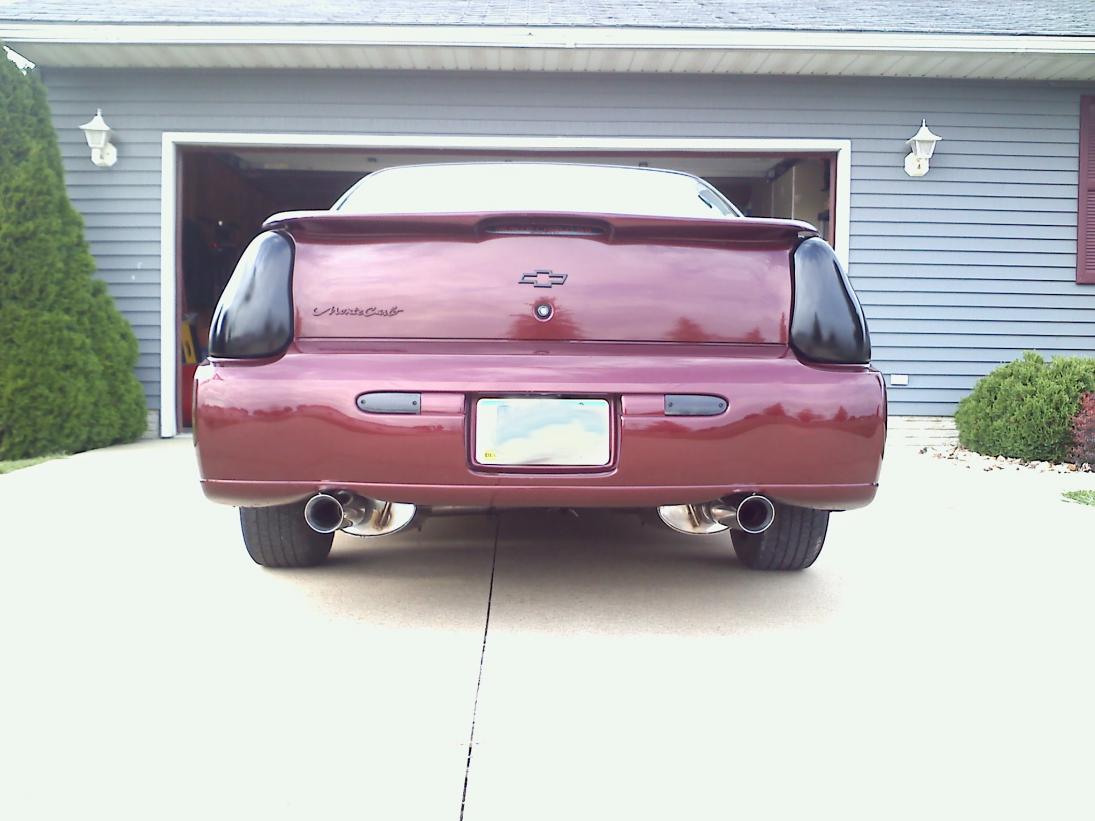

The tips are 3 inch in diameter so they are much larger than stock, even if you you have the optional chrome tips that came with the high sports appearance package. You might want to ask Mod Mike - he has the magnaflow systems and his tips are 4 inch I believe and he doesn't have the high sports appearance package.

So the mufflers hanging down like that isn't an issue, it looks like there's a lot of weight on the muffler hangers. Ill try to get some pictures with rulers and such so I can show you guys exactly what I'm talking about. As long as I can find some longer rubber hangers, I think everything will be fine.

Some longer hangers will take care of it. Because I believe the SLP mufflers are stock size but thanks to the bigger piping and tips it makes them close. When I did my Magnaflows, the mufflers are bigger than stock so even w/ stock hangers and 3" tips they don't rub.
Just get some bigger hangers, but I don't care for rubber hangers, I think they have a tendency to let the mufflers wobble. I use stainless steel hangers.

I agree that longer hanger's should correct your problem.

looks good man, i wouldnt trust the zip ties as the heat might cause them to melt. i bet she roars now :P
