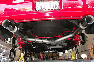

Sound is there to be had. The only reason to get a Borla System is they are Stainless Steel. I had a set and never even mounted them, sold them off. Just go to a reputable exhaust shop (NOT Midas types) and have them build you a set from normal steel exhaust pipes. Jump up the next size (you now have 2.25") go to 2.5". Get some Magnaflow universal bullet type muffs and call I good. My exhaust was built like I just described. I keep them painted with a high temp paint and they look as good as the day I had them mounted. And for half the price of the brand name pipes.
This is them about 8 years old...
Attached Thumbnails Needing Exhaust Tips/Pointers-dscf4812.jpg
