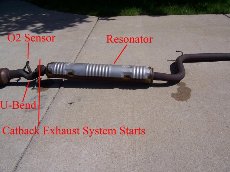

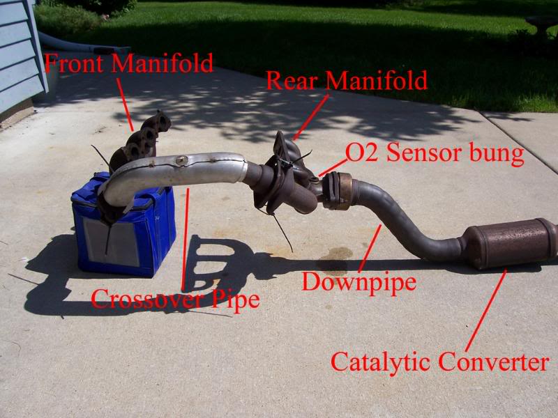

So I don't want a full catback system, I want a downpipe + some other bits. right?
Old Jun 28, 2013 | 11:43 AM

I don't know if it's pipe routing, muffler hanger location or what the difference is but Magnaflow shows a different part number (16729) for the Monte Carlo versus the Grand Prix (16731) cat back you linked to.
If you go with headers you want to stay around 1 5/8" primary tube diameter with an N/A engine. The 1 3/4" primary tubes are for SC engines and if used on an N/A engine will shift the power band up the rpm scale. As a result you'll lose some bottom end power.
My suggestion:
Pacesetter headers with 1 5/8" primary tubes
Magnaflow downpipe
Magnaflow glasspack to replace resonator
OE mufflers
Tips of your choice
When I installed the Magnaflow downpipe I was prepared to deal with the dreaded P0420 code, but it has been on the car for about 2 years now and I have NOT had the code pop up yet - and I did NOT have it deleted when my PCM was reprogrammed. In fact, the only individuals I'm aware of that have had problems with the code popping up are those that installed a ZZP downpipe. Just a little food for thought...
