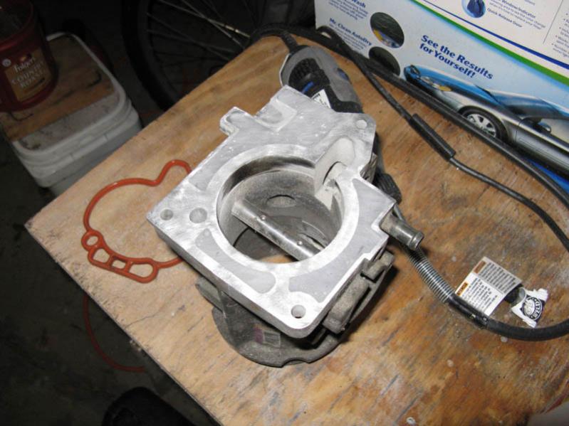

Old Sep 9, 2010 | 09:49 PM
OK, I changed my mind some. I finished sanding the JB Weld and decided, I will do a final "fill in the air bubbles" when I am done (if I already found a few, I will probably find a few more).

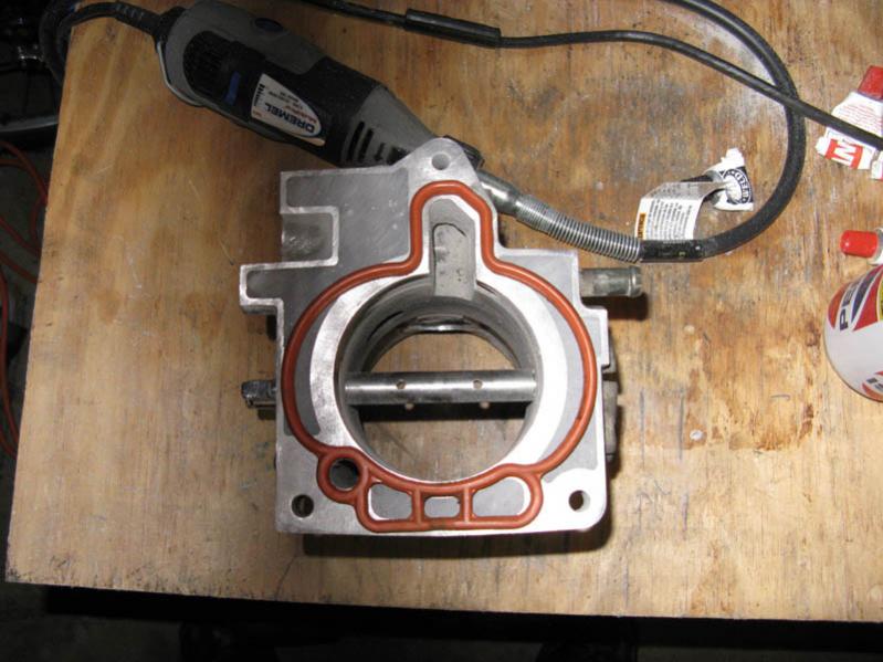

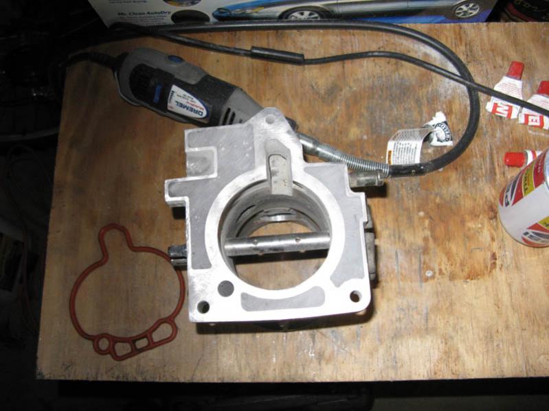

The only other thing I did was used an old gasket to determine how wide the "flare" will need to be. I still need to determine the depth I need to grind (and I have yet to bring myself to removing my T-Body to figure that out).... I will more then likely have to do that soon.
Anycase, some updated shots.

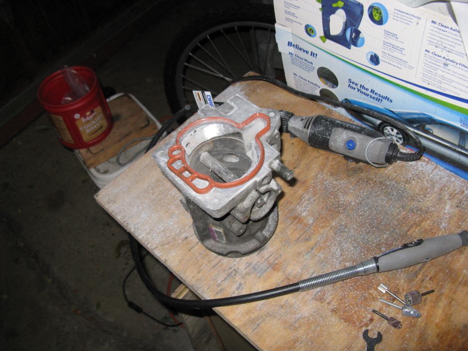

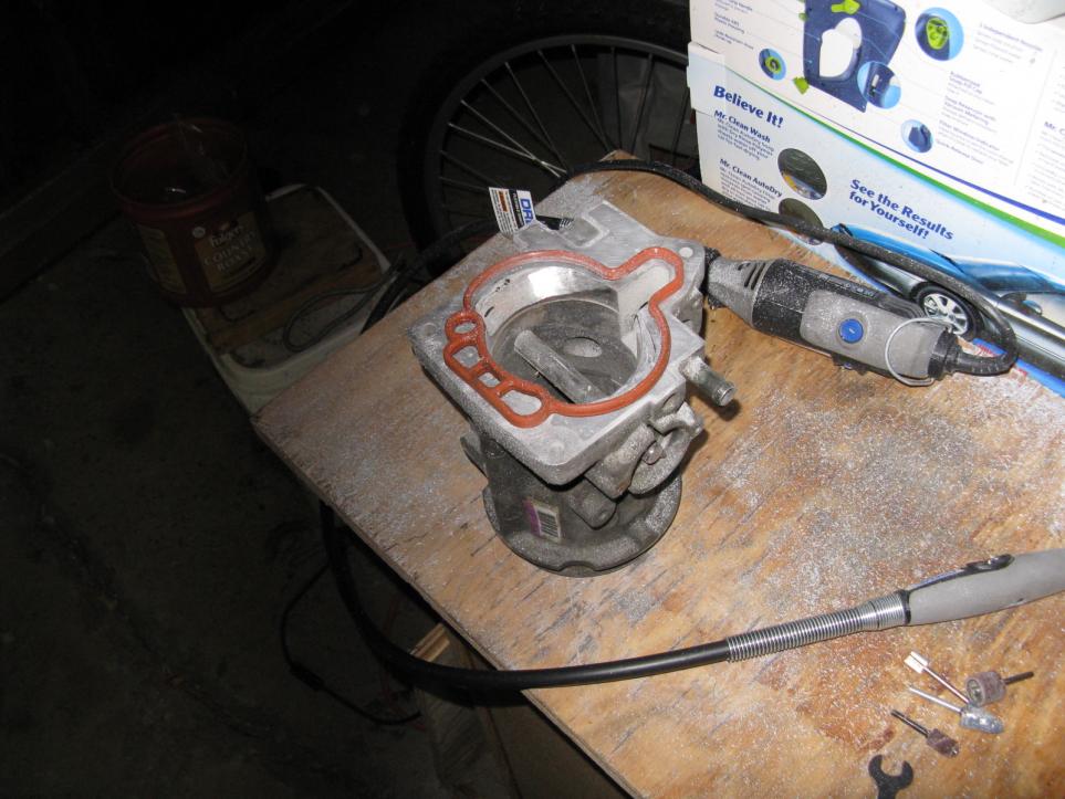

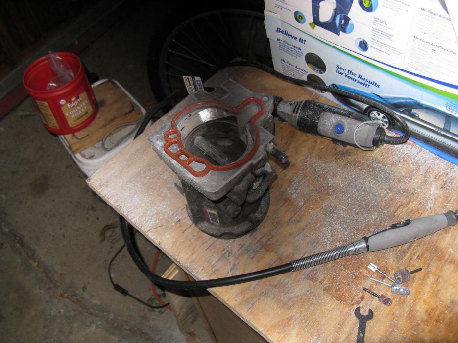

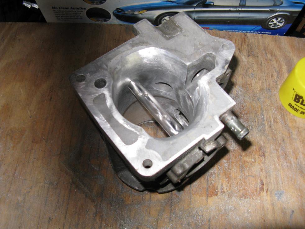

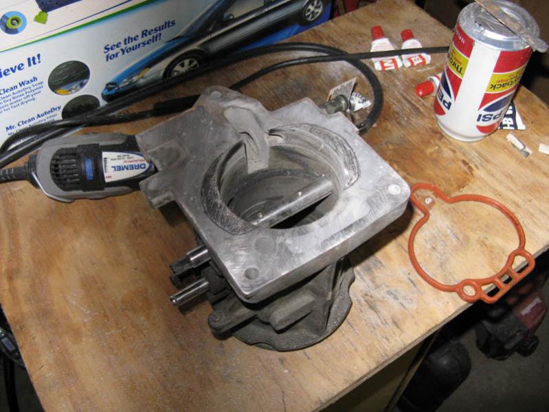

Old Sep 16, 2010 | 09:29 PM
OK, this step I am not yet finished with. I began grinding the flares for the outlet on the Throttle Body (not yet done). I began last night but have not had a chance to finish. So far, so good!
Attached Thumbnails L67 Throttle Body Project-img_3581.jpg   L67 Throttle Body Project-img_3582.jpg   L67 Throttle Body Project-img_3583.jpg   L67 Throttle Body Project-img_3584.jpg

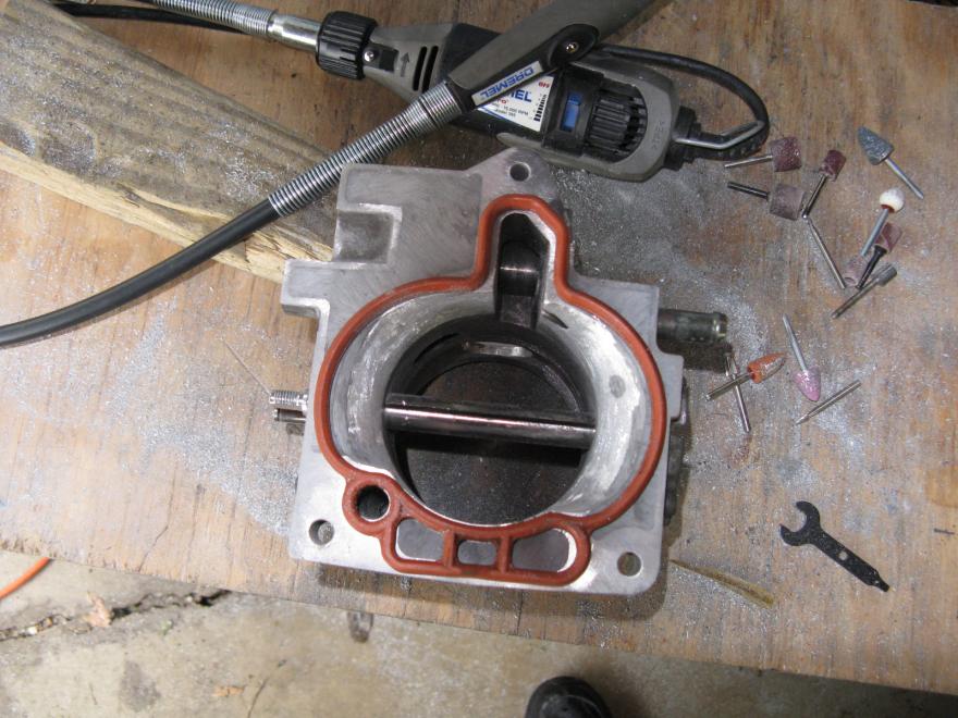

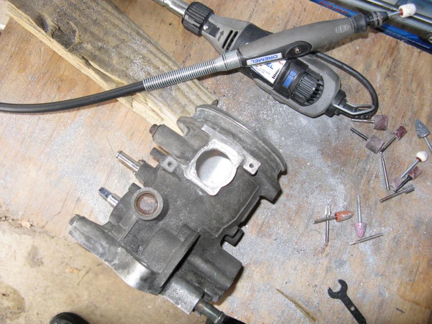

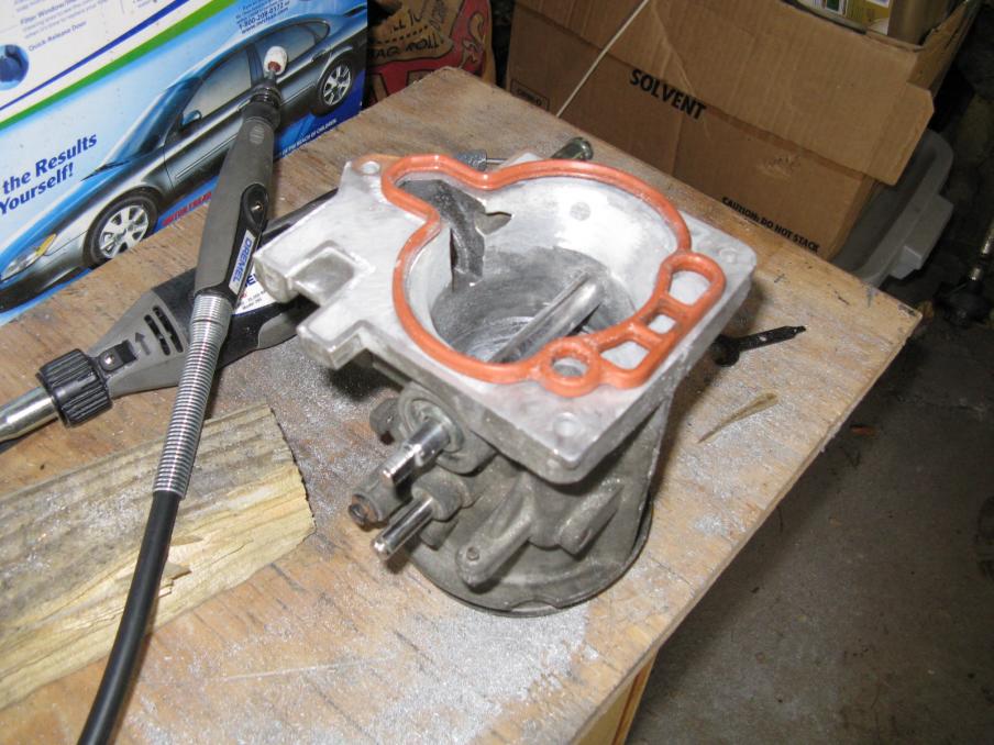

Old Sep 28, 2010 | 11:39 AM

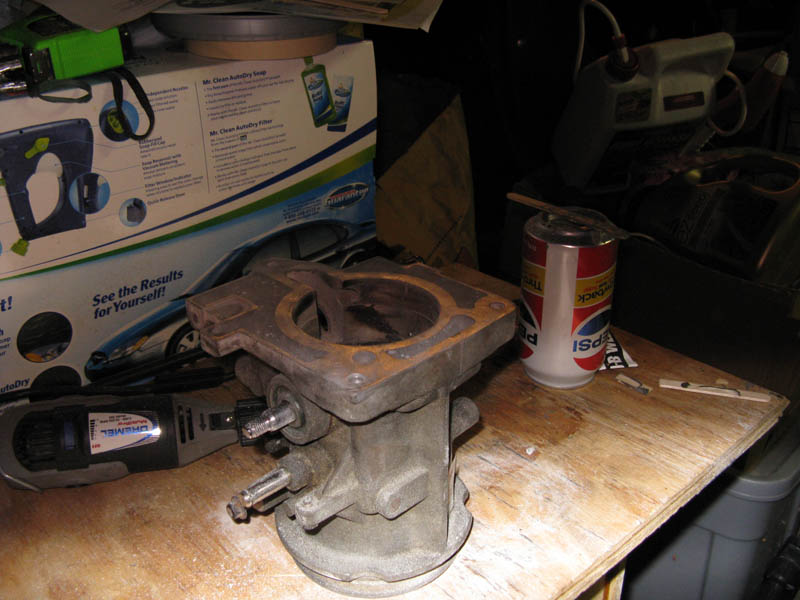

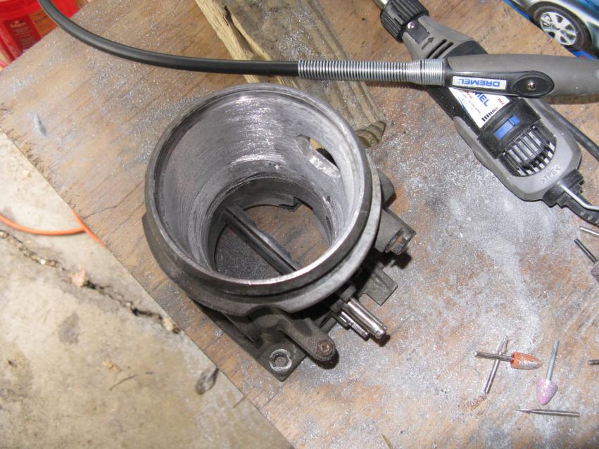

I just wanted to give everyone some updated pics. I believe I might finally be done on the grinding part of this project.
I have to get some additional bits for my Dremel, as I want to give the T-body a polished look/feel on the inside (as it stands, I was using a "polishing stone" on my Dremel and it's not giving the desired results, and I have not touched the throat of this yet, as I don't want to make any significant changes in it's diameter as a result of my trial/error in finding the right method to polish this).
My MAF sensor now fits like a glove on this and once I get the inside polished, I hope to paint the exterior and recondition the throttle linkage and spring assembly (and re-paint those).

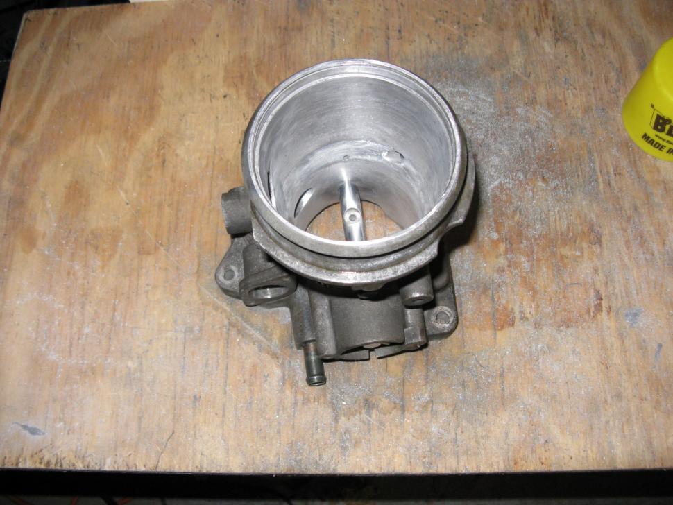

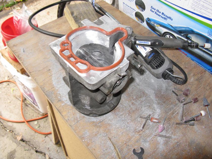

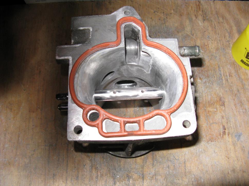

Old Sep 28, 2010 | 11:13 PM
POLISHED!!! Had to acquire some new Dremel bits (the abrasive buffing bits). I think at this point, the inside of this T-body I believe is completed!
I now have to remove two screws who's heads broke during dis-assembly. And then clean up the exterior to prep for paint.... I think this T-Body will look sharp when done (and hopefully yield some worth while results with everything else I have planned).
