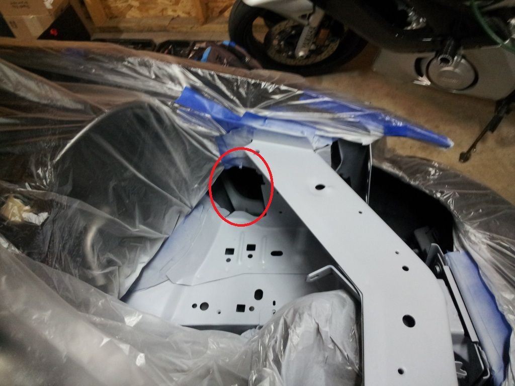

This is the only image I could find of my fender area, but I assume they are talking about the brace that I circled in red..
I'm not for sure what needs cut as I don't have that intake and I haven't seen many people on here that do have it installed, and are still active.
Hopefully somebody who actually has the intake or knows more about it can chime in. I'd hate to see you trim the wrong brace.

Thanks for the pic. I think you are right but confirmation is def. what I am after. Anyone out there do this?

Pretty sure the brace circle in red is the one that needs to be cut. By the looks of the intake kit, it looks like the filter sits in that area inside the fender

Ok, so after many months on considering what to do, I went ahead and started to install with intent to cut the fender brace. When I got to it, I dryfit everything just to see how much of the brace I needed to remove. Looking close, I saw the filter was actually being stopped by the metal hole edges shown in the red circle above. So, I took my trusty sawzall and hacked out about a quarter inch around the hole in the shape of the filter. It turns out, everything fits almost perfectly! The metal surround that blocks the engine bay air from the fender air fits nicely on the top and is out about a quarter inch on the bottom. A little foam gasket and it's good to go! It sounds great and I can feel the difference for sure!
