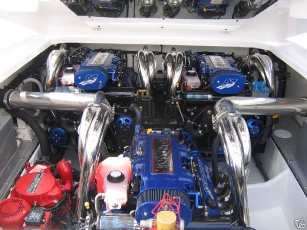

If you do the hv3 go ahead and install a l26 aluminum uim while you have the plastic one off
much much better setup no leaks ever,
