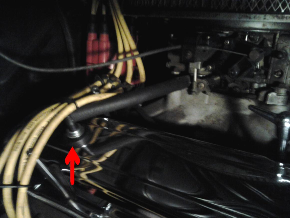

Originally Posted by Skeletal Crow
I wish you could show me a picture or something, I'm not really getting it to be honest man.
Ok, here is a pic of my '65 Impala SS, where the red arrow shows is the breather tube coming from valve cover, I have mine rerouted to an opening in the side of my carb, a 600 cfm 4 BBL vacuum secondary, depends on your carb config. Look for a large port that may be capped. The other line comes from the front of my carb to the vacuum modulator on the front of the distributer, yours might be from another source, can't tell from your pic where it goes! Hope this helps!
Mike

I don't think I have many options for that being that I have an entirely stock motor. The carb there doesn't have ports where I could insert that in I think. I just know mine has the word jet in it.

Probably a Rochester Quadrajet?
