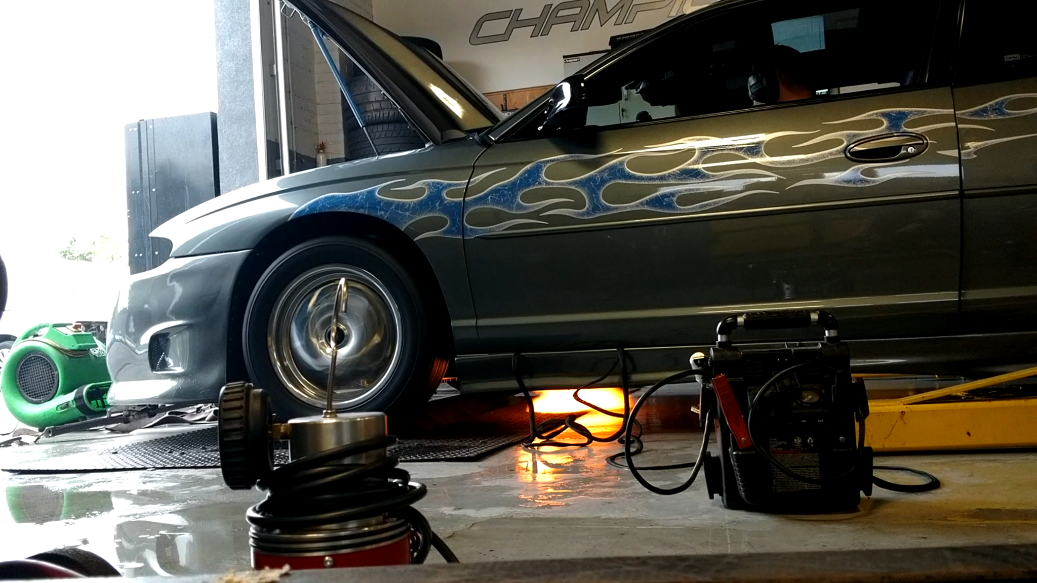

Here is my setup, it's crazy loud, and shoots massive fireballs but I also have a huge turbo, 3.5" downpipe to a cutout and also open dumping 2 46mm wastegates lol
Attached Thumbnails Exhaust Cutout with Cherry Bomb?-received_10154966154614613.png   Exhaust Cutout with Cherry Bomb?-received_1401441759891824.jpeg   Exhaust Cutout with Cherry Bomb?-fb_img_1499026121036.jpg
