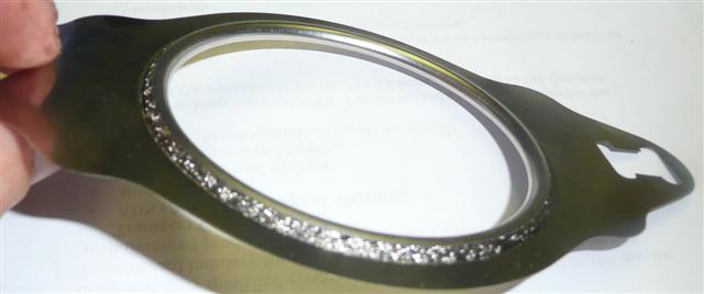

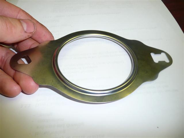

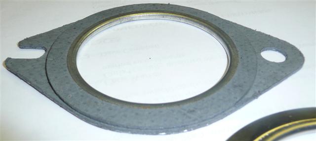

Btw, they sent me some gaskets. One is metal and the other is the fiber kind. Anyone know which way the metal one goes on? Both sides are raised but one end has a mesh of metal in the rim. If I had a camera here I would take a picture.
EDIT: Now that I look at it, the fiber one has a raised edge and a flat edge. That one is curious as well.

i believe the metal one goes to the manifold and the other one to the resonator
Very true but I meant which way? You can see that one side has a raised edge on the fiber gasket and both edges are raised on the metal gasket but one raised side of the metal gasket has a mesh in it.
I have pics.
I have pics.
i dont think it matters lol
im not to sure on that :p

Thanks. I'd still like to know one way or another if anyone does happen to know.

As for the gaskets, ZZP told me that it doesn't matter which way either one goes. They asked me to send some pics of what I received and voila!
