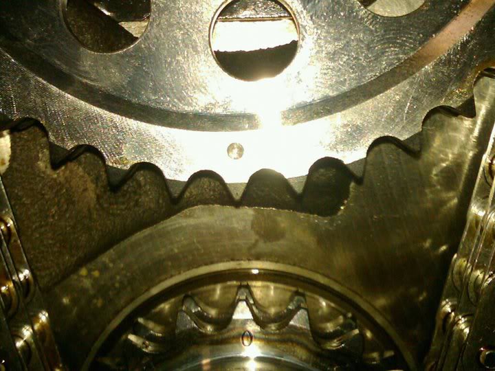

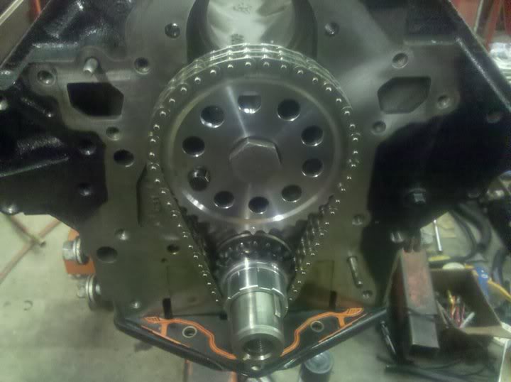

i dont know of any videos but i have pics that will show you
first thing you do before installing the new timing set is make sure cylinder 1 piston is at top dead center!!
as you can see in this picture you want the crank gear (bottom gear) installed so the (0) is facing up (toward the cam gear) and on the cam gear you want the dot facing down toward the crank gear. the (0) and the dot should line up with each other.

thanks yes it helped my timing was off an i wen to try an drive my car after installing the cam an the flywheel studs broke off an i bent a pushrod so i got a whole new motor hopefully everything works out now thanks for the help an my sprocket didnt have anytype of timing mark at all
