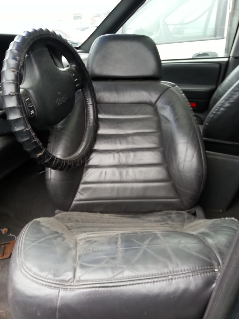

found this last 98 zj. i love the seats on this one but there's a big tear on the corner driver side. the motor work and i was able to slide the seat forward and got all four bolts off and the four nuts off that holding the seats cuz i only need seat track.
when i got home i was testing on the seat to make sure every thing work one of the track doesn't move. oh wow im not very happy. was scratching my head and thought of what would Mcguyver do in this situation. i decide to swap the track rails from the wj to the zj seat. it swap rite on and all power work. the only thing i have to do is drill new hole for the seat belt clicker on the seat frame and call it a day. im tired i'll do the swap tomorrow.

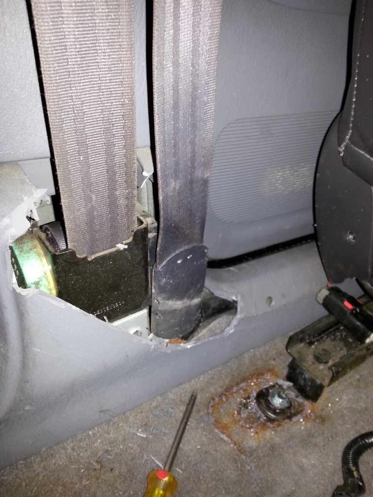

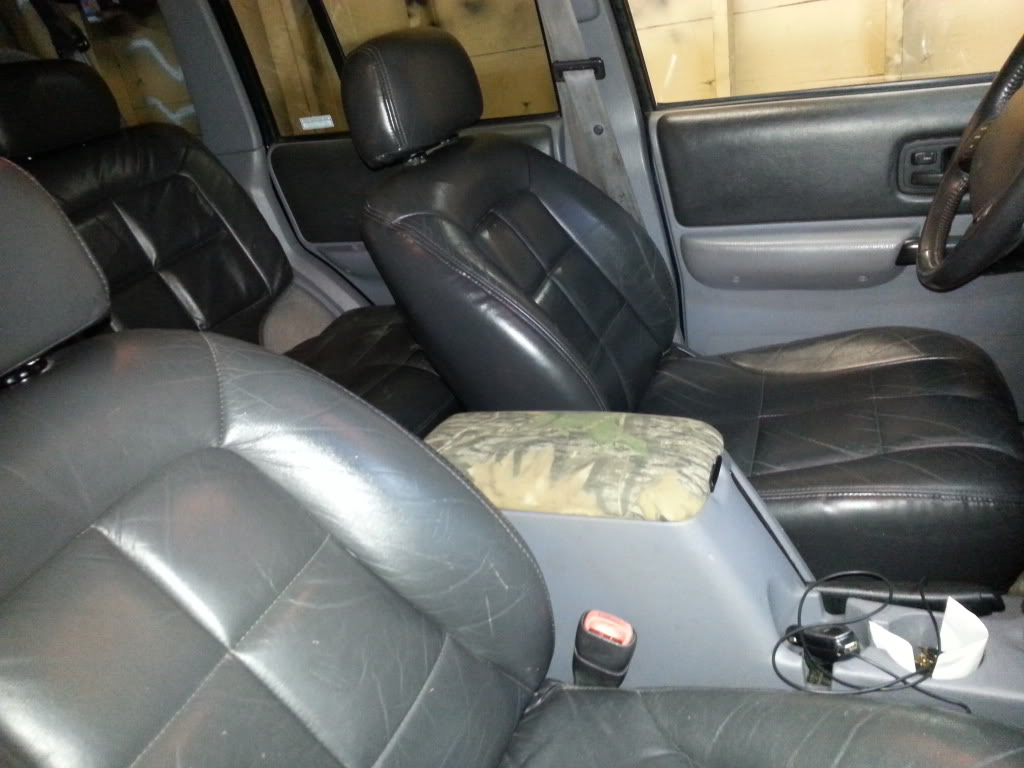

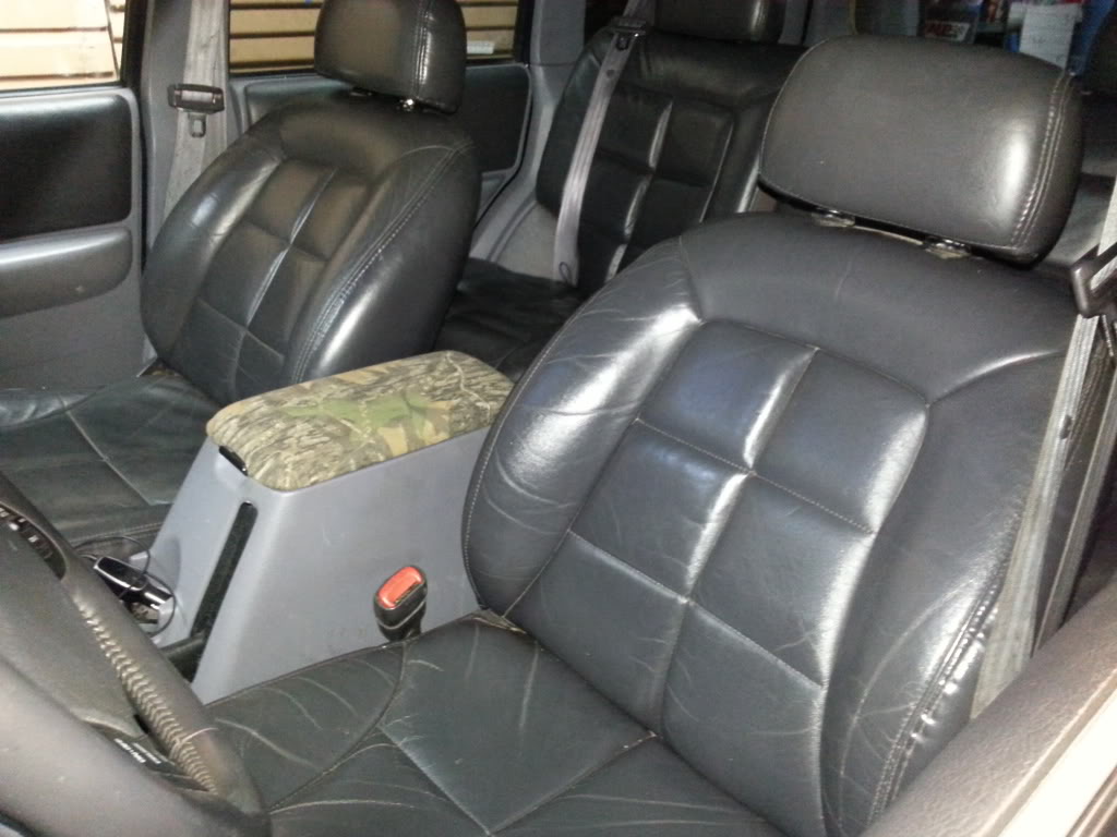

finally done withe zj seats swap. worth the swap so comfortable on the back now.
the driver side was tighter fit than the passenger side. i had to hack up the seat belt cover cuz the seat was hitting on it and won't let the seat slide back. it's no biggie i'll find something to cover up the hole. when the seat is move back the hole doesnt look that back. also the trim is replaceable i'll get another one at the jy if it bother me that much lol.

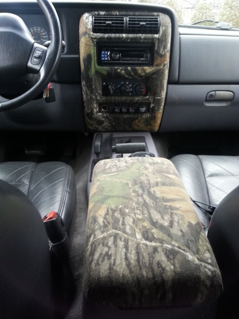

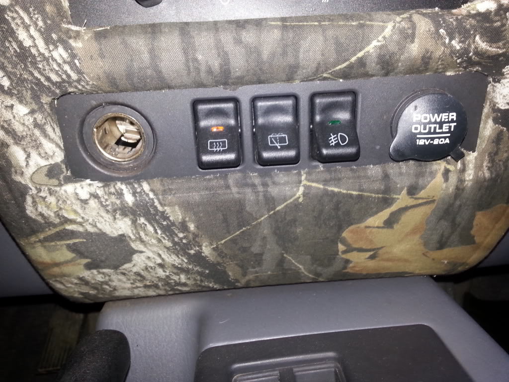

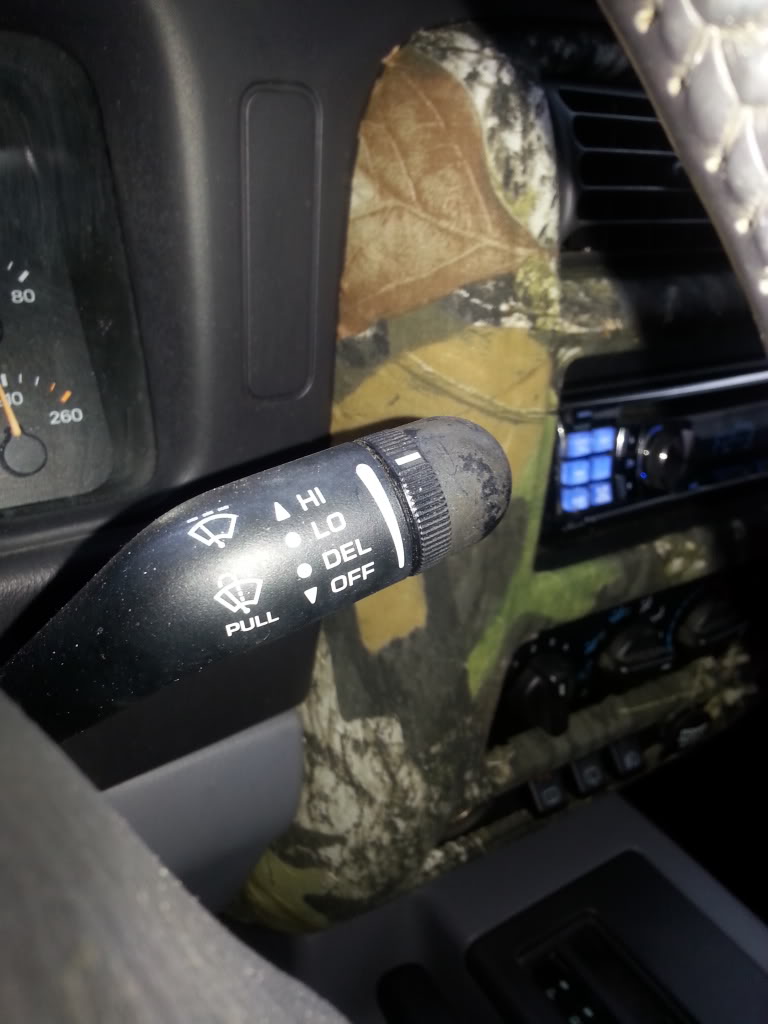

ok think this probably the last camo trim i'll do for now
Old Apr 3, 2014 | 06:44 AM
  #159
Posts: 4,948

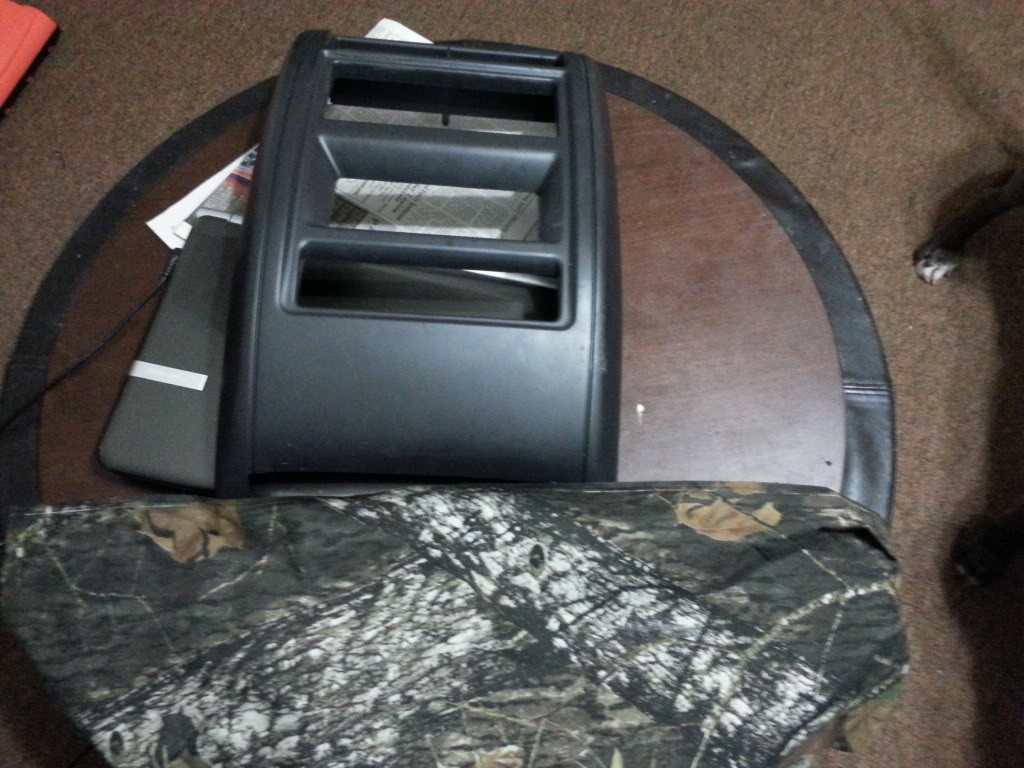

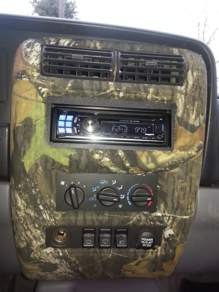

Nice wrap job on the bezel. How difficult is it to contort the fabic to follow the bezel's contours and get it to adhere wrinkle free? Are you using a spray on adhesive and then laying the fabric on and pushing it into place? Also do you pre-fit and pre-cut the fabic first and then apply the adhesive? How do you apply the fabric with a squeege, wood roller or what so the glue behing does not bleed through the face of the fabric.
Old Apr 3, 2014 | 02:05 PM
  #160
nemesis's Avatar
2009 Monte Of The Year
Posts: 2,810
From: over here
it's actually pretty easy to do. on youtube they recommend to use 3M spray adhesive. i used Permatex, another brand name. didn't do any pre cut out on the bezel. the only pre cut-out i done were the visors. all i did was eye balling the the size of the bezel and cut the the fabric giving it about an inch for all size corners extra so the fabric will cover all the bezels front surface. i spray a good two coats of adhesive and lightly drop the fabric on top then smooth out all the wrinkles with your fingers as much as you can. you going to have some small wrinkles in some certain spots that you unable to press out. no tools are need just your monkey's paws. the fabric i use are pretty durable and no glue seep thru. just got to be careful not too too much spray then glue might seep thru. if it does just wipe off the access glue. the hardest piece of all i done was the headliner. everything else just got easy after. the headliner that size on my jeep i would recommend to have 2 person doing it with lot of lights or during day time outside cuz of lot of wrinkles need to press out and make it easier. i was doing the headliner by myself in the dark garage was kind of making it harder.
