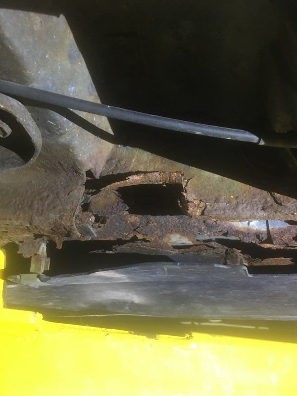

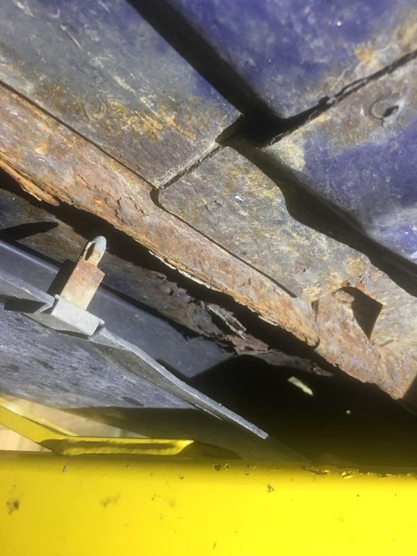

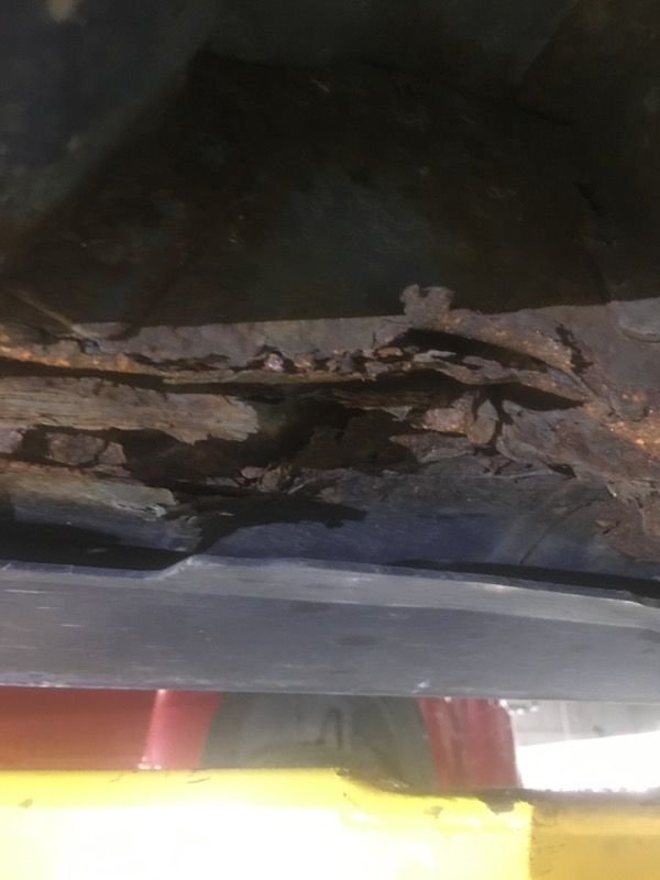

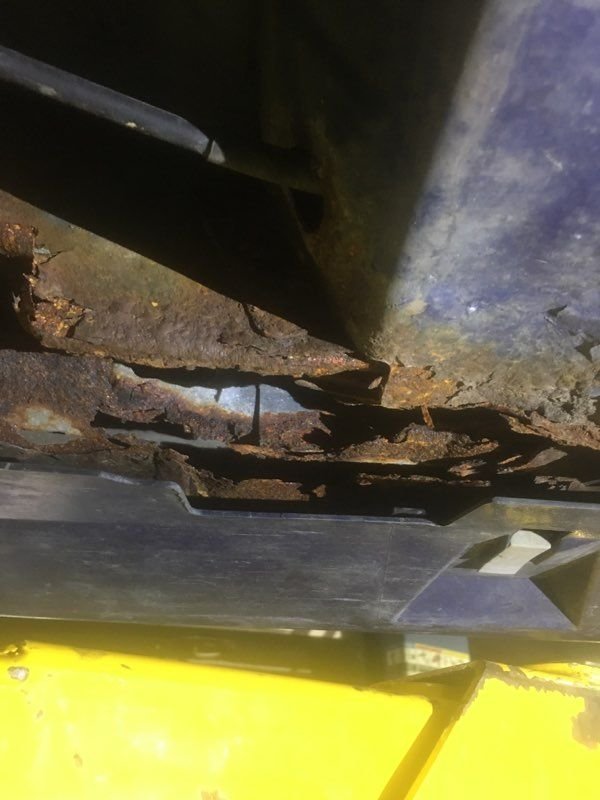

Thanks for the info. I just got some terrible news, that my MC is so eaten up with rust underneath it's not fixable. I had taken it to another shop previously, and they had assured me it was OK and to go ahead and fix things that were broken and needed replacing. I don't have a rack at home, but these rust issues are so obvious I cannot believe the previous shop did not speak up about how bad the rust is. Now I am soaked in this car and it is essentially a money pit. The donor car I bought, which also came from Ohio, is no better. I hope others read this and run as far as they can from any Monte Carlo from up North that shows the slightest sign of rust. Thanks for your time to explain the tranny problems.

Having rust issues underneath from the God-awful deteriorant they put on the roads here to melt snow, but apparently not as bad as the one the Gray Ghost posted.
