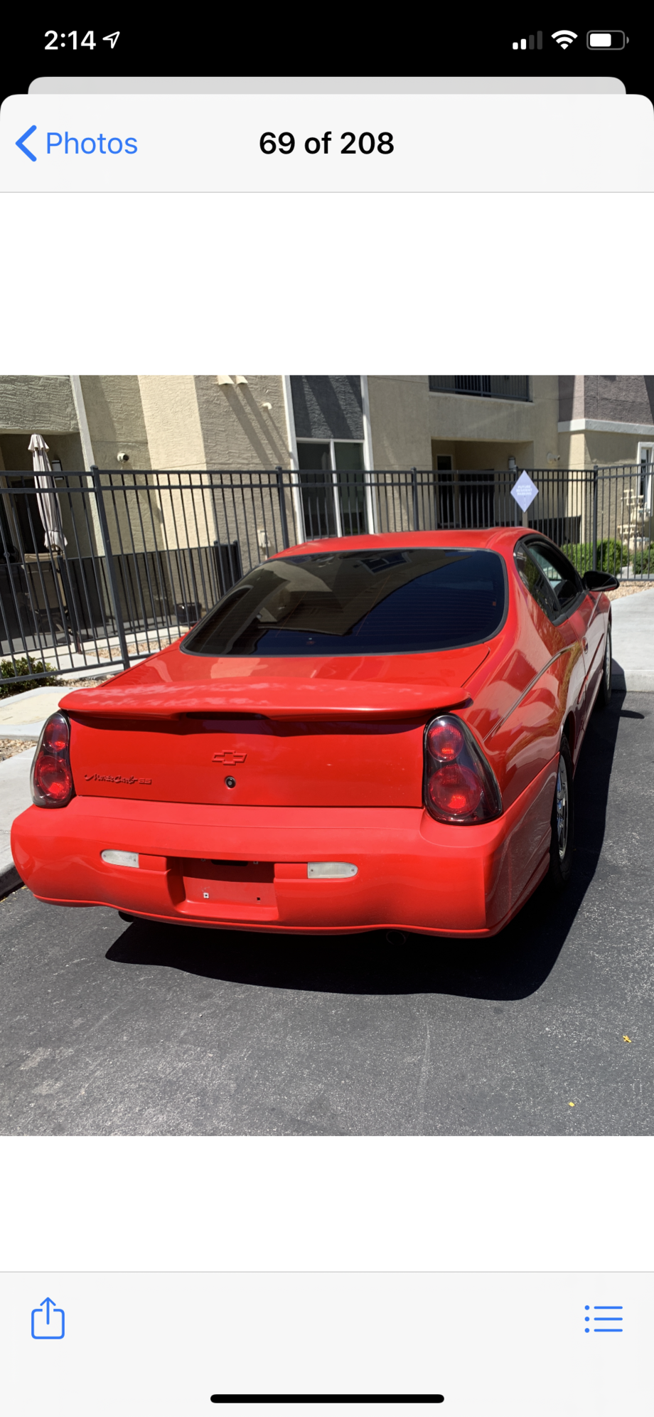

I recently bought a 2001 Monte Carlo SS I need the Check Engine light to turn off in order to get its emissions and registration done.

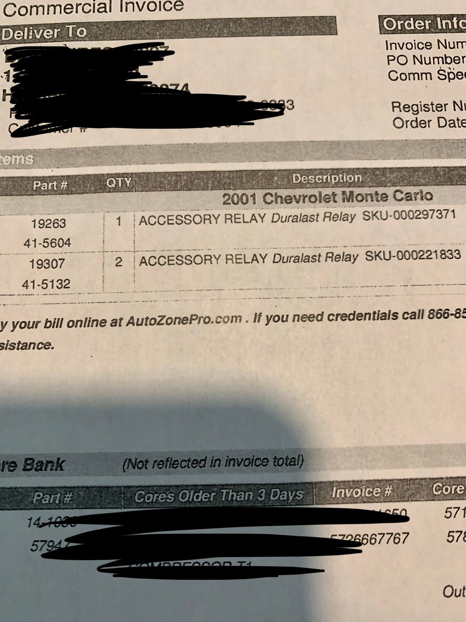

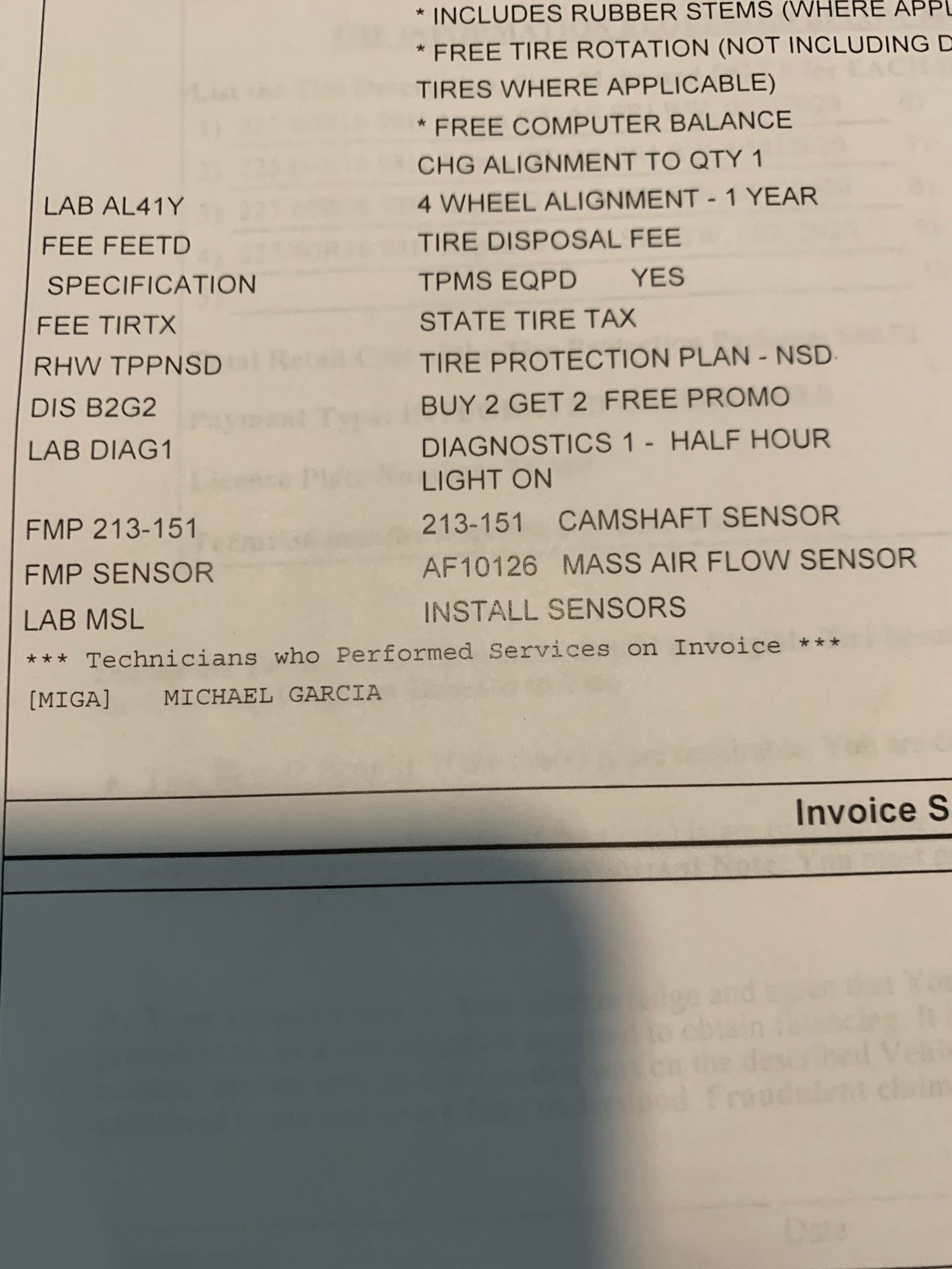

I took it to a local mechanic and they weren’t able to fix the issue. They replaced the current mass air flow sensor, camshaft sensor and fan control relays. Despite replacing all these parts , the check emhine light is still on.

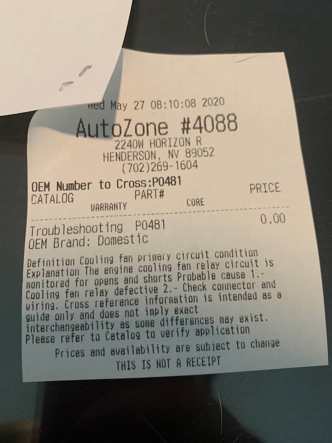

I took it to Autozone and tested the engine to see which code it’s showing. PO481 Which is related to the cooling fan.
any tips on how to fix this issue would be appreciated. I’ve attached pictures as well.
Was P0481 the only code originally or did the mechanic hose you by randomly replacing unrelated stuff?
What did they say when the repairs were complete and the light was still on? This just seems like a fairly simple code as there are only a handful of things involved to test so I'm a bit surprised they would just give up and hand it back (and if they did, I'd find another mechanic going forward).
How are you with electrical systems? Do you own a multimeter?
I'd test the relay first, even though its new. Wouldnt be the first one bad out of a box and IMO is the most common part of this system to fail. If that checks out good, I'd jumper the fan and make sure it works. If both of those test good, I'd take out the relay and jumper the fan on via the relay sockets. Thatll make sure the wiring from the fuse box to the fan is intact.
Beyond that it starts getting tricky - is it the wiring from the pcm to the relay? Bad pcm?
