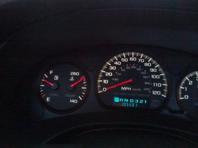

So my car is a 2001 Monte LS few added factory goodies. So its a nice ride but I was wondering if I change my dash display from the simple layout to the multiple gauge display they have on the SS models. I know it will fit but are the connections the same or is there more to it than that

My best guess would be they should plug right in to your harness and work. I know they had different gauge packages per car model but use the same harness and you can check but sending unit should be same from electric to mechanical gauge ( oil ) so odd's should be in your favor. I agree that the cluster you want looks much better with a oil and alternator gauge.

Bottom one you have pictured looks just like the one in my 2002. SS. As for the sender just call the local parts store and see if there is a different part # for the oil sender with a gauge or idiot light. And if there is, you could just change the sending unit . Good luck Herman and keep us posted , I'm sure a few people might be interested.

The oil gauge will not work, but everything else should.
And the odometer won't come over, it is stored in the cluster itself. Most times you need to either fill out paperwork (for registration and mileage differences), or have a dealer reprogram the odometer for you.

I don't believe we have found a way to get the oil gauge to work. I'm pretty sure that sensor and wiring is built into the harness and PCM.
The odometer would need to be programmed to your car, because when it comes time for inspections and registration your mileage will be completely wrong and you can't have that.

I believe the dealer is unable to reprogram the mileage. I've played with a GM Tech II (tool the dealer would have) and no luck. Also, the GM shop book does not talk about reprogramming the dash.
I have heard of services that can reprogram the cluster.
Now, as for the gauges, everything works except the oil gauge. I researched some of it and here are things I can tell you about the oil gauge:
- The oil pressure switch vs sending unit have different part numbers.
- The connector on the oil pressure switch/sending unit is different.
- The connection for the oil pressure sending unit/switch goes to the same location on the PCM.
We had a member that did some work and swapped piece parts and the gauge still did not read. My best guess is something in the programming of the PCM.
Some people cover the oil gauge on the cluster.
