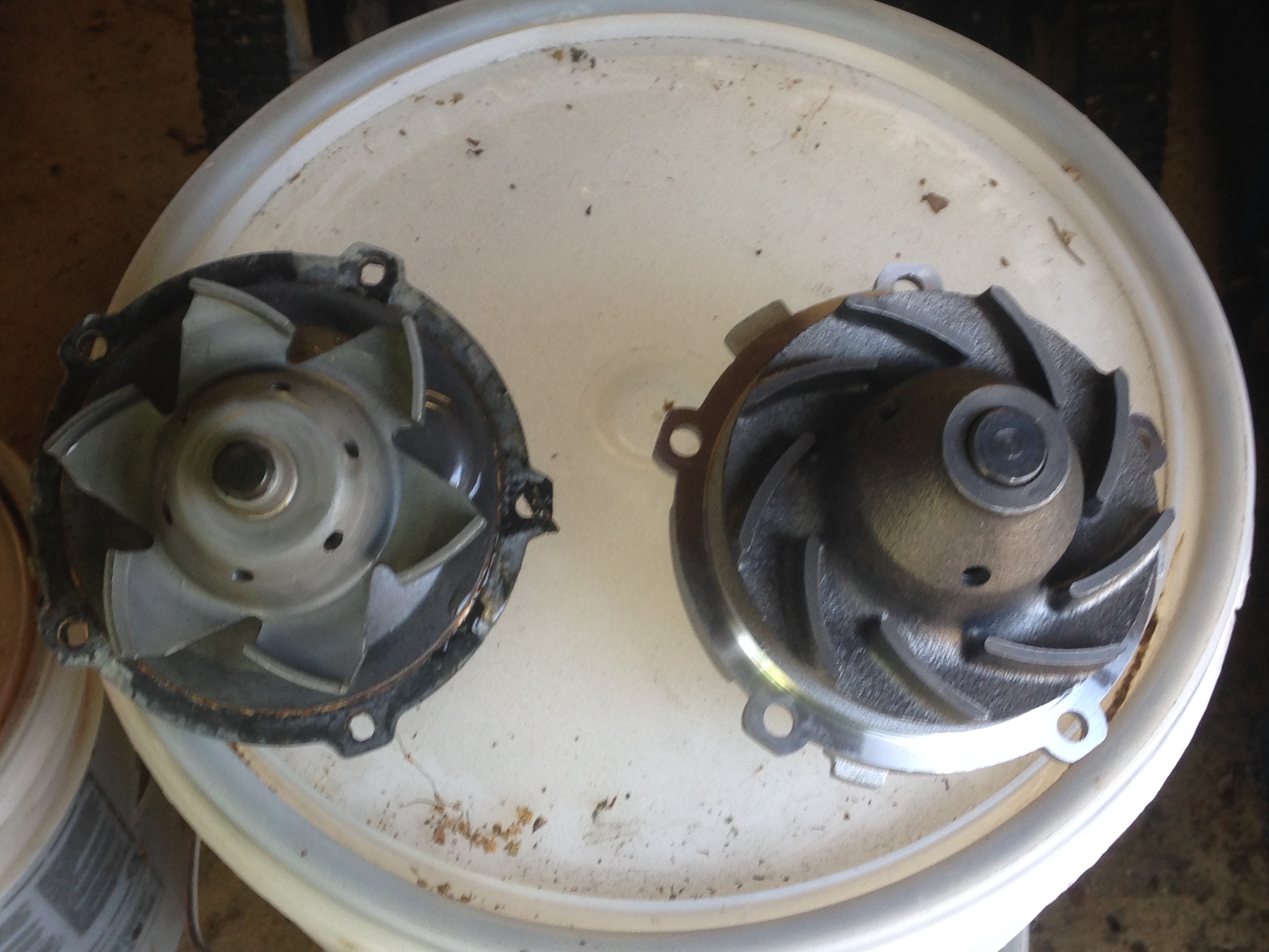

If you want to improve your cooling system, sometimes a simple change like a water pump can make a difference.
In my Monte with a 3800, I upgraded my water pump from the factory stamped steel impeller to a Series I/III cast aluminum impeller. Advantage is, better fins/flow design. I also expanded the coolant bypass on the lower intake of my 3800.
I made a similar pump swap in my '04 Grand Am that has a 3400. Replaced the stamped steel impeller for a cast aluminum/better design pump.
Admittedly, I believe the 3800 does better, but that is because I have both a pump upgrade and improved flow on the coolant bypass.
The improvements are minimal, but if you are striving to improve coolant flow and efficiency, don't rule out a simple change.

Thanks Maniac... any photos of those particular upgrades/changes?
Here is a link for my 3800 and the lower intake mods:
'04 Monte Carlo SS - Port Matched LIM
Here is one showing the pump differences in the 3800 pumps:
http://crzyz28.sytes.net/mycars/2004...mp_Upgrade.jpg
The attached pic is the 3400 water pump differences.
