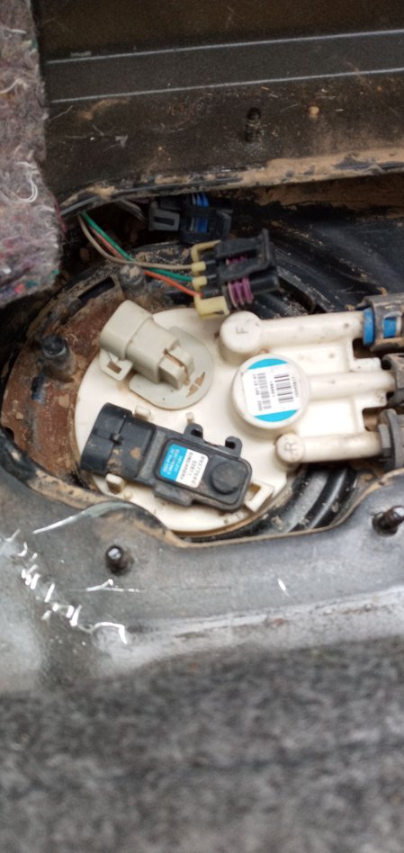

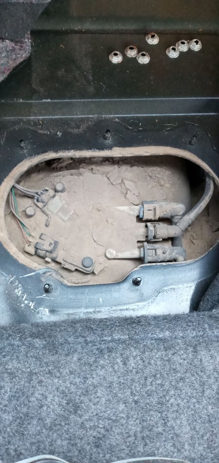

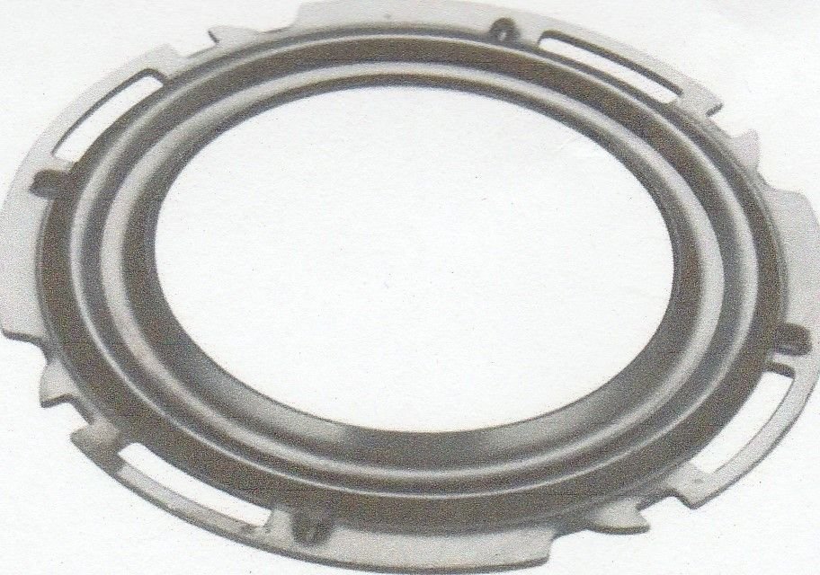

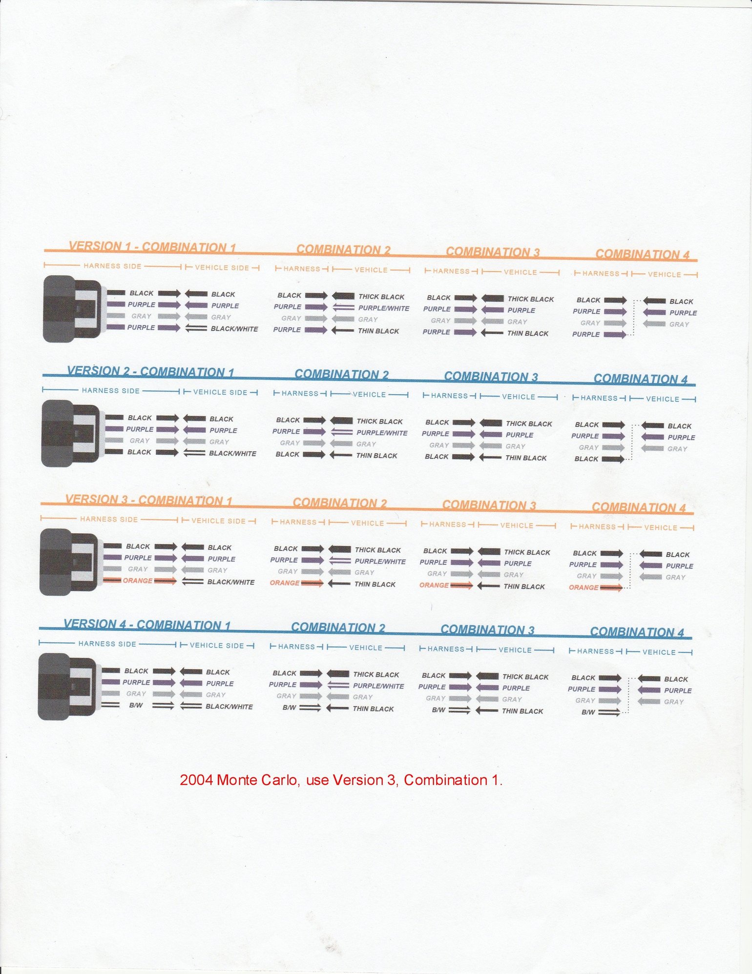

Talked to a mechanic friend of mine and he suggested that it was the fuel pump.
So ... ordered one from OReilly for 157.00 and a new fuel filter.
The fuel pump was a PRECISION brand that is made in China. The one thing they didn't tell me was that I would have to do some rewiring of the pump and get a new lock collar. When I took off the cover I think I found most of the Kansas dirt outside of Kansas.
Wow, that is a lot of dirt!
