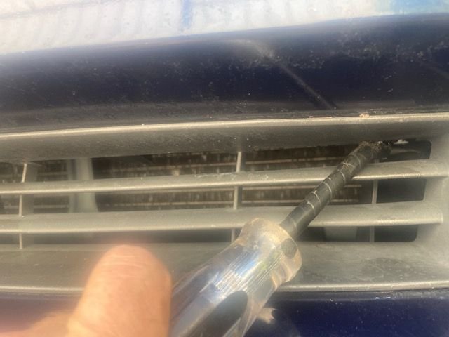

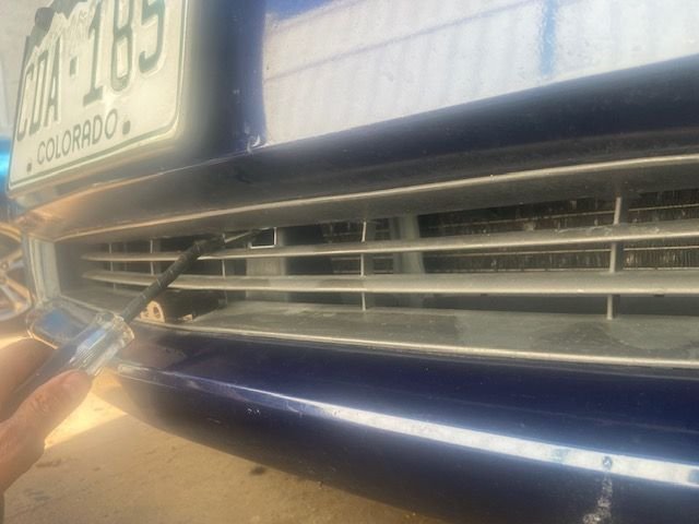

Access and release the nylon retaining head of the 3 bumper cover forward bottom retainers, removal tool can access through the front of the lower bottom grill.

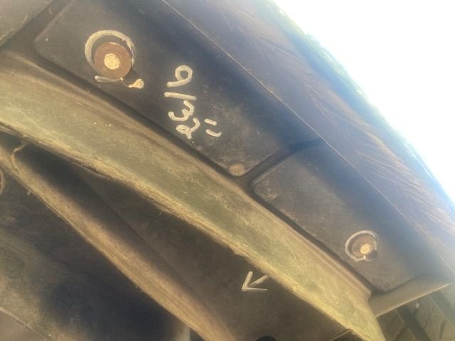

Use 10mm socket with extension to remove upside down bolt which is at either ends of bumper cover, accessible from wheel well. Use 10mm socket to loosen a lot the upside down nut, which locks the slider hook into position, accessible from headlight assembly hole.

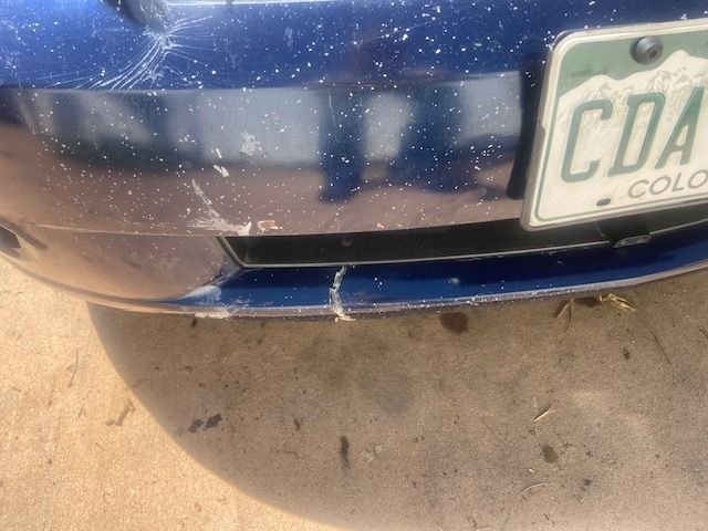

My cover had one complete large crack/split and a smaller one. My headlight plastic retainer housing also had a crack. I repaired it all with the super glue and baking soda.

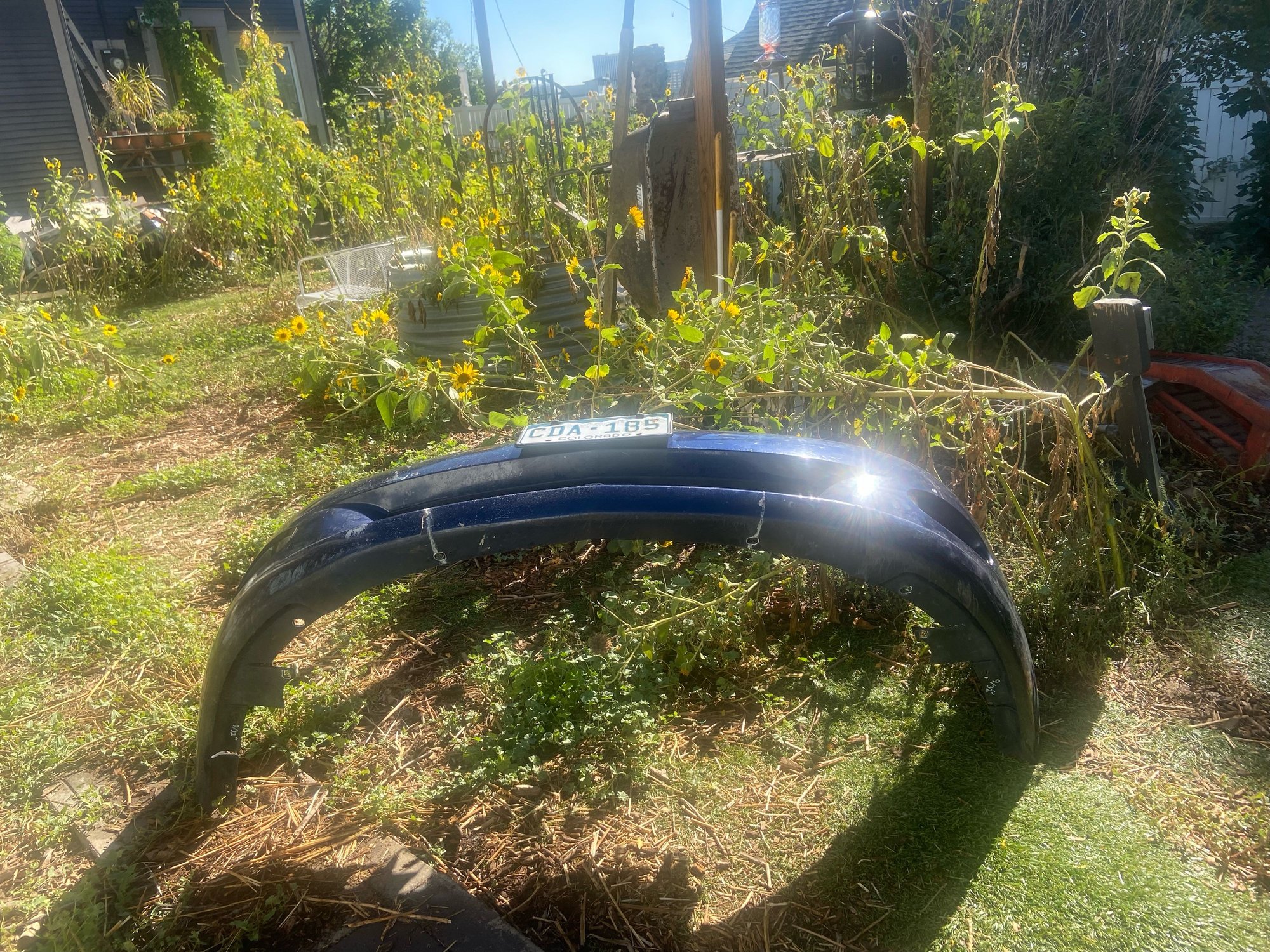

Pics below(not necessarily in chronological order)
Take care
After repair (I didn't take a pic of before repair but this split were bad/big, like the cover was going to split in two)

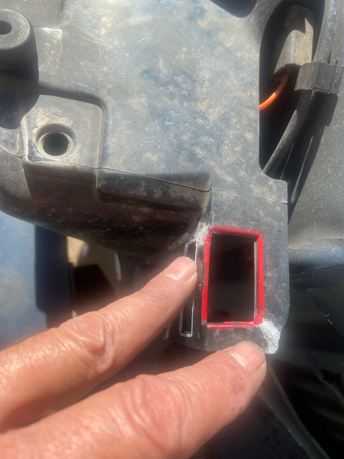

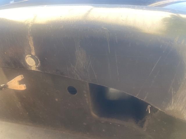

Access to release the 3 main retainer nylon round head plugs-pull down:

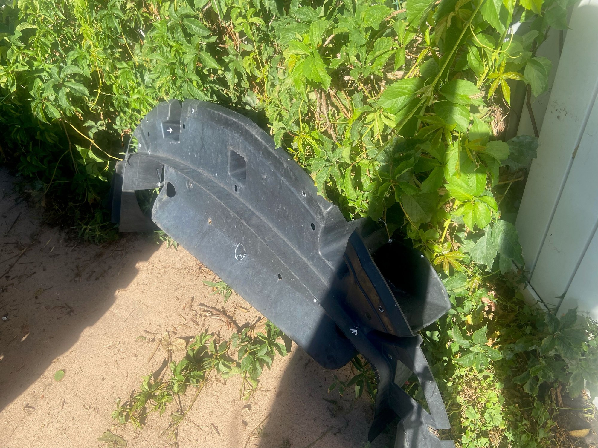

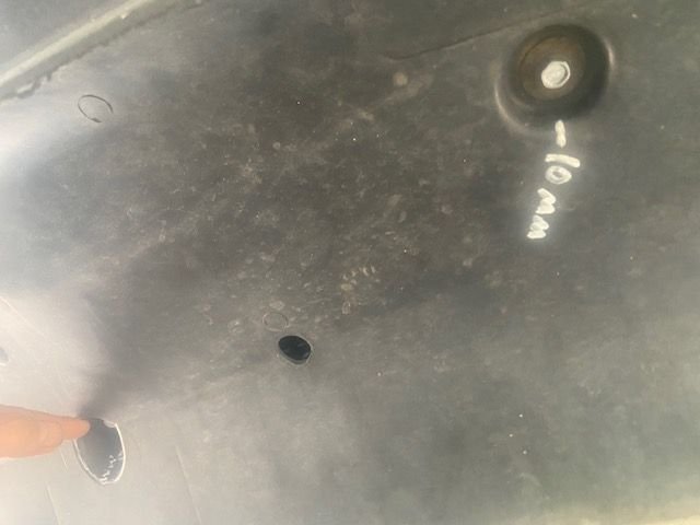

Air ram retainers:

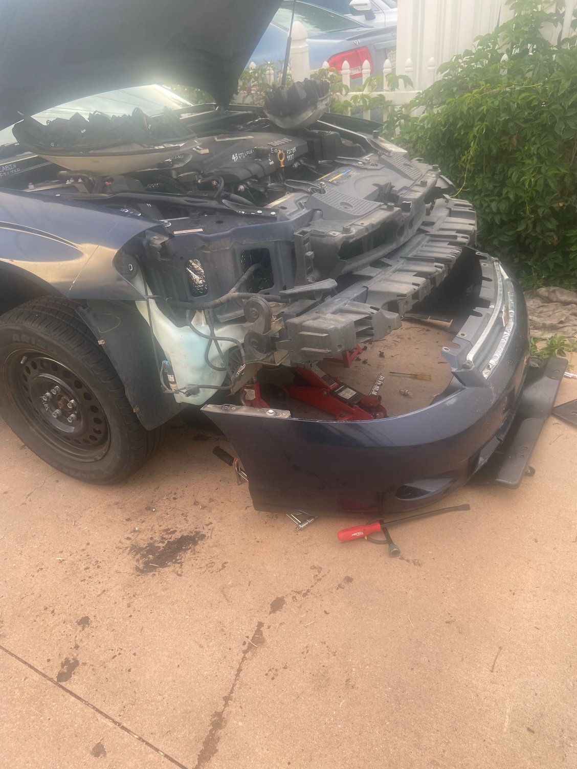

Remove last-top retainers-cover will fall off:

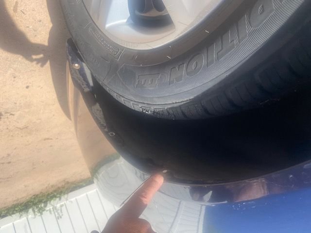

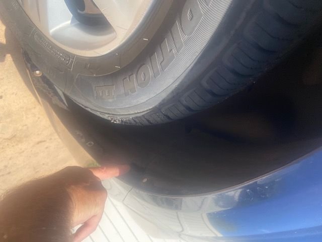

10mm socket w/extension to get to the upside down bolt-but you have to release enough of the fender liner to gently move it out of the way for access:

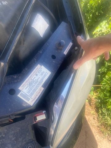

Headlight assemblies removal:
Reinstalled, cracks repaired, strong now:
The worst crack/split repaired, still a bit ugly but strong now(if I find a dark blue paint pen, I'll paint over it to help hide some):
Air ram removed (one of the air directors partially visible):

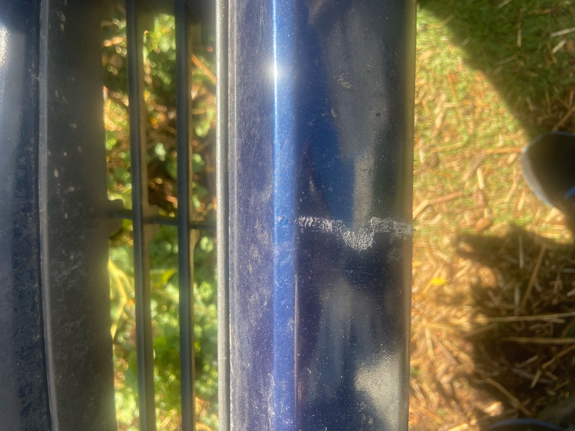

Also used super glue baking soda on this plastic crack:
