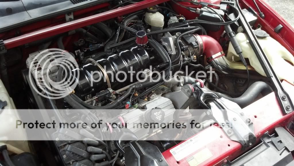

I know I don't post on here much anymore, but found that this works and figured I'd share with my brethren.
I did the l26 UIM mod to my car last summer, since then, my sleeper FWI / stock intake tubing wasn't fitting right, so I was looking around for a cheaper solution that didn't involve PVC pipe. I found this.
http://item.mobileweb.ebay.com/viewi...d=330980928037
Its a cold air intake for a 3800 v6 camaro, I put it on my car with no cutting whatsoever and it put the filter into the bumper.
.. good throttle response with no top end, so I cut it to the FWI length... much better. Even power throughout the RPMS.
So in short, $30 can get you a FWI.

Wow real cheap. Where does the filter sit?

Nice, wonder how well that would work on the 3100 if the battery was relocated.

I wonder, does the size differences between an L26 and L36 UIM make a difference with this FWI mod?

I take it you re located the battery?
Where'd you put it?

Yes, it will work for a relocated battery. I put mine in the trunk, I'll put up a trunk pic tomorrow. I'm at work till 2am.
Like I said, I cut it so it now sits where a FWI would... before I cut it, it was under the driver headlight right over the vacuum ball... thing that is right in front of the wheel... it should work on 6th gens as well as 5th.
Not sure, the l26 UIM is a bit longer than OEM, but the intake was long enough to possibly work for the OEM Mani.
