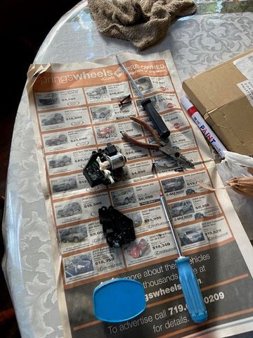

If you need to remove the interlock box. unplug it and:
Move shifter forward and backwards as you flex manipulate the cover/slider up over its retainers.
Either swing the cover/slider side ways out of the way or remove it by: Use a Philips driver to remove forward screw below shifter ****. Remove shifter ****.
Use a small torx driver to insert from the top down to remove both long retaining screws for interlock box. You'll have to move the shifter as needed for the best angle. Park may be best.

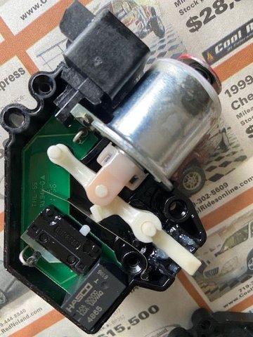

Once removed, you can remove the 2 short torx screws to open the box up. It just has a center seam.
Inside there is circuitry which knows when the white button is in or out, Also there's a micro switch which is pressed if both the white button and the solenoid are pushed in at the same time.
I didn't look at a wiring diagram. I can say that the ignition key will not come out if the wire harness is unplugged from the box or if the button is stuck in(like it's not in park).
Use a wet rag to clean out any soda/coffee residue.
They spray with some silicone spray and/or apply some vaseline, to the moving parts.
