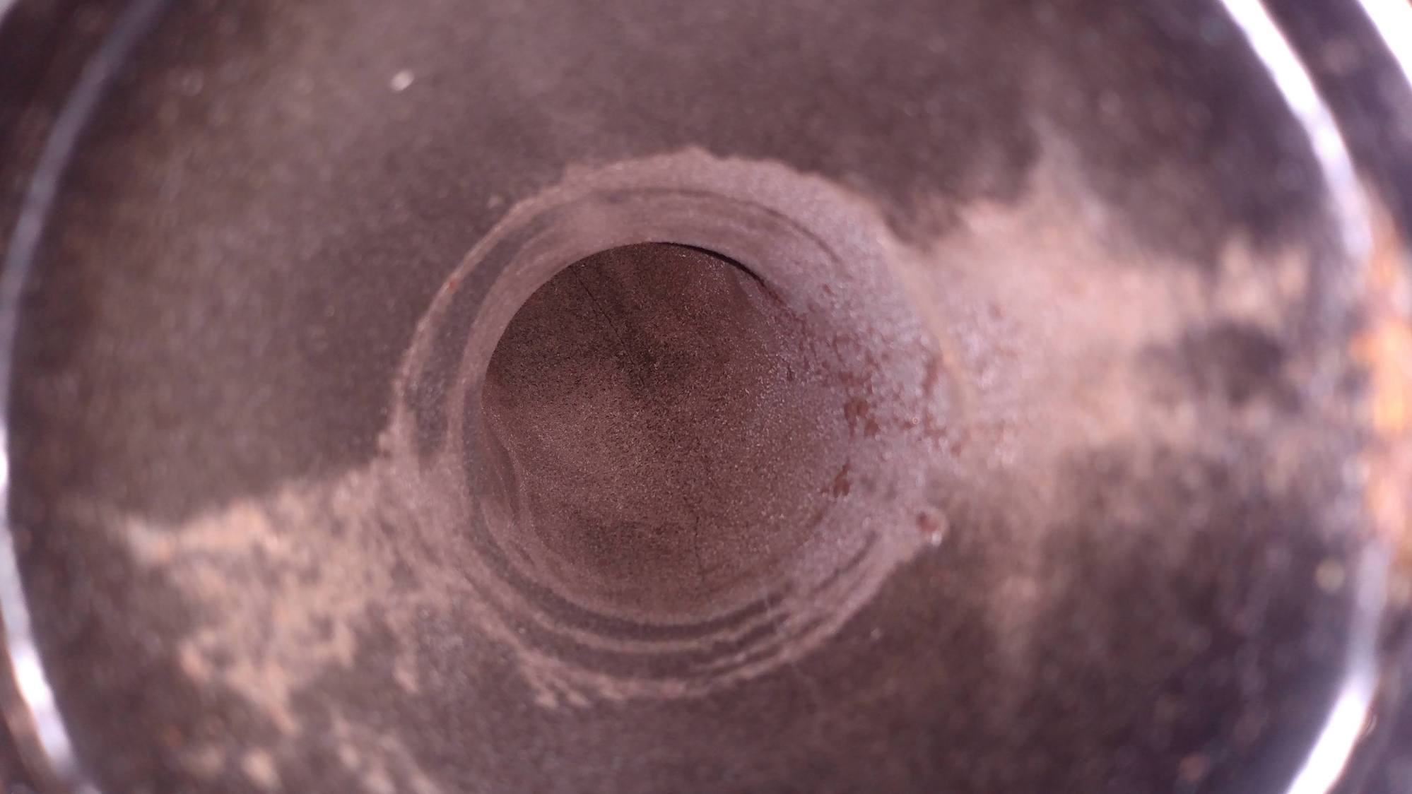

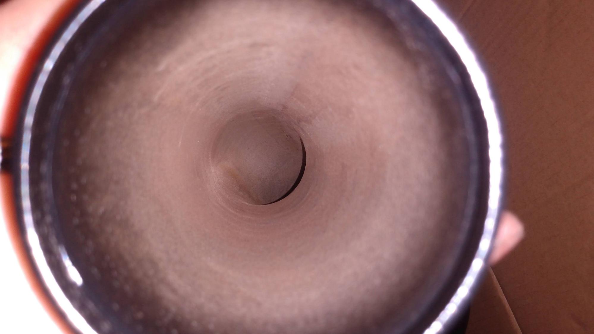

Intercooler piping just got in, and I'm glad I thoroughly inspected it all. The piping is black supposedly powder coated on the outside, but there's no coating on the inside. The product description claimed they were aluminum pipes, so that shouldn't matter. But I found corrosion inside some of the pipe. I did check them with a magnet, so they have to be a non ferrous metal, but I don't believe aluminum corrodes like this. The worst pipe was one of the two 180* bends, which I deemed unusable. Thankfully, I only needed one of those. The two straight sections also had light corrosion, but those will be easy to clean up and use. As far as the 45* and 90* bends, they were pretty clean. Situations like this are the reason I like to avoid ordering from ebay, but that's just my opinion, and experience.

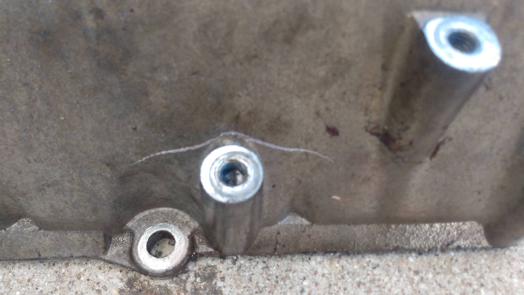

I finally got around to replacing that cracked side cover on the 4t80e. Other than that I've pretty much made no progress. I just haven't had the motivation to go use an angle grinder and welder on some stainless steel in my 105+ degree garage. But I'm trying to start making little bits of progress on the header fabrication. Tonight I got the two sets of three pipes that I cut for the collectors to finally fit well enough to were I'm confident I can weld them. I looked for pre made collectors. but couldn't really find what I wanted for a price I was happy with. I found exactly what I was looking for, a 1.5" three into one schedule 10 collector (link) but they're 100$ each. At first I didn't want to spend 200$ on the collectors for these headers, but after how many hours I spent trying to find a template online, cutting, and making the collectors fit right, I should've just bought the pre made ones.

Those pipes look pretty crazy if that's supposed to be aluminum. Does it feel heavy enough to be cheap stainless?
I just don't know how they'd get that much buildup in there. Certainly looks way worse than bare mill run aluminum tube. It certainly forms an oxide layer, but that sure doesn't look like typical aluminum oxide.
I know what you mean on those collectors too. 4-1 are a dime a dozen due to the I4 and V8 markets. 3-1 seem to be crazy priced in comparison. I had thought about making some DIY ones right about the time I got this smoking deal on used TOG extremes. The two collectors alone would've cost me what I paid for the whole set of complete headers, so I scrapped that idea. Certainly your situation is different though as they don't have off the shelf manifolds to do what you're trying to do.
I don't have any experience with aluminium vs stainless outside of what I'm currently doing. I have the 1.5" and 2.5" stainless for the turbo exhaust, and compared to that, the intercooler pipes are much lighter. But the intercooler pipes are less than half the thickness of the stainless pipe I have, so I really couldn't tell. Even if it is bad stainless, would it develope the reddish/brown rust like you'd see on mild steel?

Originally Posted by WolvenScout
Even if it is bad stainless, would it develope the reddish/brown rust like you'd see on mild steel?.
Yes, it is possible. One good example is 400 series stainless used in exhaust. It can completely rust over in the right conditions in use, although its much more resistant to complete rust through than a mild steel.
Combine that with questionable melt mixes due to the country of origin, and its certainly possible to have legitimate surface rust.
If it really is aluminum though, I've got no idea on that one. Maybe they cut it on a wet saw that cuts all kinds of stuff? Of course if that was the case, it'd also wipe off.

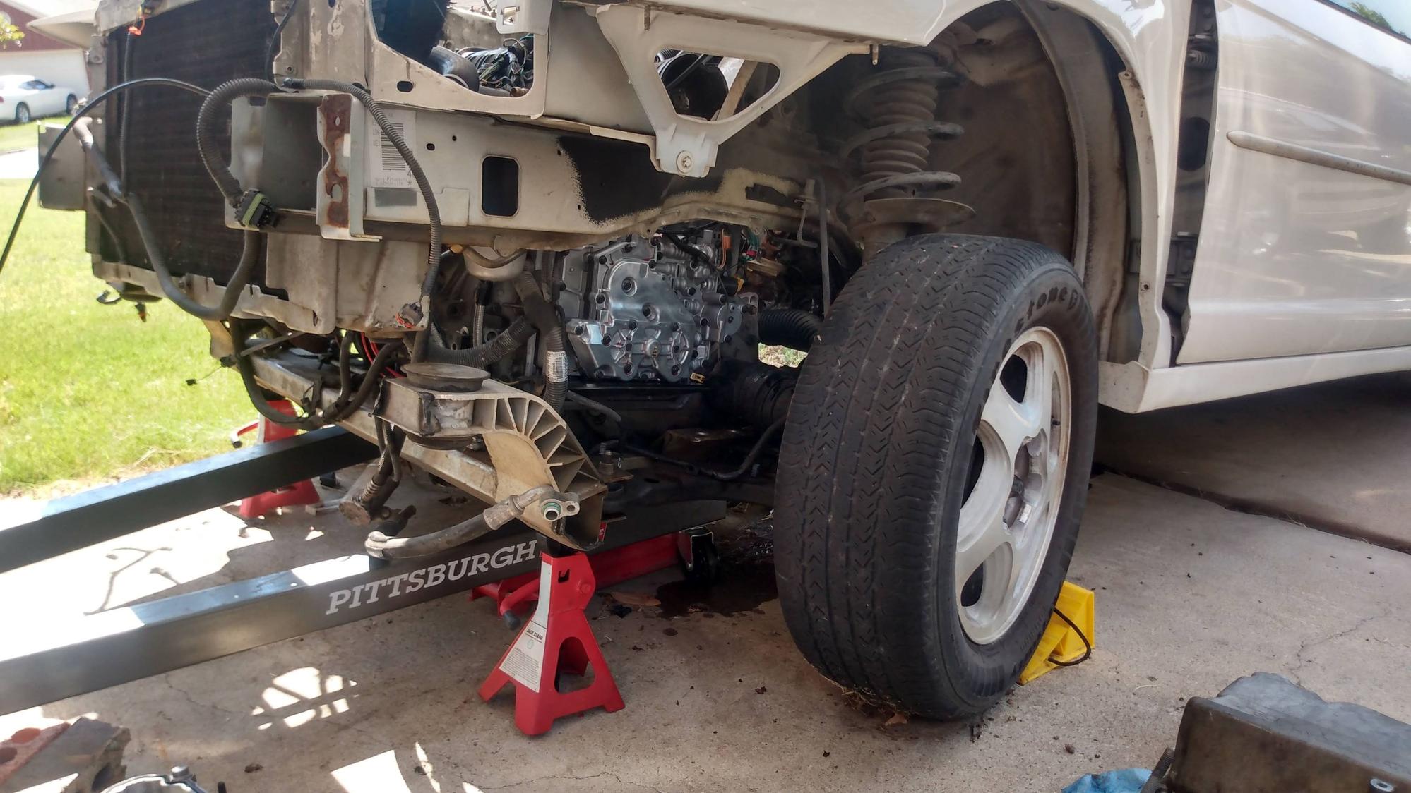

Things just got interesting.
