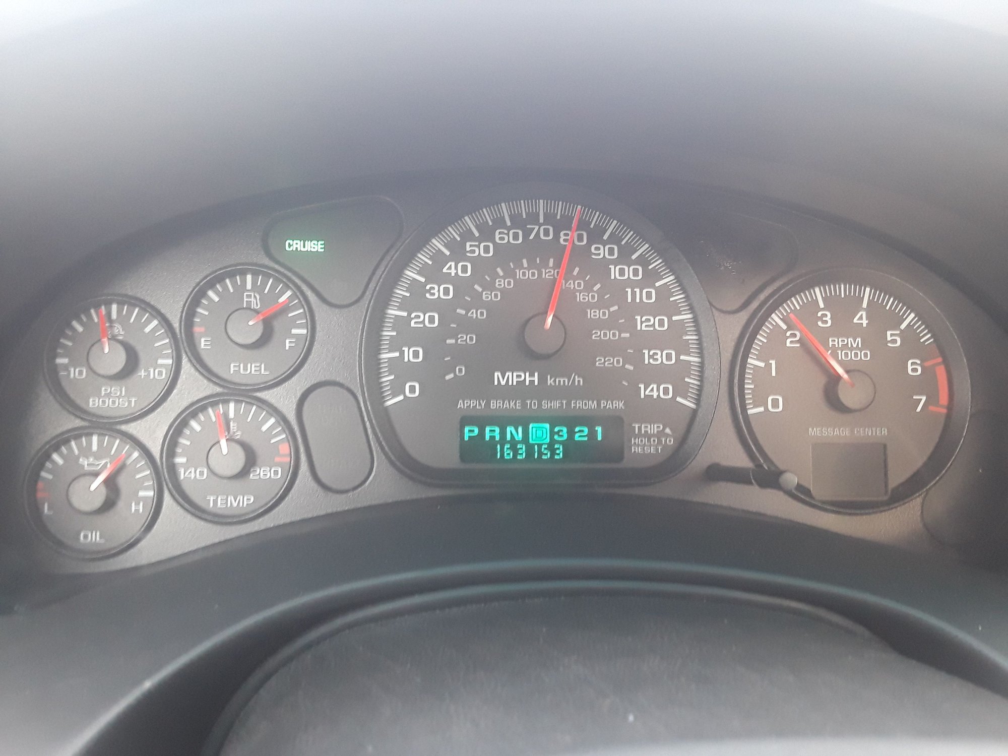

You keep the fluid changed and a tranny can go a long time. My MC has 164K and shifts just fine, except for that random lurch I get when I take off from a dead stop. Nature of the beast with GM trannys. Had a 2007 Impala with 190K and original tranny.
Most people rarely change the fluid, and therein lies the problem. I change mine every 30K and use Dexron VI synthetic Valvoline. Your tranny fluid only gets as hot as your engine as the cooling lines run through the radiator. Your temp should run just a tick above the last mark before straight up and down on your gauge. That's right at 190. Might run hotter if you are in town traffic a lot.
