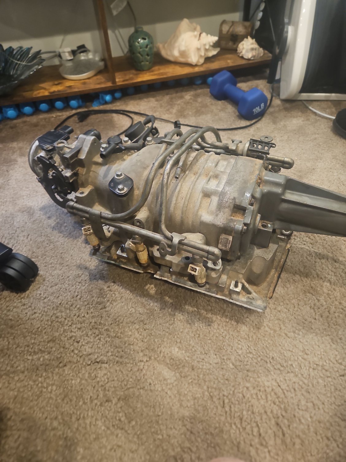

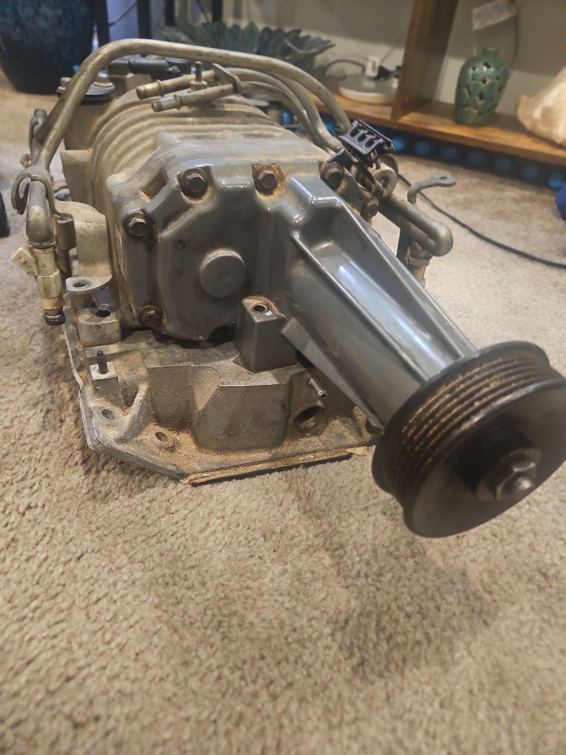

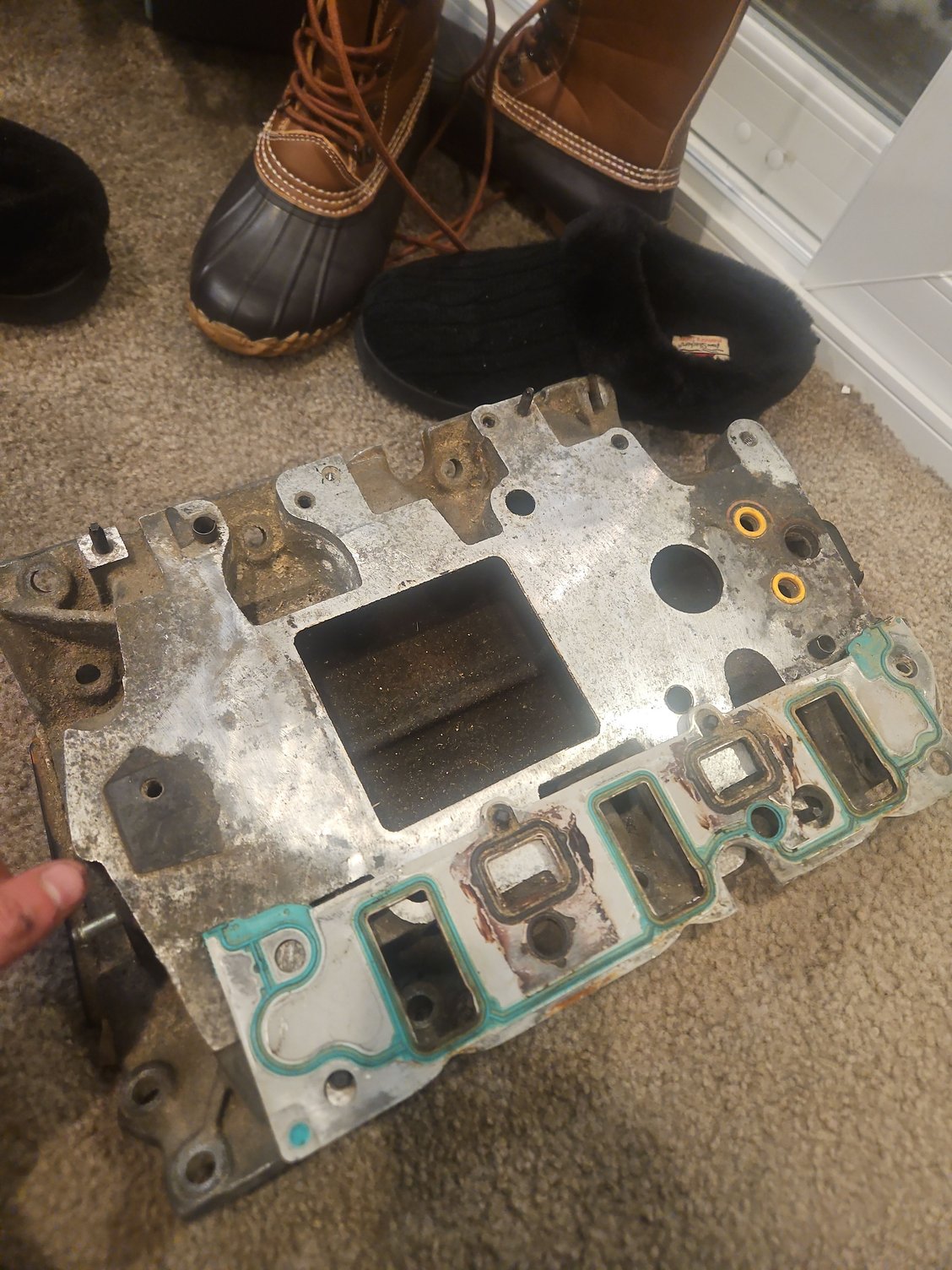

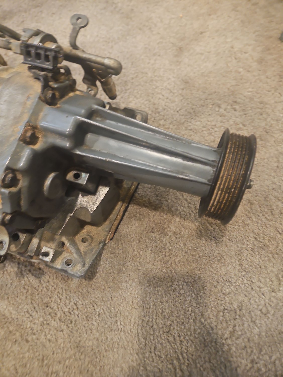

Hey everyone great news I just acquired the first piece for my top swap project on my 03 Monte Carlo, got this Gen 3 m90, LMI, fuel rails 36LB injectors, and TB all for 400$. Idk if that's a steal or not but the coupling for the pulley definitely needs to be replace as the pulley has some play side to side, besides that bearings feel great, gunna drain the oil, and flush it, clean it up a bit and start my search for a decent set of L67 heads, tensioner assembly, idler pulley, vacuumlines, etc. I know a gen v would be way better but for that price I feel like I could pass on it. Super excited to finally be making progress on this project and will keep posting updates on how it's going!

Not a steal, but its not awful - people have certainly paid a lot more from certain greedy chain junkyards. Injectors / TBs / rails can occasionally be found for free on the big 3800 groups from people upgrading.
I do think we're past the inflection point on falling prices due to age. Back when W bodies were plentiful in junkyards, a lot of people were pulling off top swaps all in under $500. Bang for the buck was unreal. Seems like parts these days are climbing back up quicker than via inflation alone, I presume due to lower supply - especially in some parts of the country. Its hard to find any w body cars anymore at my local yards - seems like theyre sending them to scrap metal / saving the lot space for newer stuff.
I wouldnt worry about it for a second. IMO the G5 benefits are way overhyped for a typical build. No doubt all of the top dyno records are set with them as they can be pushed a little further, but if its not a max effort build, the gains arent massive enough to be paying 2, 3, 4x like some people do. I think the price premium is far more indicative of how much rarer they were rather than for how much performance they add.
Keep in mind ZZP's 10.8 car was on a ported G3 (as was Morad's 11.0) , so it's not like they can't perform. You can certainly port yours if you want to claw back some of that delta. Even just a N* TB and inlet ported to match has proven solid gains without getting into all of the black magic complications of the outlet side.
