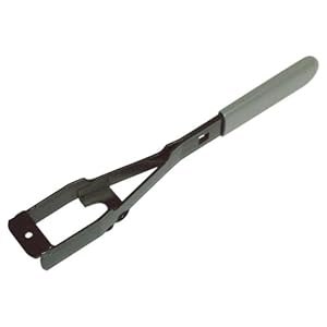

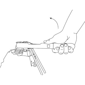

Old May 22, 2012 | 10:45 PM
this may help speed up tear down and reassembly Amazon.com: Lisle LI48500 Push Rod Remover: Automotive
