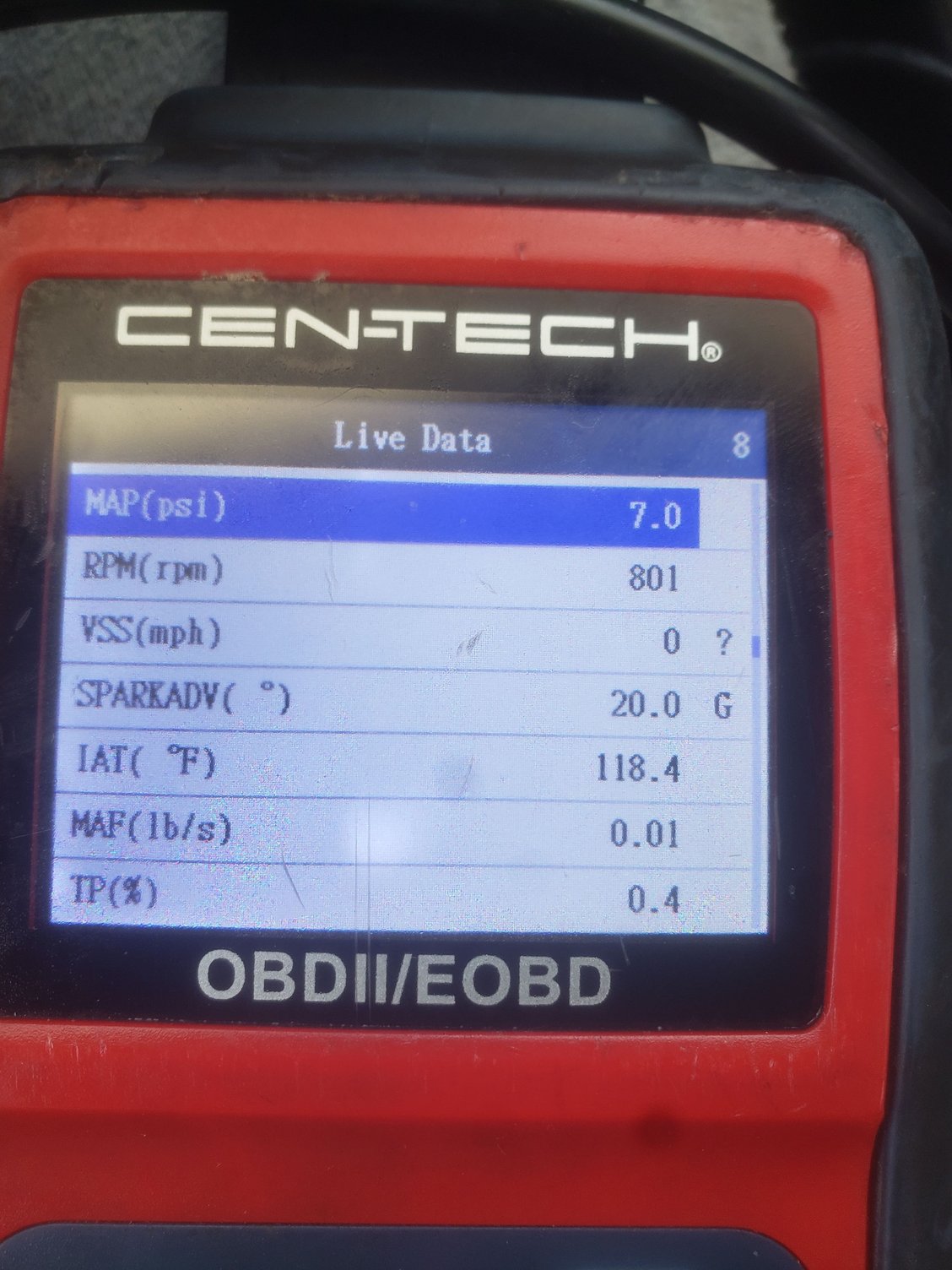

Finally gave in and took the car to meineke this is what I paid 75bucks for basically told me a pcm a maf sensor or map sensor
9 Pontiac Grand Prix.
https://motorist.autovitals.com/l/4bLiKi
O2 sensor
Throttle position sensor maf sensor
Fuel trims
at idle
So they told you it's one of those 3 things and to finish diagnosing yourself?
PCM is going to be tough if that's the culprit as you've paid for a tuned PCM. Would kinda suck to buy another and have to ship it back out to pay for tuning again. I wonder if they'd give you a discount due to the issue?

Basically they said the codes I had were p101 maf out of circuit 441 1441 404 1404 p1260 which I knew I had these codes the tech said buy a high performance maf sensor the front desk guy said get the pcm out of the donor car but basically I would have to take care of that first before further testing due to the light being on cel they said my fuel trims were off
Definitely wouldn't buy a 'high performance MAF'. OEM works just fine and the true 'performance upgrade' MAFs are external (to allow for higher flow especially when coupled with a larger TB) which would complicate your PCM tune issue as the tables will be totally different.
A bad pcm could be a possibility although certainly less likely than a bad sensor. As mentioned though, if it is proven bad, it would suck as youd basically lose the money for the tune unless they'd be willing to discount a do over on the same tune.
