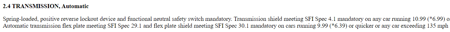

The 4t80e I got from the junkyard has an external electronic neutral safety switch. The 4t65e however, doesn't have a module like that. Where is the neutral safety switch for the 4t65e? is it an internal one, or is it located in the shifter/gear selector? All race class specifications I've read require one, and I'm trying to figure out if I need to wire that electronic switch in somehow or not.

I have a 4t65e outside a vehicle, and I dont see any electronic conectors even on that area of the transmission. Just to make sure I'm not confusing things, I'm talking about what locks you out of pushing the gear selector into reverse while driving.

Your talking about 2 separate things in this post. The neutral safety switch is part of the electronic connector on the transmission . The park lockout on the shifter is controlled by the key switch which is irrelevant when racing at a sanctioned racetrack
The 4t65e currently in my 2000 Monte doesn't have an electronic neutral safety switch on the outside of the transmission either. Also, I'm not sure if this information is up to date or credible, but heres a screenshot of the NHRA regulation I was refering to.

I certainly don't want to give you the wrong advice. I checked my 2002 and it was on the transmission where I described so guessing the update was done in 2001. You might want to message the "Maniac" for a wiring diagram.As As for the shifter lockout , the factory shifter already has a positive lock on it to move it into reverse so your good there. I'm wondering since your transmission doesn't already have it on the transmission you might get lucky and it's part of the shifter where you don't have to do anything. Wish I was more help.
