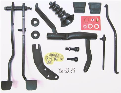

this will get you all the pedals and linkage, kind of pricey, but complete.http://www.accountwizard.com/clients...em&itemid=2852
Really depends on which trans you want to run, 4,5 or 6 speed?

78-88 Monte Carlo stick shift pedal & linkage kit
Your Price: $319.95

Thanks a lot guys, I'm thinking of going with the good ol 4 speed.
Old Sep 11, 2009 | 09:57 PM
sideways's Avatar
Posts: 126
From: Niles, Ohio
Well the 4 speed isn't to bad, Hardest part is finding the bellhousing and clutch fork. If you want to do a T5 with the mechanical linkage, you'll need the bell and fork from a 83-84 camaro/firebird. Or you can go with a hydraulic setup.
