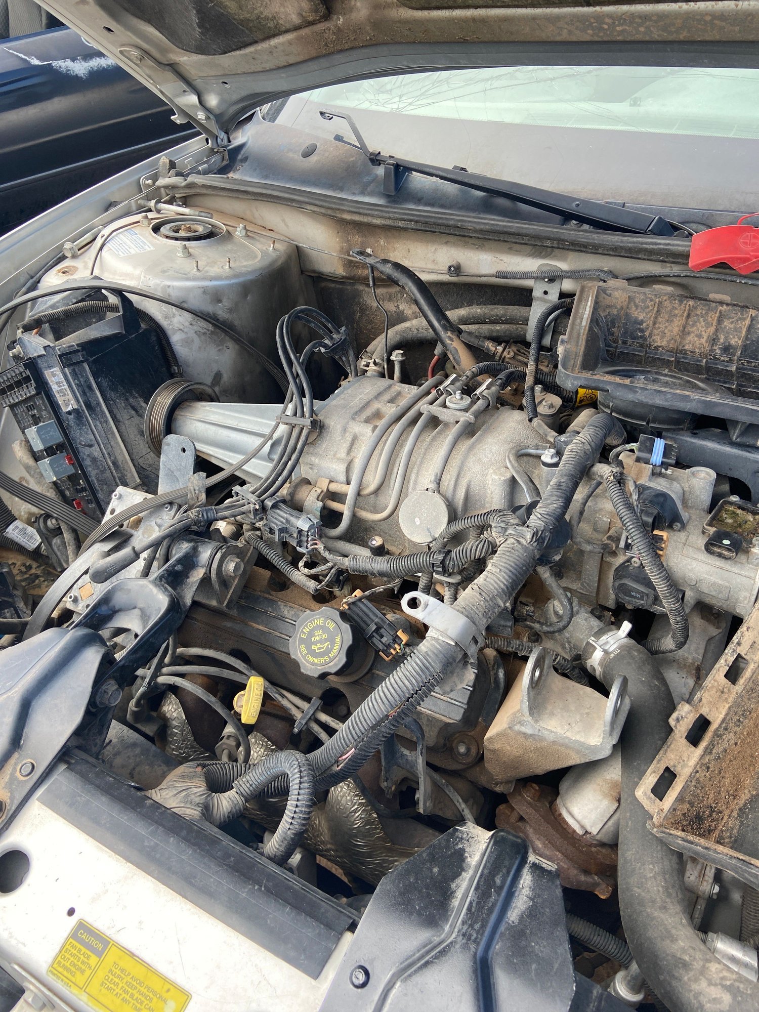

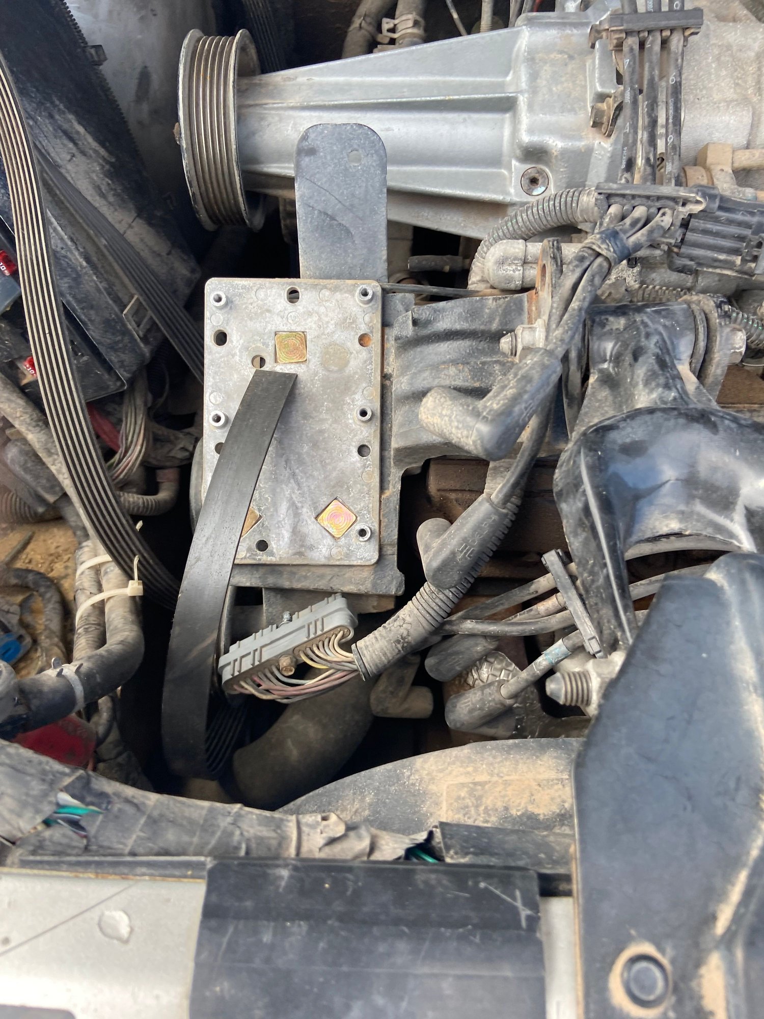

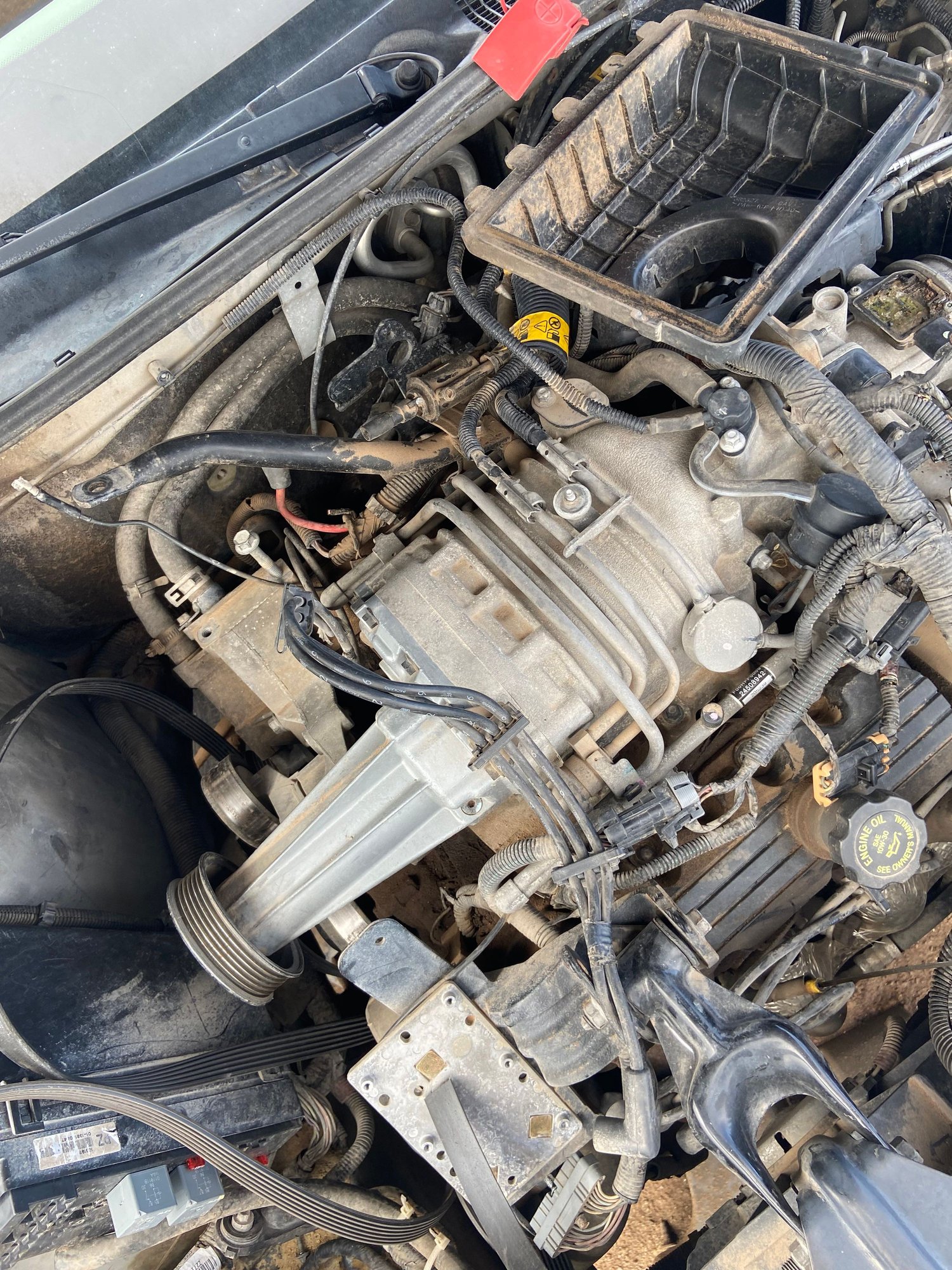

Took a quick trip to my junkyard and lo and behold...
Does this supercharger look in good condition? If so I can get to work gutting it pretty soon, wouldn't want someone else to take it. Also, picked up a manual from my library and it shows the disassembly of the supercharger in detail, so nice.
No way to tell from here. Any indication of mileage?
There's 3 things to look for in supercharger condition:
-Coupler condition. Theres a piece of plastic that connects the snout to the rotors which wears over time. Its not a big deal to replace (and frankly you probably should anyways along with a fluid change since you don't know the history), but you do need to check before you install it. When you turn the pulley back and forth, you'll feel a slight delay before engaging each direction if its worn out. Even if minor, replace it or it'll be bouncing back and forth rapidly when the engine is running and sound like a rock tumbler. Every m90 needs this sooner or later.
-Snout and case bearings. Spin the pulley forward rapidly and see how smoothly it turns. If it feels gritty/ has a lot of resistance- either crap is stuck in the rotors or the bearings are dragging. Its not real common even on 200k+ cars, but it does happen if the bearings dry out. Its not awful to replace, but m90s are cheap enough that its borderline not worth the effort - especially since most are ok for this issue.
-Rotor wear. This is the big one. You'll have to pull the blower for this and look up from the outlet inside of it. None are perfect, but you shouldn't be missing big chunks of coating or have significant grooves in the rotor edge or blower case. While technically fixable if bad, no m90 is worth having that done. It will be black and sooty- thats ok (and don't clean it off either).
That is a pretty complete junkyard engine. To Maniac's point, does it make more sense to grab the whole thing rather than being charged for each nut and bolt taking 70% of it? Not sure what their pricing is like, but Ive seen junkyards where the whole engine is say $500 but ringing up each piece individually would come out to easily double that.
