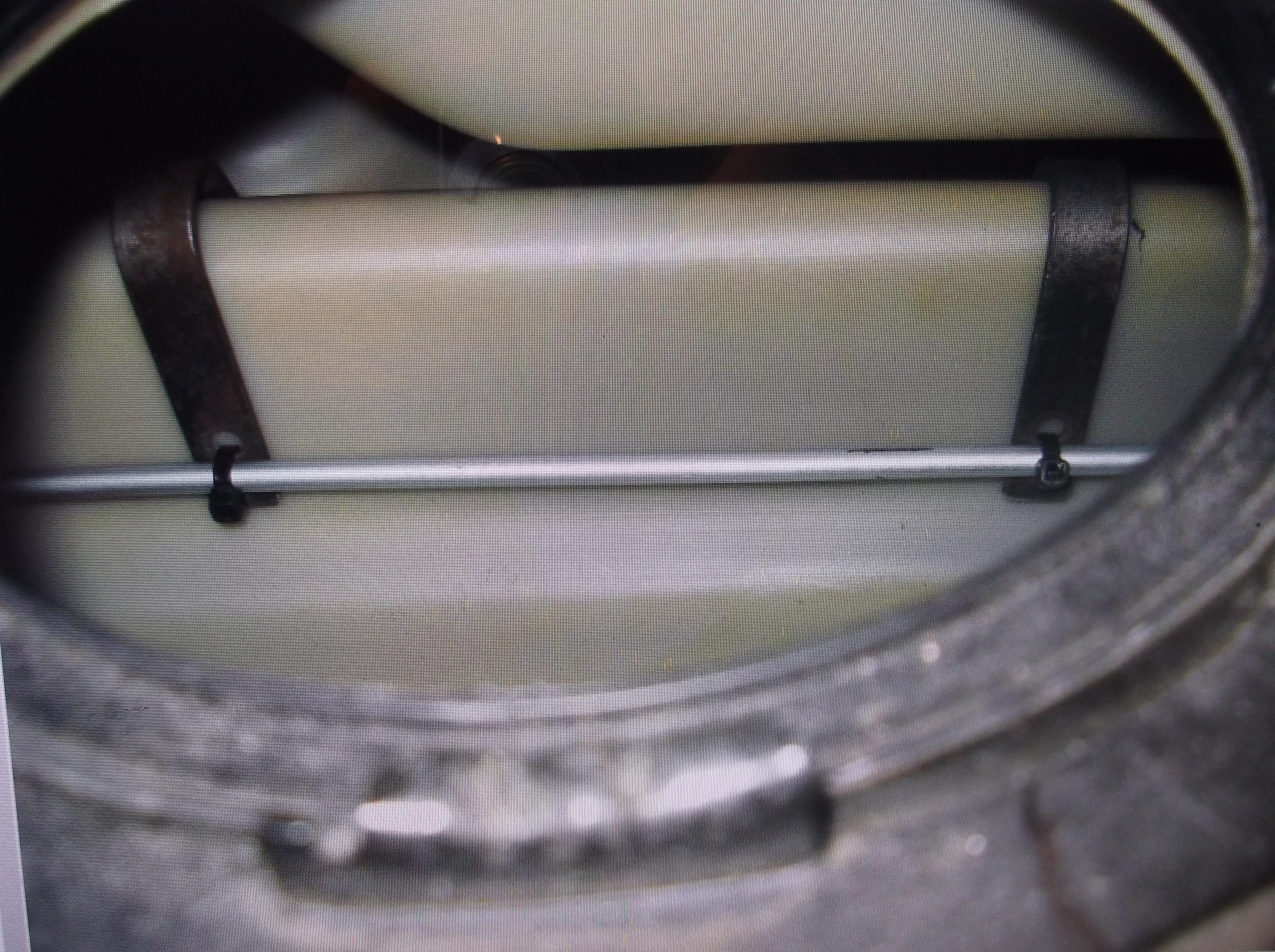

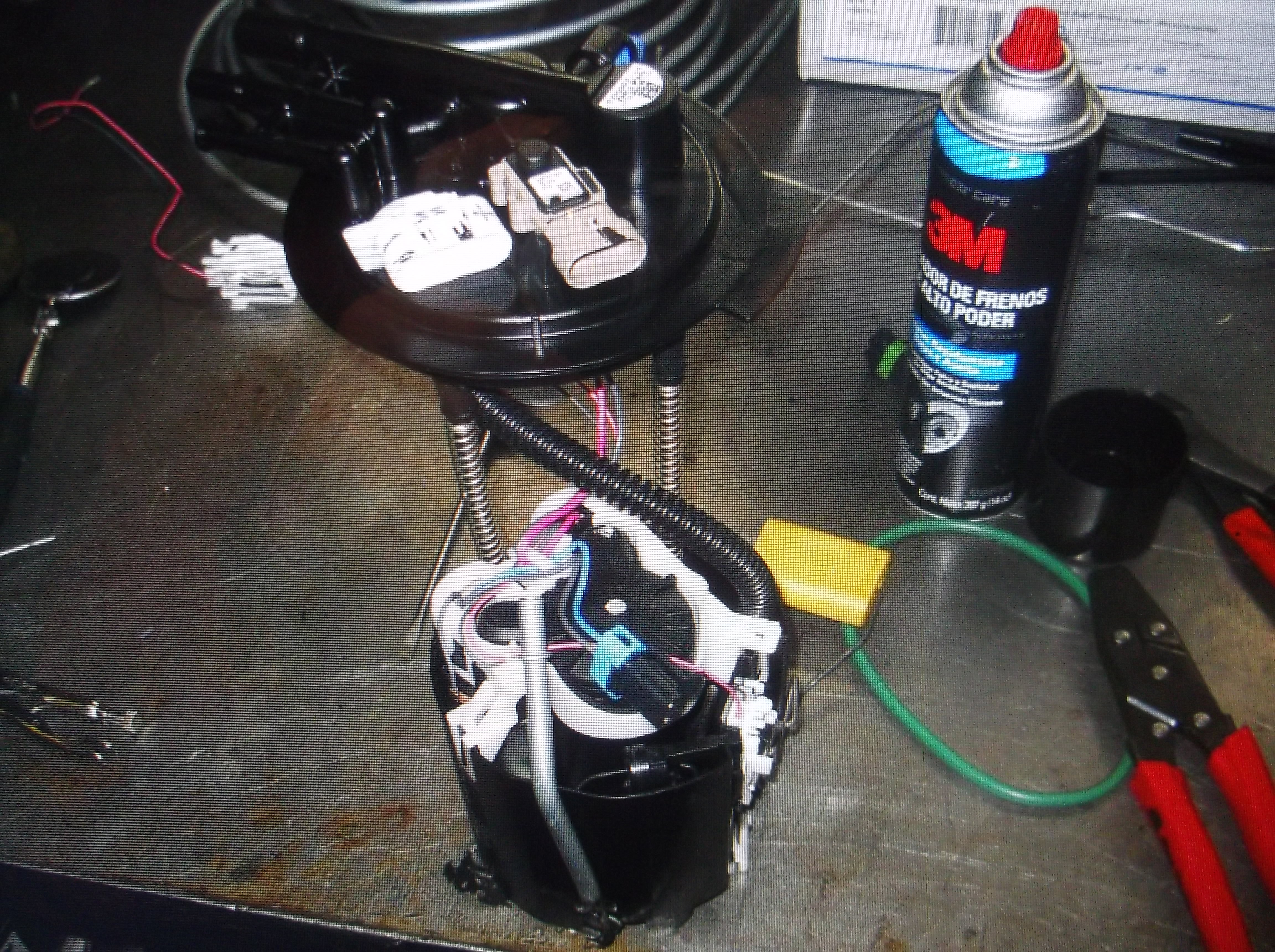

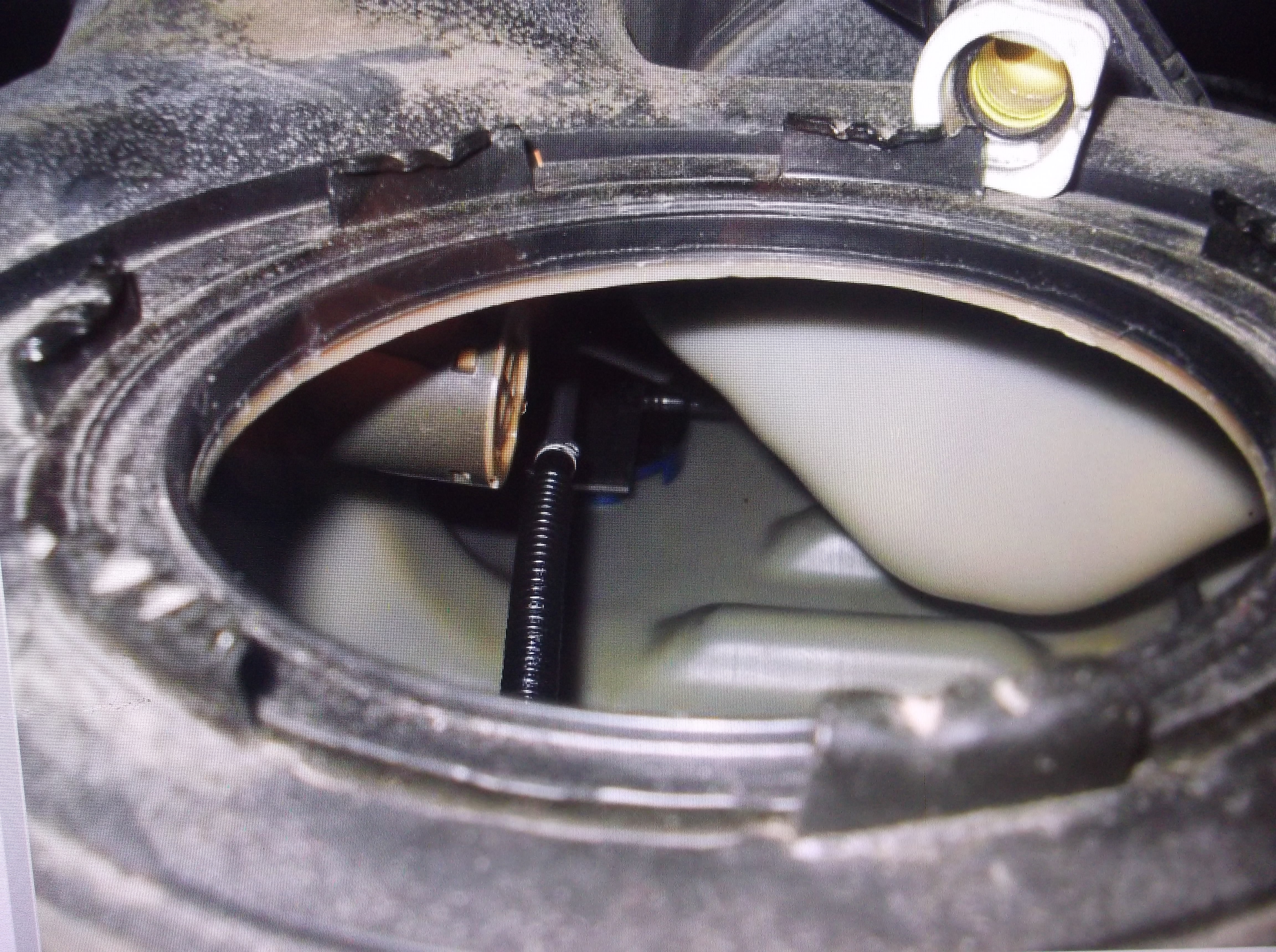

Currently the fuel pump and fuel lines are happening. Utilizing the CTS-V pump (which is actually 2 pumps in 1, cool) took some figuring out. The caddy's pump top end had to be modified so it would bolt into place on the Montes gas tanks OEM location. My previous tank was modified to have the fuel outlet at the lower rear of the tank and the aftermarket Aeromotive and Weldon pumps were either mounted on the frame or submerged in the tank . Yet both continually were overheating. So our solution was to get a new Monte fuel tank and use the OEM pump mounts and a GM performance designed fuel pump. Hopefully there will ne longer be any "hot" fuel issues.
I wanted to redo the fuel lines too while we were this far into the fuel system. We added all new stainless braided PTFE fuel lines since my other aftermarket lines were over 8 years old and subject to their inner line decomposing and potentially plugging the injectors. We are routing the new lines to follow as closely as possible the OEM configuration.
Here are a few pictures of the modded CTS-V pump. Also is a small description of the work performed on the fuel pump modding process.
The fuel line sensor assembly that you took a photo of is: fuel pressure sensor for the Vapor works controller (Holley has a separate pressure sensor up on the fuel rail) and fuel temp sensor for the Holley digital display. I have attached the photos of inside the tank, they are named appropriately as to what they are. The fuel pump has been modded to fit inside the tank: I used a fuel pump top from a 2006 Monte, modified the stock CTS-V siphon pick up to make it close to the pump body, installed Walbro cornering pick-ups to keep the fuel sender full during low fuel level cornering and ran the second CTS-V pump wiring through the side of a stock 06 Monte tank. The fuel pump assembly must be assembled inside the tank, the mod siphon pick has to be installed on the CTS-V pump and zip tied in place while already in the tank. Then the second pump wiring connected. Then the in tank cornering pick up plumbing connected to the siphon pick up tube. Lots of fun!
