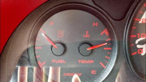

Okay so ive tried everything! Im 100% confident that there are no air pockets in the system. The car consistently runs between 210-220 while driving. (fans always on chibi) As soon as i park and let it run for 3-4-5 min the temp is back down to 195 ish.
Every time i pull the rad cap off to check the level, i need to add like 8 ounces... I have no leaks that i can find. everything id dry under the car. I dont see the overflow bottle getting fuller. Where is the coolant going? I replaced the head gaskets 200 miles ago so i would hope the air isnt passing into the cooling sys from the cylinders...
Im at a loss... help?
This is what my scan gauge calls 217 degrees. look about right? (pic)
