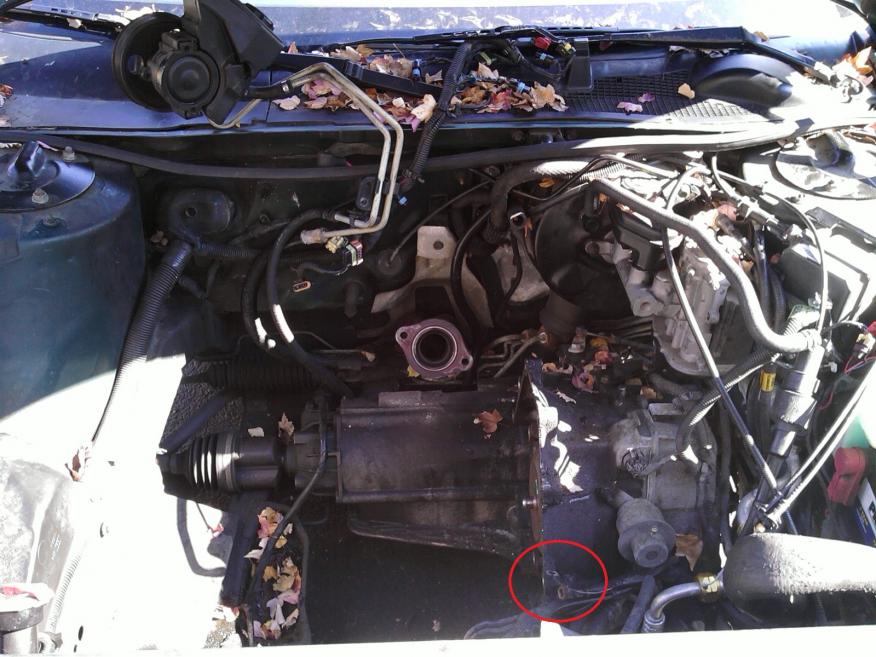

I recently swapped an engine in a 97 monte carlo and lost the ground to the wipers, abs and cruise. These all go into the same wiring harness so I assume they ground at the same point. Does anyone know where this harness grounds out?

according to the FSM the ground for that says "G117 Lower LH front of engine, on transaxle stud" on the otherside of the starter i believe and heres a pic. hope that's the right one.
