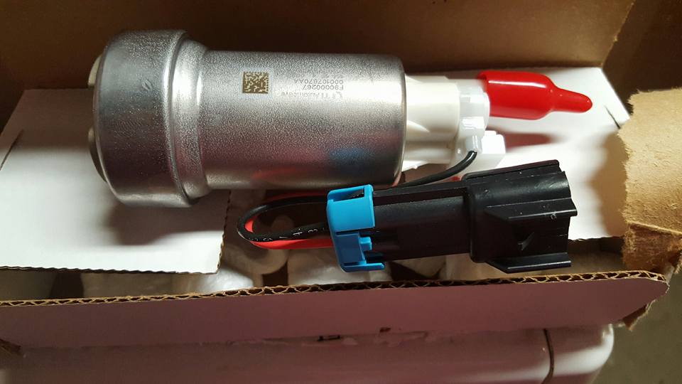

i have found a post about doing this and it has step by step instructions of how to do so. i have followed them instructions and now have a walbro 485 pump stuffed into my bucket inside my tank. no more fuel starvation for me i will post the link i followed below for others to view. keep in mind you can not use this fuel pump with a factory fuel regulator!!!
Biggest baddest fuel pump in a stock canister
^^LINK^^
any questions about this upgrade feel free to ask!!!
