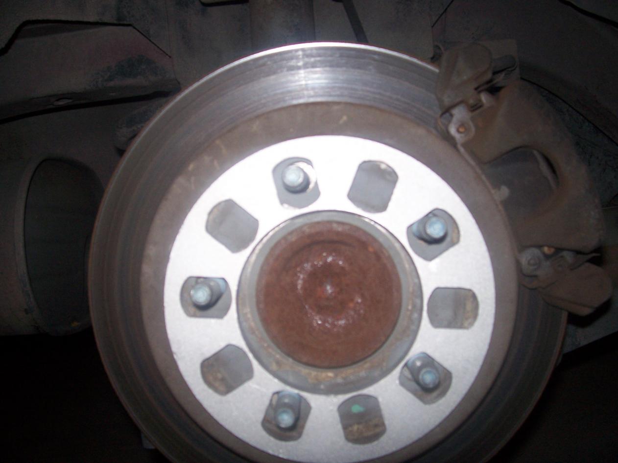

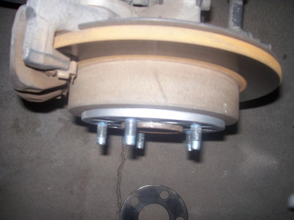

So I bought some 5/16 (8mm aprox) spacers, and i got a hold of some steel 5 lug spacers 1/8th (3mm aprx) off the the junk yard.
With out any spacers the lug nuts after being torqued is flush with the lug bolt. after installing the 8mm spacer i noticed that it didn't turn as many threads as original 8 1/2 turns torqued. with the spacer the lug nut would only turn 3 1/4 turn, risky. So i try out the 3mm steel spacer and the lugnut turned 5 1/2 turns.
I decided that this was safer than my first attemps with the 8mm spacer.
I noticed the lug bolt, i think are the originals, dont have the treads to the full length of the bolt they stop at about a quarter of and inch before.
I may use the 8mm spacers if i can get a hold of longer and reinforced lug bolts.
but 20mm or 25mm spacers would look really nice i think, more flush

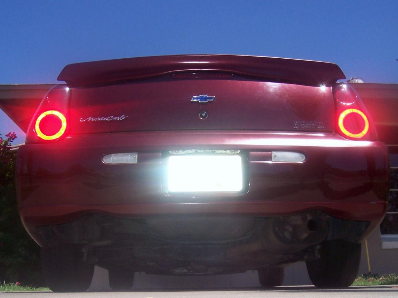

I hope this is what you where looking for. let me know.

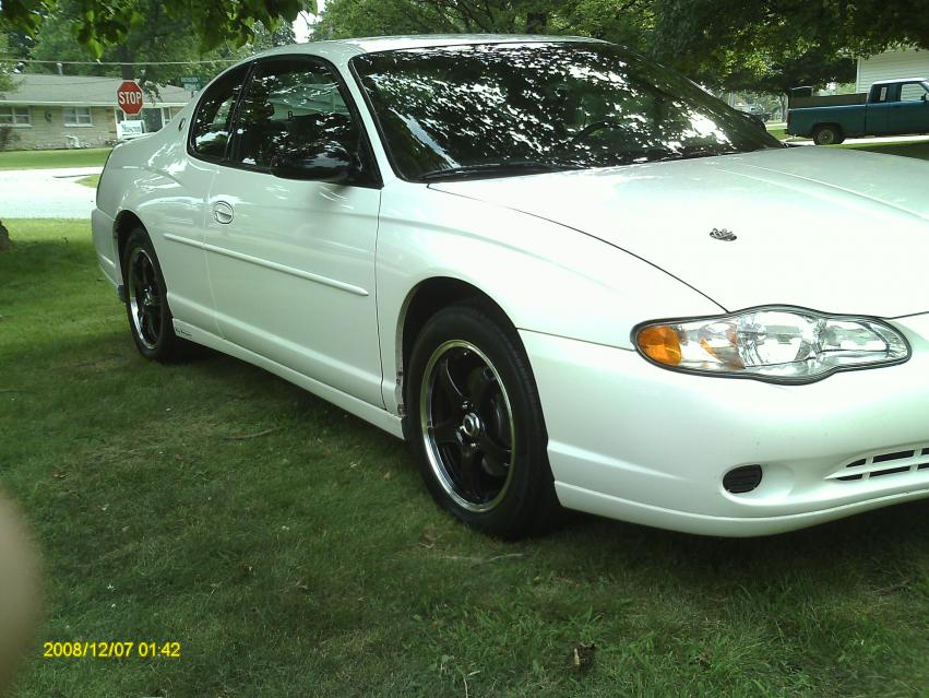

yeah that rear veiw is better, but could you post a pic like in this angle>> Please and thank you much
I dont wanna bother you with it, I just wanna see it before I go and do it you know?
