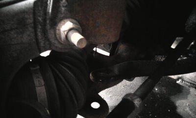

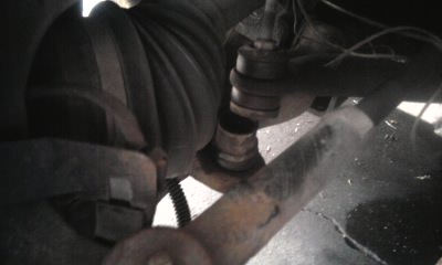

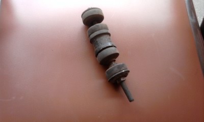

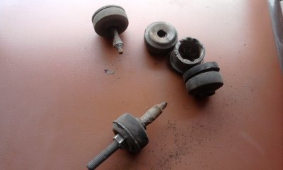

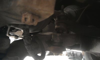

Samehere! Here is some photos of what I have done on mine. Hope it helps!!!!!!!!!

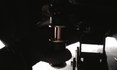

More Photos
