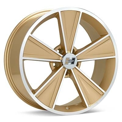

These wheels are beautiful, but can't find any info on offset. Tirerack says will not fit on 7th gen.. .
They come in gold too

I LOVE Hurst wheels but they are sooooo expensive. I don't think they make the offset to fit the Montes - depending on the wheel, they make rims to fit the newer Challengers, Mustangs and Camaros.

If they fit Camaro, you could get an adaptor, kendrels7 put Camaro rims on. I'm not a big fan of adaptors though, adding another potential failure point.

I know of some people being able to fit newer Mustang rims on their Montes - Bullitts seem to be popular for the Montes. But I don't know if they used spacers or not - I'm not a fan of spacers or adapters either.

The 6th gens could put Bullit wheels on, there was no spacer required. A lot of wheels came in 114.3 X 5 instead of the 115 X 5. Hubcentric rings helped but weren't necessary. I don't know the bolt pattern of the 7th gens though.

If it fits a chrysler 300 it should fit a monte. mikes 300 wheels are 20x9 and fit his monte.

They will fit but they will stick out, largest offset i found was 32mm & the monte needs a 40- 42mm on a 20x8.5 if they made a set for the awd chrysler lx cars they would be perfect, right offset & 5x115 bolt pattern

Yep, you'd need to drop down to a 17" rim in order to get 45mm offset.

I like them in gold, that is really a beautiful wheel.

I'm pretty sure that I have seen a 7th gen with Bullitts. Not sure if he had spacers or not but it will fit the 6th gen for sure. I believe the hubcentric rings were for eliminating vibrations. I got lucky and have no vibrations with mine.
