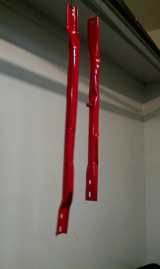

i am painting the diagonal bars in the engine bay and have a simple quesions.
i sanded them some then did 2 coats of spray paint, i have a couple drip spots. before i do another coat can or do i sand them down some more to get rid of the drips? or do i have to live with it??????????

You can sand them down. Then put on another good coat, but go a little lighter on this one

Yeah you can sand the runs down. The trick is to take your time painting
then you wont get drips/runs..

I'm assuming you're doing this with cans of touch up spray paint, or similar? Just move the can a little further away from what you're spraying and make sure you're pushing the nozzle down all the way just before you actually put paint on the metal. Makes it look nicer - it won't look so heavy and thick in spots and light in the others, and you won't get drips.
Yes, sand down your rough spots and then lightly re-sand the whole bar before doing your next coat.
