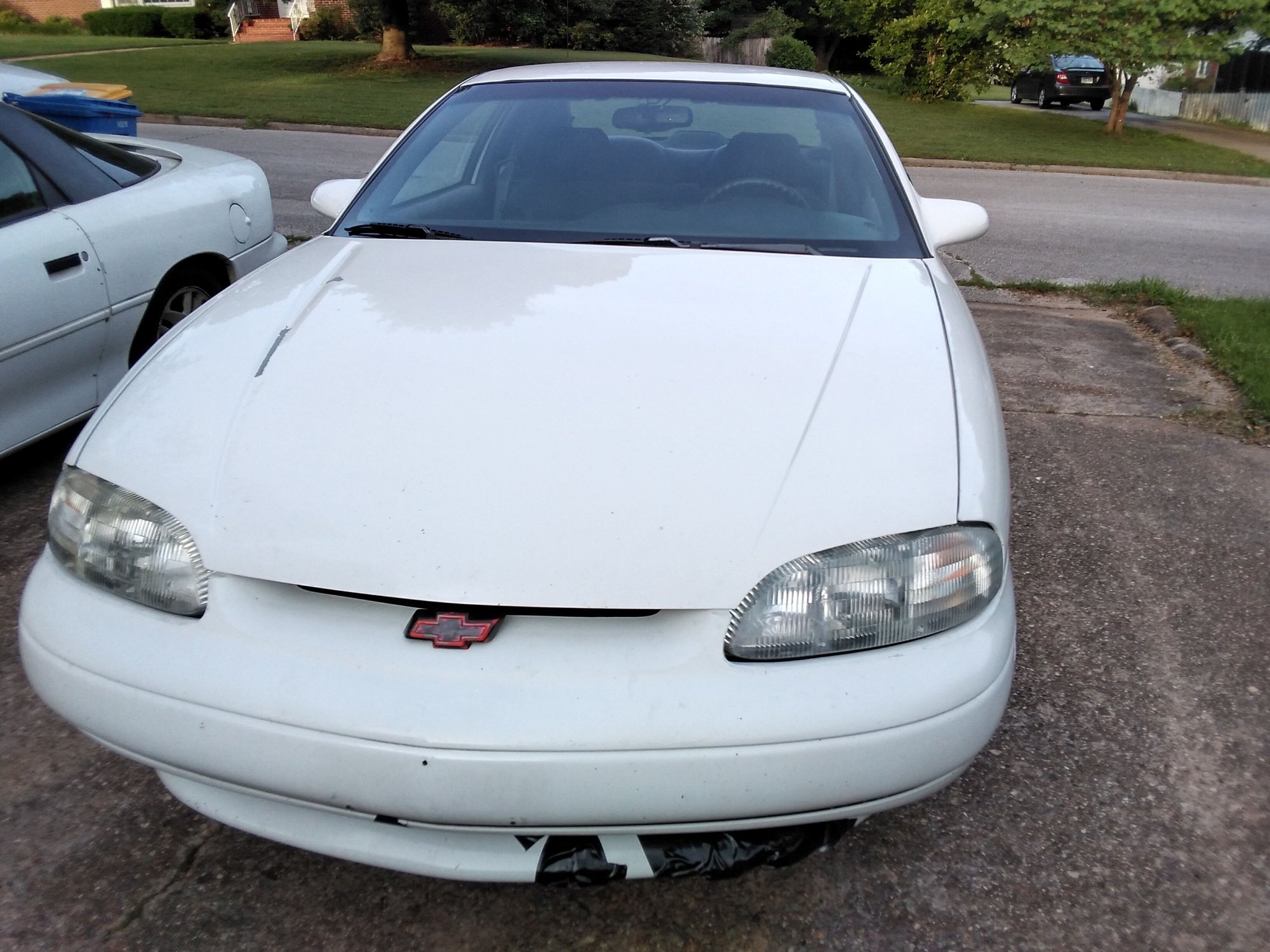

This is the car in question. She's a '95 Monte Carlo, likely built in '94 (earliest records in the user manual are from Q1 '95). She's a Z34 trim with the twin cam, and with a standard cloth interior with power driver seat/manual passenger and no sunroof. Not really out of the ordinary. She's my first car.

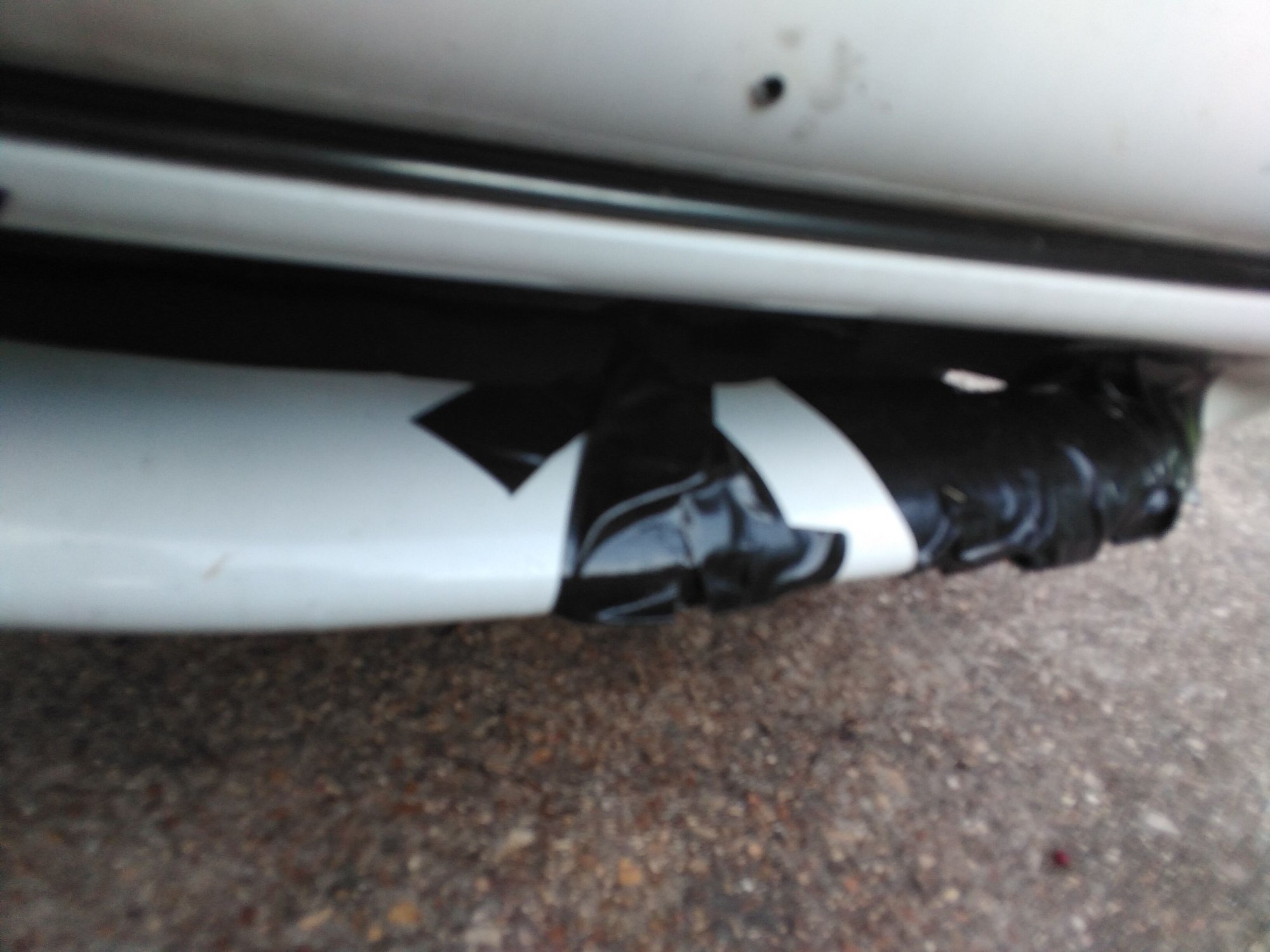

The front bumper was damaged when we bought it, specifically the air dam. Originally, some clear packing tape was used to keep in in place, but that gave up after several moths, so a lot of gorilla tape is now being used to hold it together. Additionally, the two supports that are supposed to hold the air dam up broke, as they do on all Z34s, probably why it broke in the first place. Additionally, this car was bought from an owner in Missouri, so it has the ugly holes for the front license plate. Though to be fair, it would have that anyway, dealerships like to get paid to put a buncha advertising on customer's cars, after all!

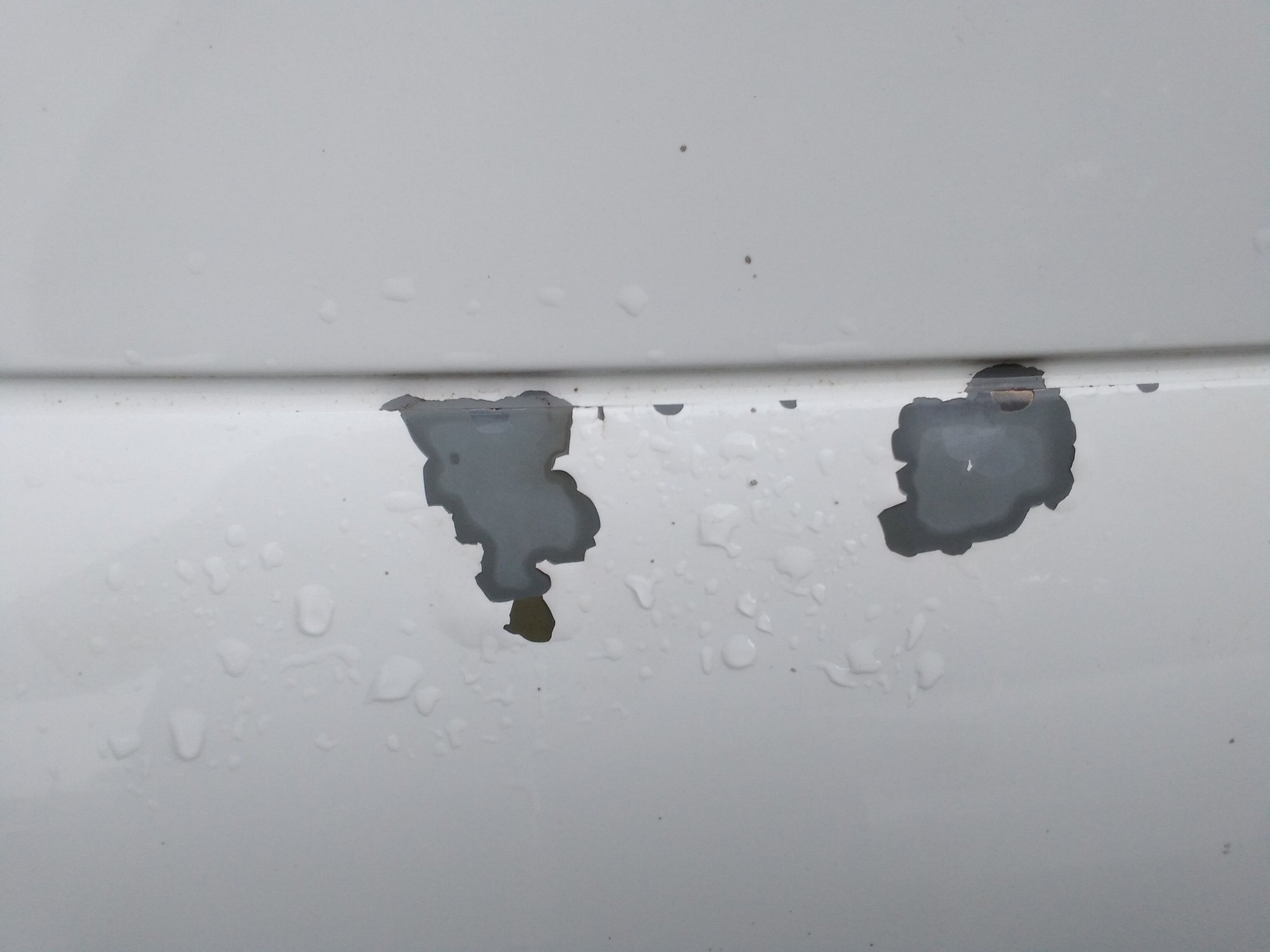

The quarter panels are starting to rust. The passenger side is very bad, but from what I can tell, the driver side is just starting. There's some light rust on the quarter windows as well.

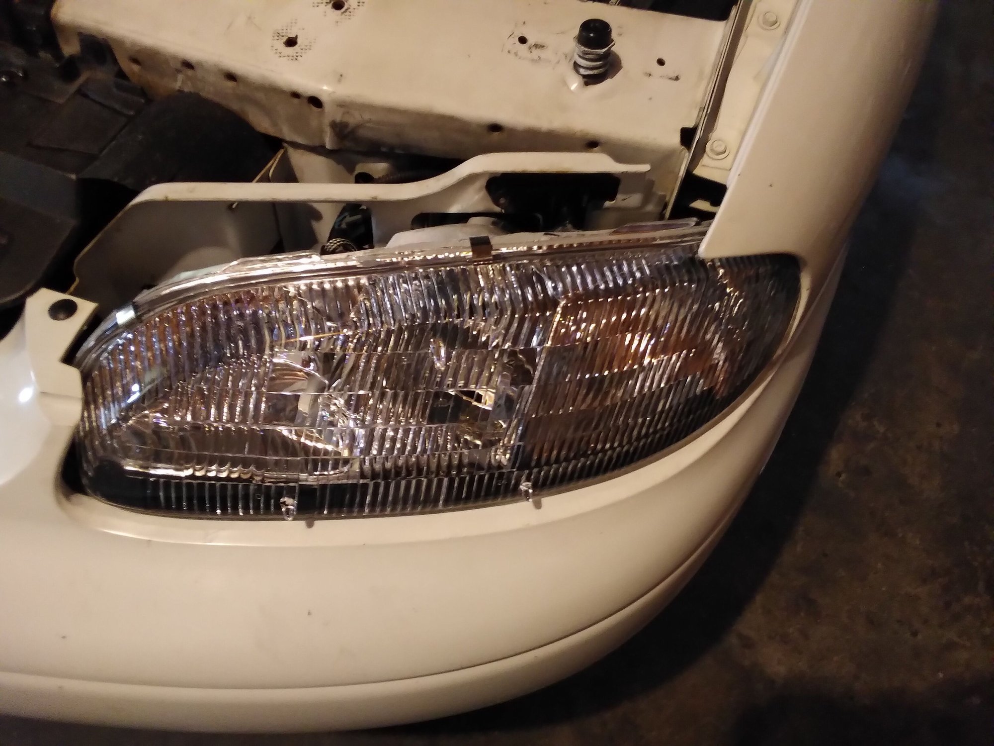

Brand new headlight housings! Actually put these on a week ago, but just now got to starting the thread. These are OEM style EagleEyes. I was going to go with some black-backs, but then I realized that the backs of those housings was made of a different, cheaper plastic.
