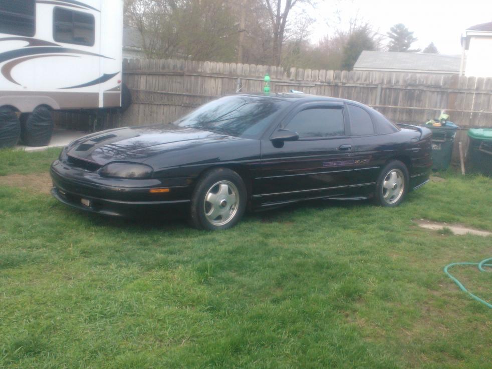

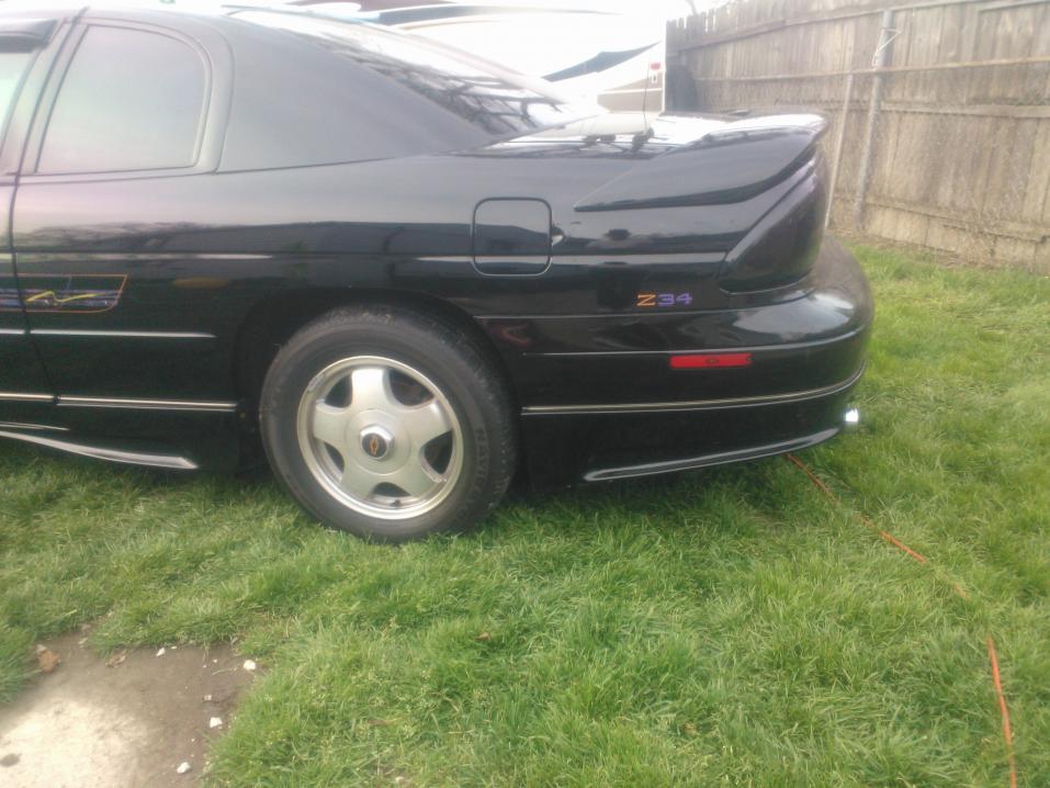

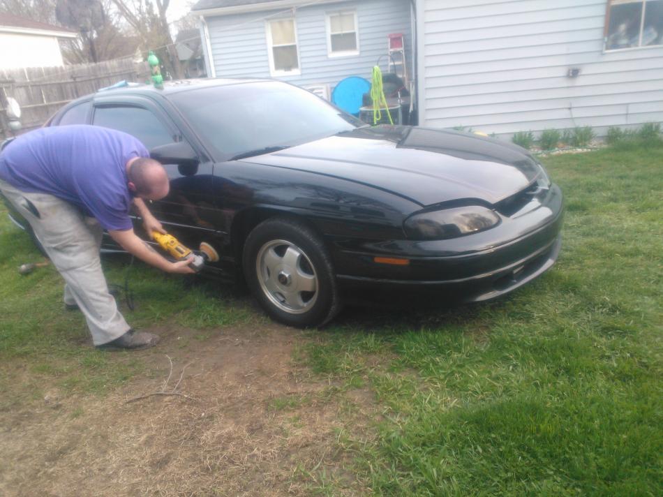

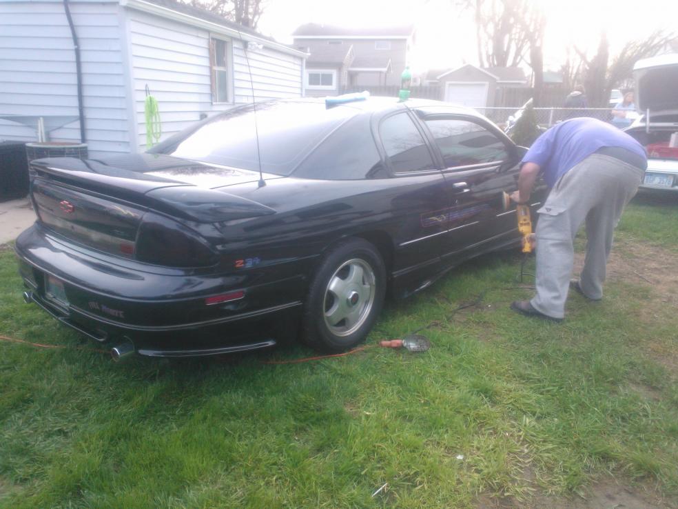

Heres some pics of my step son hard at work on the Monte after finally feathering in the rust repair...Also rubbing out the Paint to make it all match!
Along with a better pic of the actual repair !

Wow it looks much better! What did he do to repair it?

he ground the rust to bare metal,
Used etch primer over that to seal it. Sanded it smooth.
Then filled it with plastic filler. Wet sanded it,
Then used paint adhering primer.. Wet sanded it,
Then shot the color,wet sanded it, shot the clear on it. Wet sanded it,feathered it in, and wheeled it out,compound,polished it and then sealed it with wax.
Did it in like 5hrs in the backyard outdoors.
Then wheeled out the rest of the Monte to make it match!

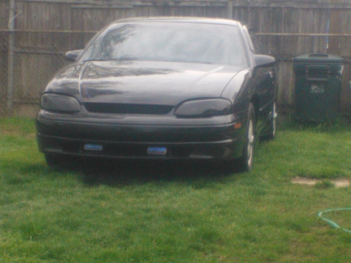

I couldnt deceide if I liked it without a Grille period...
So, How does this Look? and pls be Honest!
What I did (even though it hard to tell) Not the best Pic.. I will try to get a better one when it stops raining.
I painted the Grille Black and then clear coated it...

Thanks I really appreciate your honesty!

I honestly can't even tell there is a grill there It blends into the black to well. In which case, I approve
