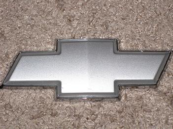

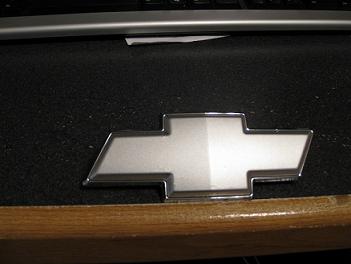

Managed to get the clear plastic piece (which wasnt exactly clear... had a definite gold tint to it) off using a thin piece of metal (an electrical contact cleaning tool) and a heat gun to warm it up all over. Be careful with a heat gun if anyone else is gonna try it cause i warmed mine up a bit too much through the hole in the back and got a little heat damage on the clear plastic.
I put the first coat of silver paint on tonight and got some pics.
Attached Thumbnails Painting my bowties-silver-bowtie-first-coat.jpg   Painting my bowties-silver-bowtie-first-coat-back.jpg   Painting my bowties-silver-bowtie-first-coat-2-.jpg

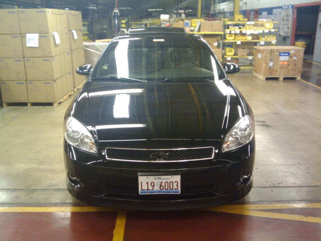

when i did my taillights with niteshades i decided to get rid of that gaudy gold crap and gloss black them too ...
well i got em off with a heat gun and a plastic spatula, the pain in the as$ part was getting all the adhesive off the trunk, well i get impatient and snapped one of them, so i only replaced the front, and after the taillights were done, i have to say i rather like not having the rear one on the car anyways, cleans it up

jester ... take the thing apart ... peel the silvery backing off with some duct tape ... works really well somehow ... sand it a bit and paint it with a glossy 2 dollar rattle can from walmart ... put the bowtie back together and get some double sided automotive quality tape and youre done ...
took me about 1 hour to do ... the hardest part is getting the damn things off without breaking them ... which i learned how not to do for the future after hulk ripping one off and cracking it in half ...

I had started out just painting the backs... but after it dried it still looked gold. I guess the plastic part had taken on a gold tint so i just painted the whole thing.
Gonna sand out a rough spot in mine and put a clear coat on it and see how it looks.
