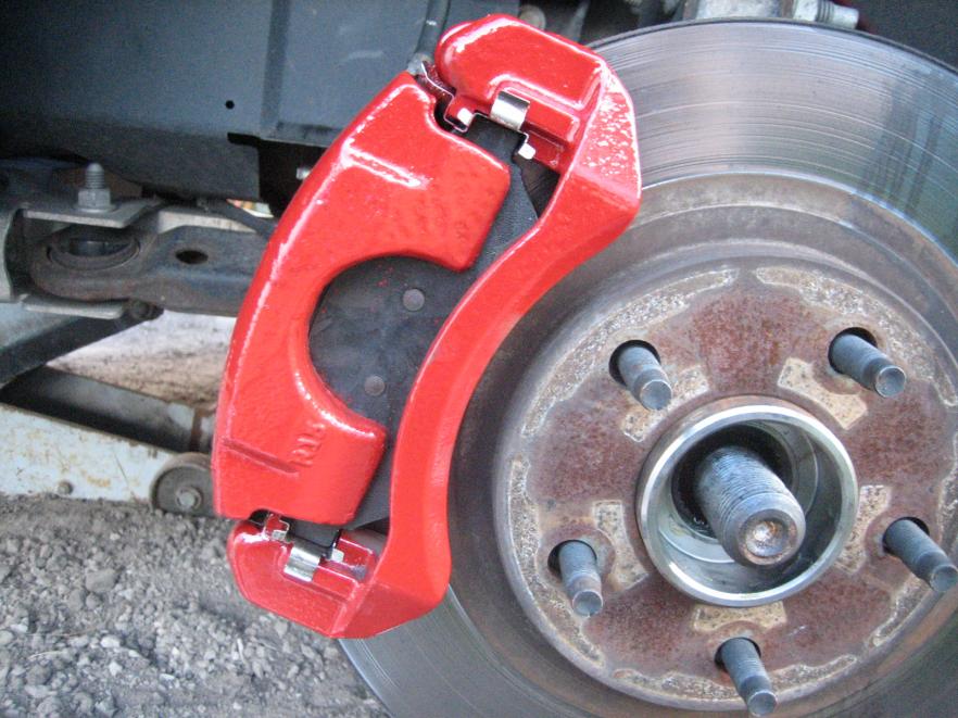

I used that kit in the summer. PREP WORK is key on these. You will NEED NEED NEED a drill with a wire brush attachment. Take your time and just work on cleaning them up first. I jacked up my car and took all 4 wheels off and just went all around with the drill. Probably took me 2 hours just to get everything as clean as I wanted them to be.
Then you spray it all down with the included brake cleaner.
Then you do the mix and start painting. There is PLENTY of paint to do all 4 with like 3 coats of paint. I still have a bunch left over. The first coat WILL look pretty crappy, don't worry about that. The second coat will even it out and then it will dry really nicely.
Let it dry at least 24 hours before you drive. I have a tiny bit of bubbling because I missed a few spots with the wire wheel I think.
Here's how they looked a few months later. A little dusty (and my phone flash makes it look orange) but they held up pretty nice.

Black or Silver calipers look kinda plain IMO. I like to see a bright color on them. That kit is what a lot of members have used. I used Dupli-color caliper paint in a spray can. It worked good but you have to tape everything off to avoid over spray. The prep is the most important step like Mike said, so take your time and the finished product will look great. Post some pics when you finish.
